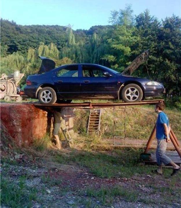

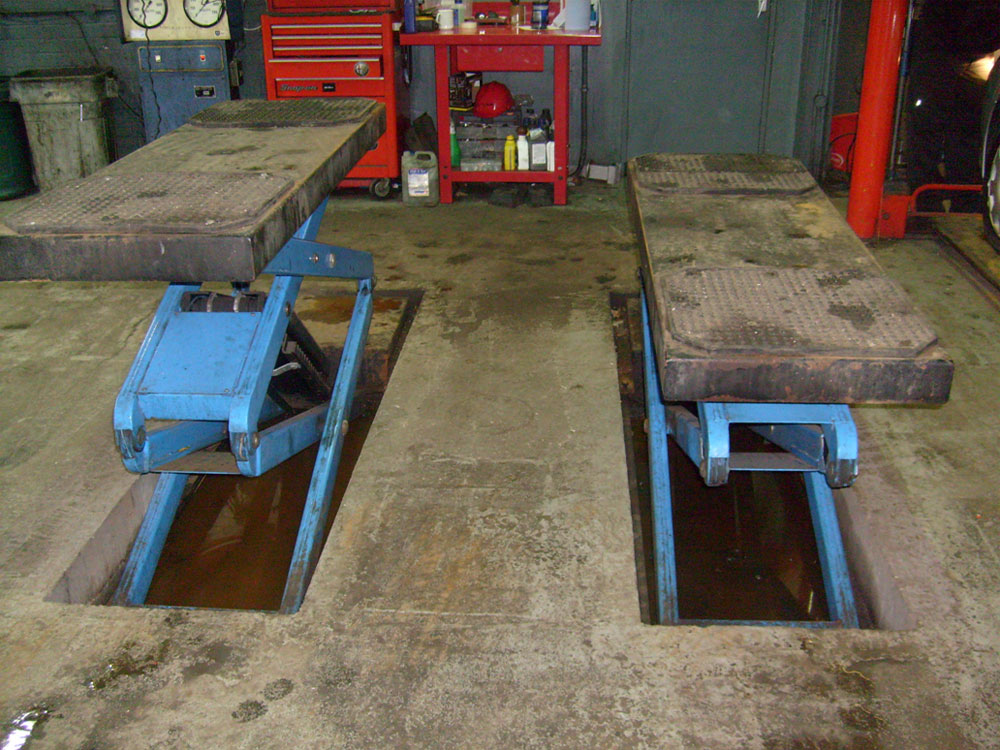

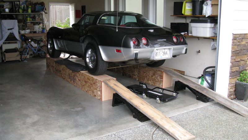

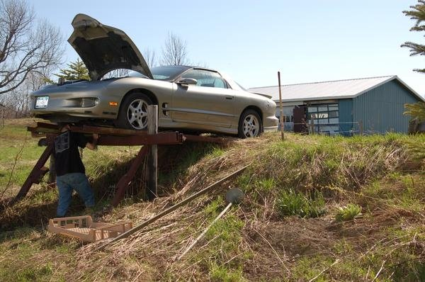

This:
or this:
Probably not this:
or this:
How about a ramp like many car dealers use to display cars, especially 4x4's?

I LIKE those two!
I've a steep slope like the first pic next to one of my workshops. I could build a strong drive on 2 ramp "covered pier" and work standing up.
The concept is good, but I wasn't impressed with what I could see of the construction. I've been thinking of something like that using two H beams for rails. Maybe one adjustable for width.
Bruce
