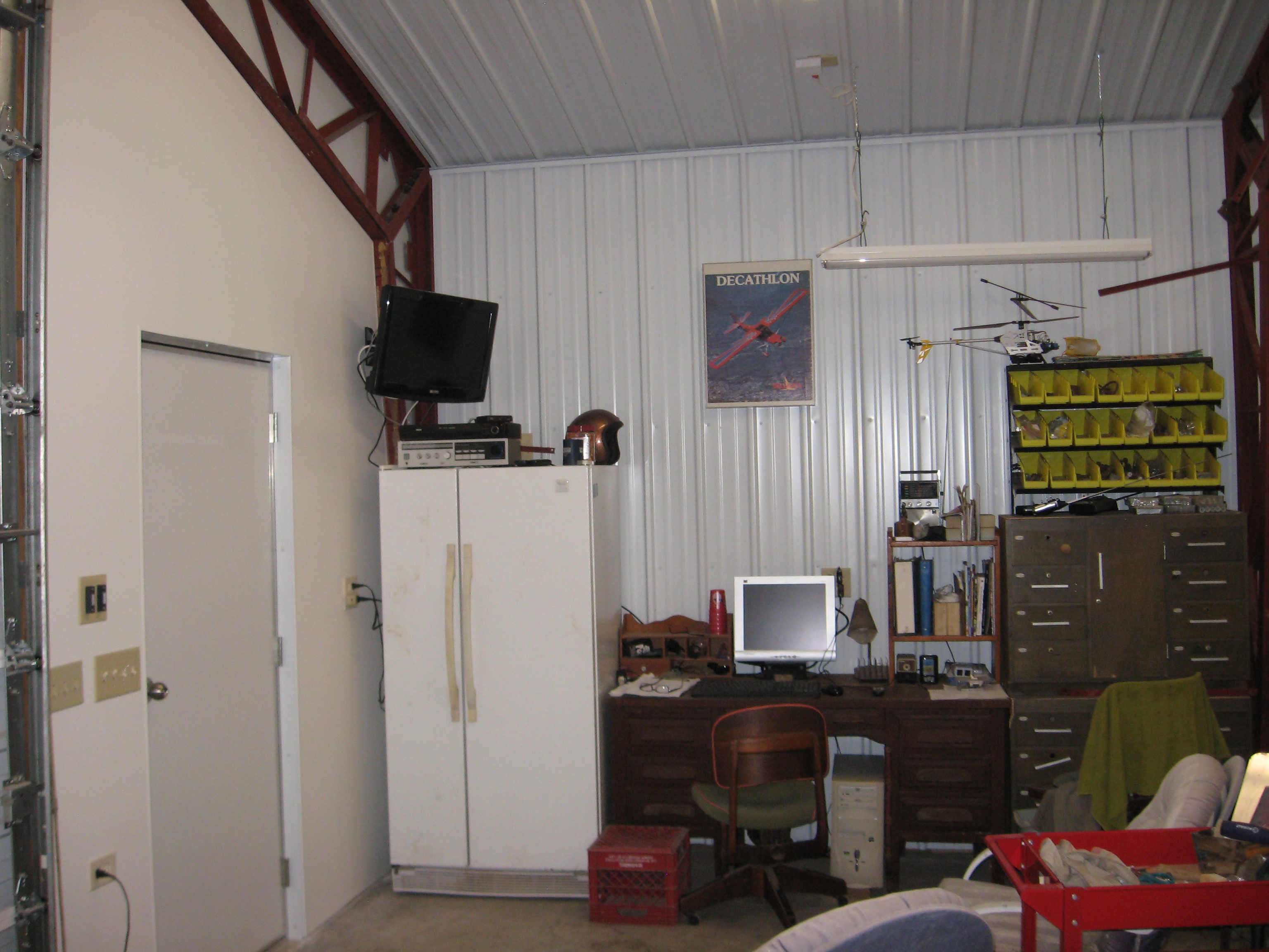

Sounds good. I like the look of steel panels for a shop. I lined the walls and ceiling of my shop with white steel for the long sides and gyp. board on the short sides.

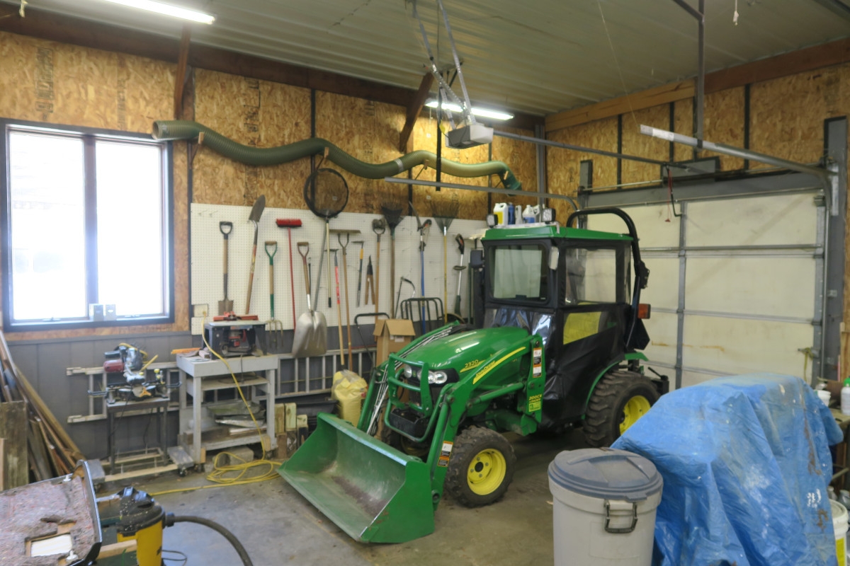

My shop isn't nearly as nice as yours, so I went cheap but it works well. I had some salvaged T-11 paneling I used for wainscoting and put up OSB above it. I didn't paint it because benches and shelves cover most of it and with a white ceiling, the light is good.
I have 2 neighbors that have the white metal walls and ceiling in their shops and I like it. It is well lit and seems quite durable.
