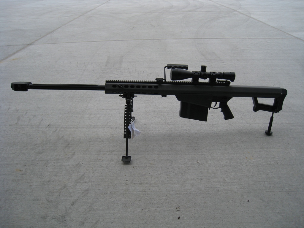

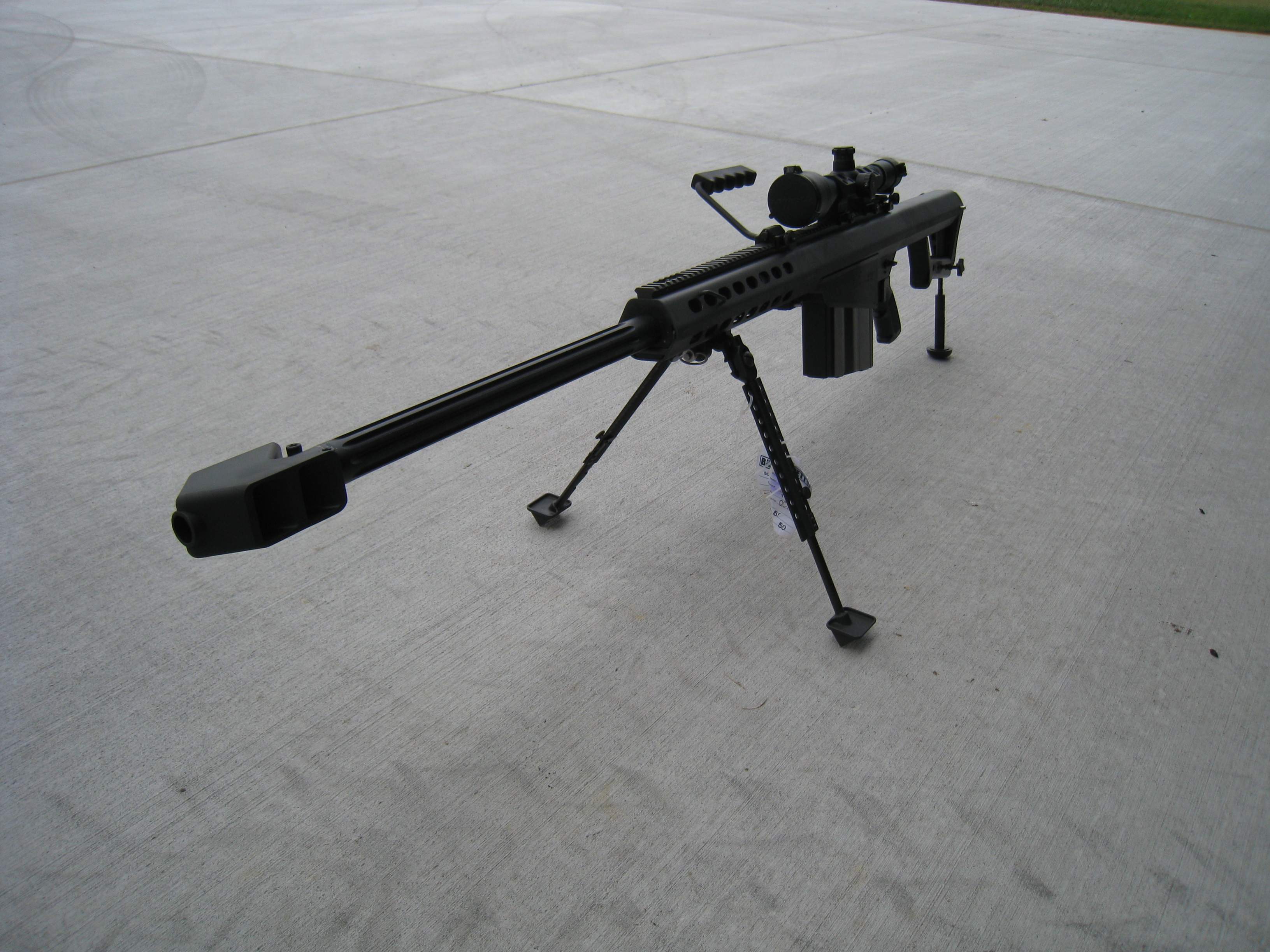

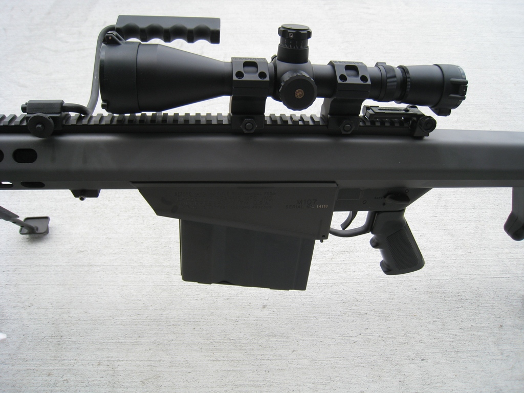

Funny, I have 3 rifles that shoot .50 BMG ammo. Hundreds of rounds of surplus ammo has caused exactly zero damage. I guess you've never had any of the level of armor plating I have. If it were getting hit with armor piercing rounds via a right angle at the same spot you'd get through. At a 45 degree angle, knocking the bullets down into the sand, the .50 BMG would likely take tens of thousands of rounds to hurt it. I know for a fact that hundreds of rounds have just scratched it. Here is a Barrett M107 the day I brought it home.
