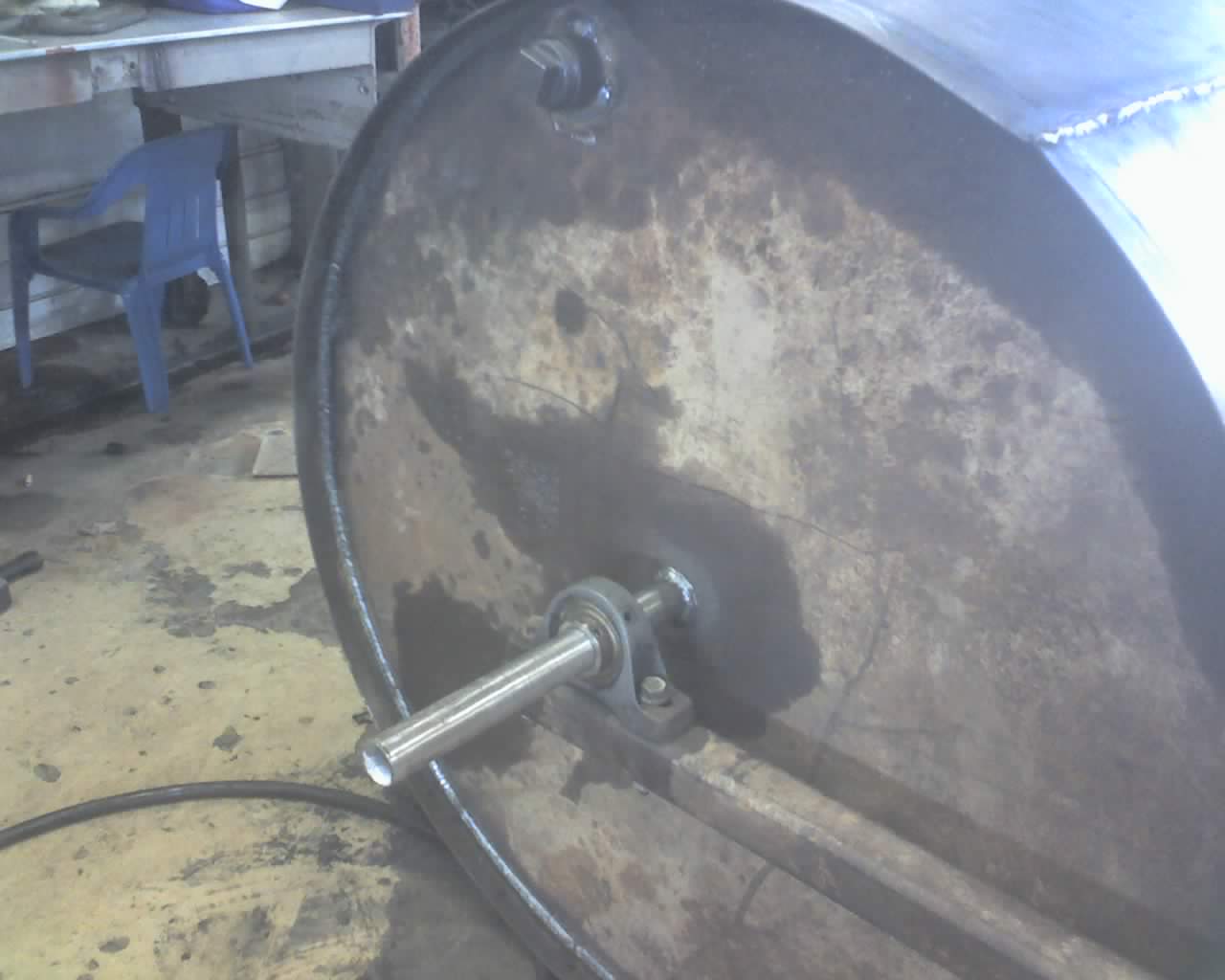

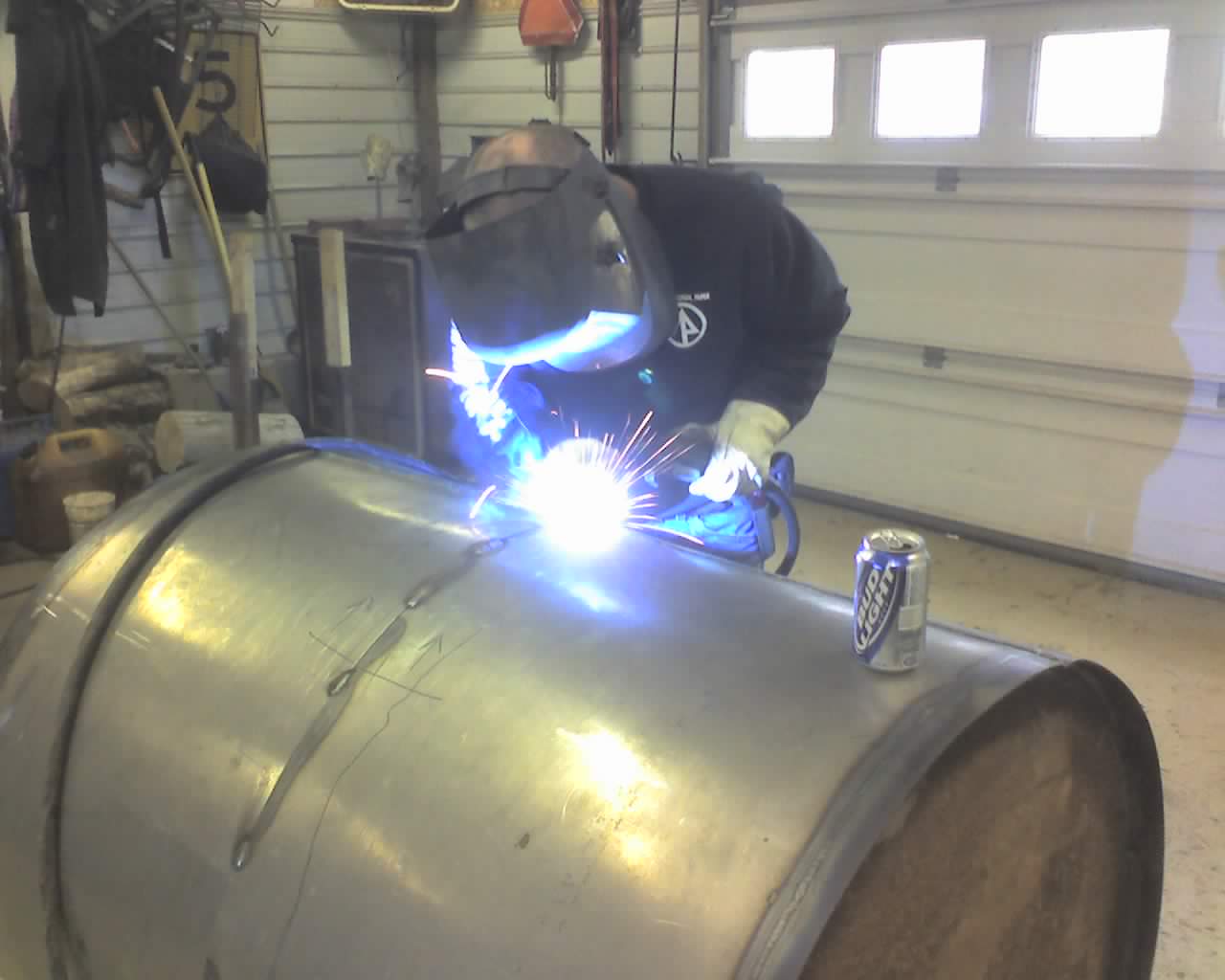

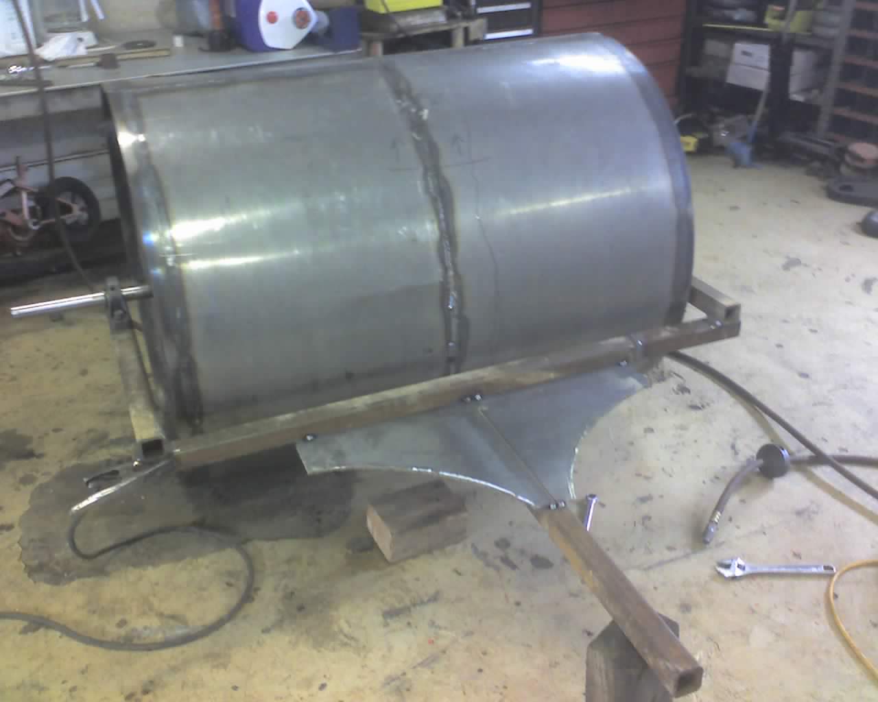

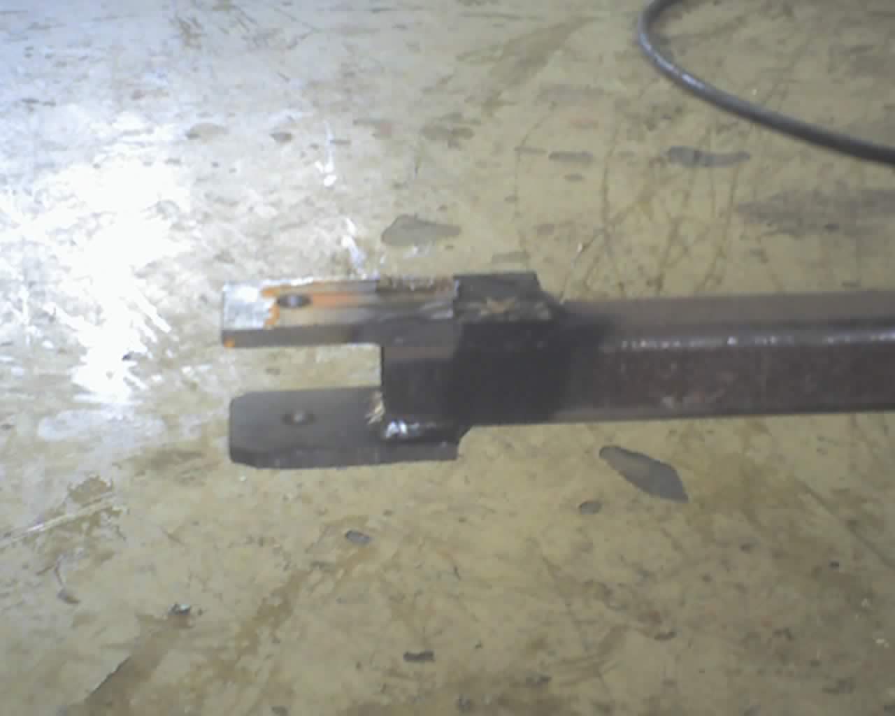

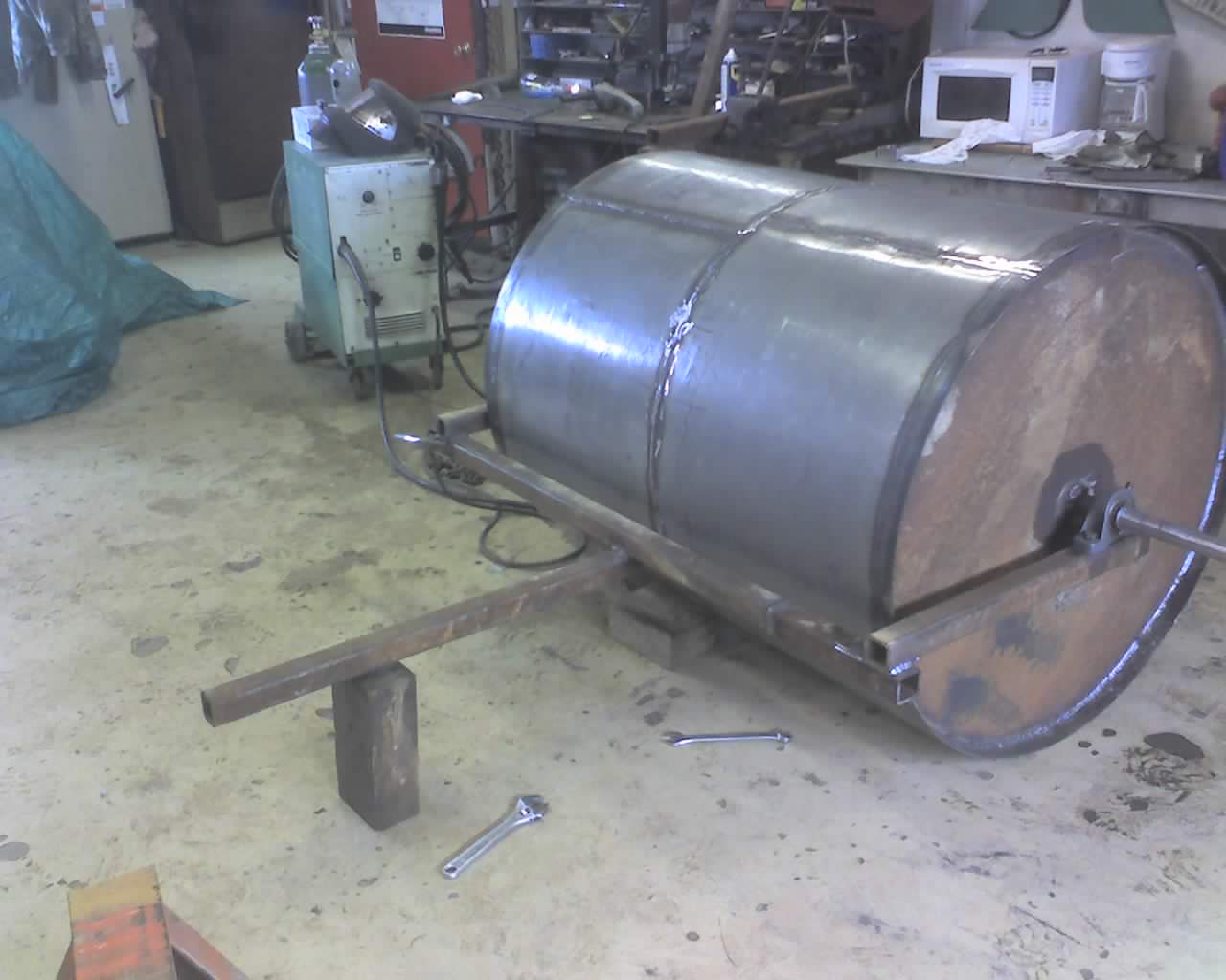

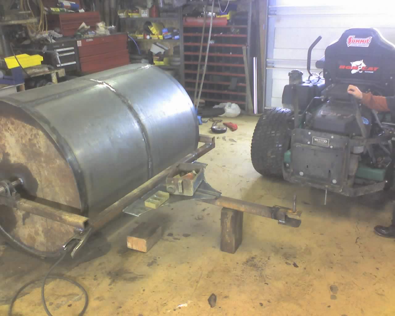

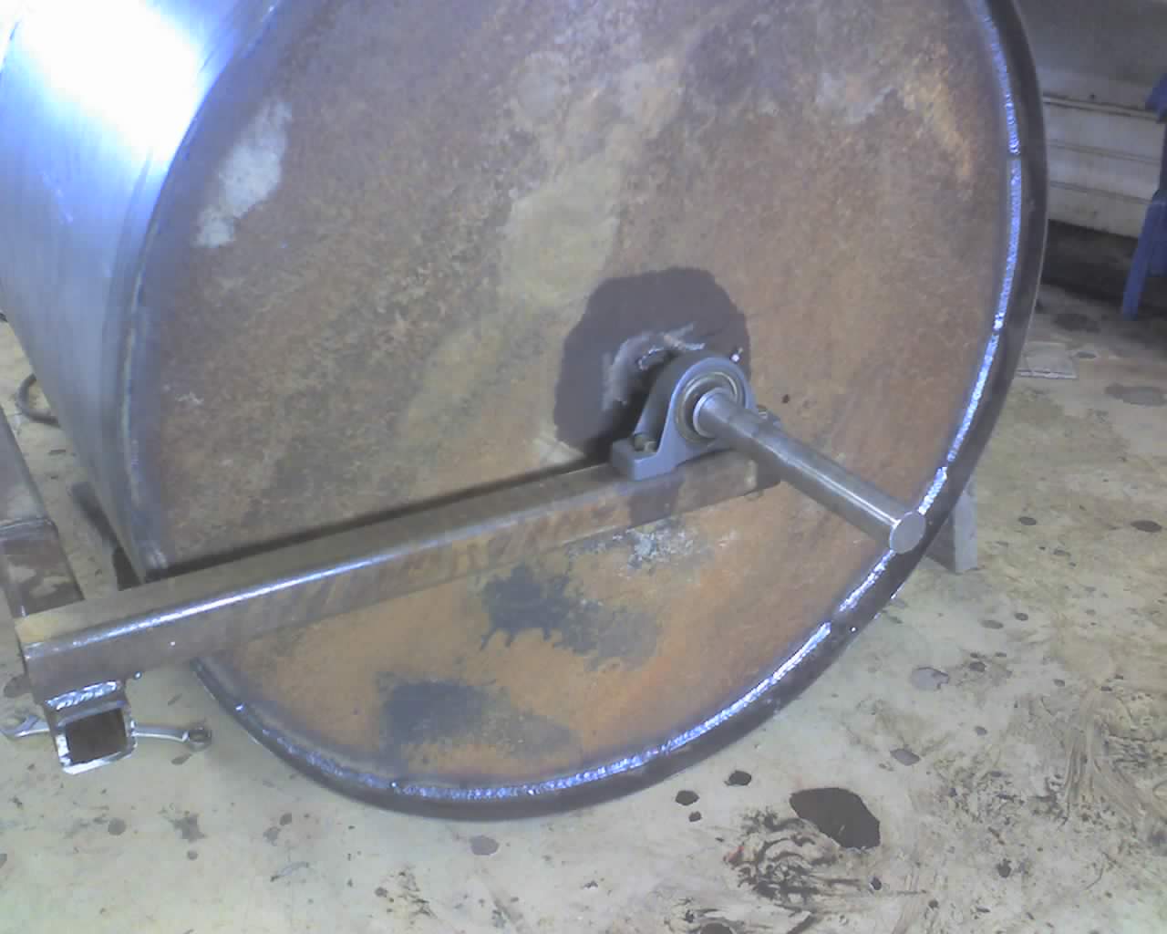

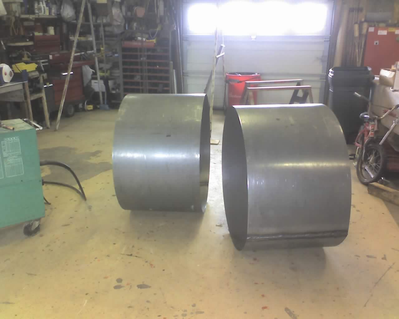

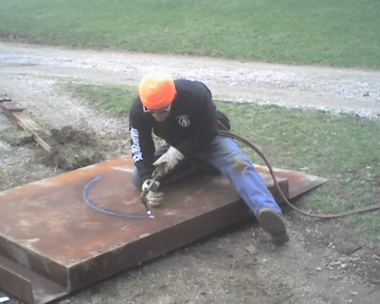

I had a new member on here stumble onto one of my pics of the lawn roller we made in the "show off your mig projects thread" and he PM'd me wanting some more info. So instead of PMing or e-mailing him I tought I would share it with the rest of TBN. As with most of our projects we took step by step photos along the way.
Just some details, The roller is 38" in diameter and 48" wide. The reason for these dimensions are that is what a rolled sheet of 4' x 10' steel comes out to be. However, we had to have it sheered into 2-2ft by 10ft peices because the local sheetmetal shop could only roll upto 3'.
The body is 11ga, which is 1/8" steel. The end caps and the center peice is 1/4". Dry weight is about 600lbs and it can hold about 230 gal of water. Which is 1800lbs. Total weight can be up to 2400lbs.

Feel free to ask me any questions if you like.
The only thing we actually had to buy was one sheet of 1/4" for one of the 38" circles, the 1 1/8" round stock, and the 11ga sheet. The sheetmetal shop only charged us $30 to roll and tack.
All the other stuff is from the steel pile out back, including the bearings. Total cost was about $250-300.

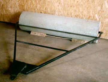

Any problems with it pushing downhill? Similar in design to mine (a smaller diameter roller filled with 'crete and a rack for adding more weigh on top).
Nice job welding yours up, and thanks for the pics.
/ Building a LARGE lawn roller
No issues so far but it's not too hilly here. We only fill it about half full of water. which makes the total weight about 1500 lbs

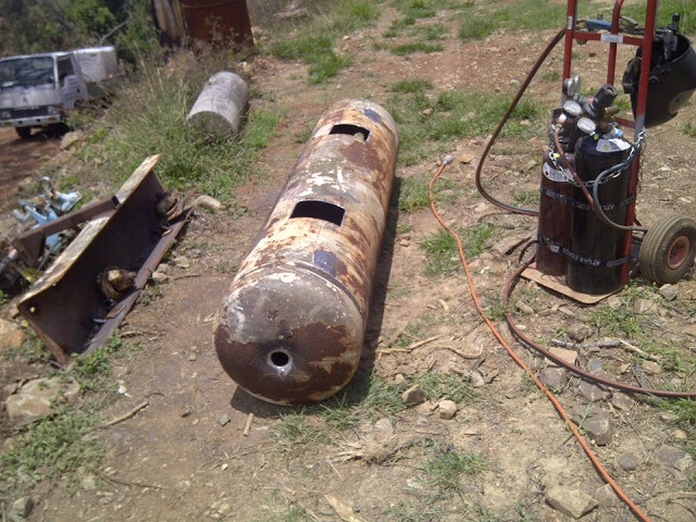

Great Job on the build,:thumbsup: Iam doing a new roller, Iam using old 500 gallon propane tank, scrap steel price, and twice as thick, The thicker the better, stones will dent (thin ones) very easy, Eric

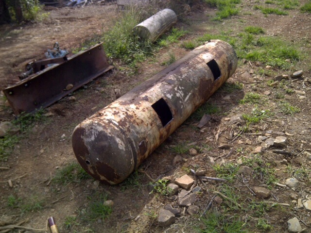

How to fill em up with concrete?? this was how I did mine - couple of 6" square cutouts then I put in a 2" stainless shaft I had that was a boat propshaft (didn't even have to cut it) an fill em up with concrete with a small shovel. Only have this pic of it so far but the concrete has surely set by now - maybe I can get back to this project soon - I have all the bearings etc, I just need to decide on a drawbar plan - either an A-frame or a single drawbar going back to a hoop over top of roller. There is advantages in each so I guess it will come down to material on hand.
