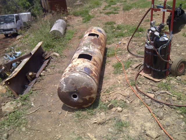

Great Idea !How Did You Fill It With The Concrete?

How to fill em up with concrete?? this was how I did mine - couple of 6" square cutouts then I put in a 2" stainless shaft I had that was a boat propshaft (didn't even have to cut it) an fill em up with concrete with a small shovel. Only have this pic of it so far but the concrete has surely set by now - maybe I can get back to this project soon - I have all the bearings etc, I just need to decide on a drawbar plan - either an A-frame or a single drawbar going back to a hoop over top of roller. There is advantages in each so I guess it will come down to material on hand.
