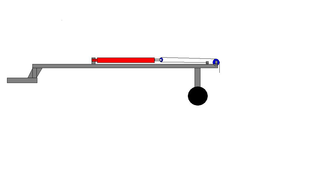

I'm looking at Log Arch threads because of a long rang plan to build one. Since I have a rear remote I'm considering a lift mechanism using a piston/cable idea like the wings on plow trucks. Here is a illustration. A 24" piston would yield 48" of lift. Any feed back is welcome...
Dean
   / Building a Log Arch #34
Dean
If you have the hydraulic remote hookup, I think it would great! If you got real handy with your log tongs you wouldn't even have to leave the seat of your tractor to hook up the log and not even stop to drop it!
