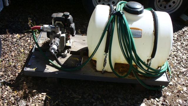

OI have a 30 gallon poly tank and a HONDA 1.5 inch pump and 50 feet of 3/4 garden hose, as a small unit I can drag up anyplace on property to monitor burn piles, If I need more the the 30 gallons I have not been paying attention to burn, shame on me..... Anybody know the number for 911...

PUMP IS HONDA Gas pump (Early model WX15) When a dumb redneck whats beer money and has $500 pump tagged for $40 at yard sale, you don't pass it up...... Not sure if I would depend on electric pump lasting needed time with out depleting SXS battery andstressing alternator... Having to drag generator along is an added complication if you are under stress in a "fire" situation....
And yes is on a pallet and tractor has forks....

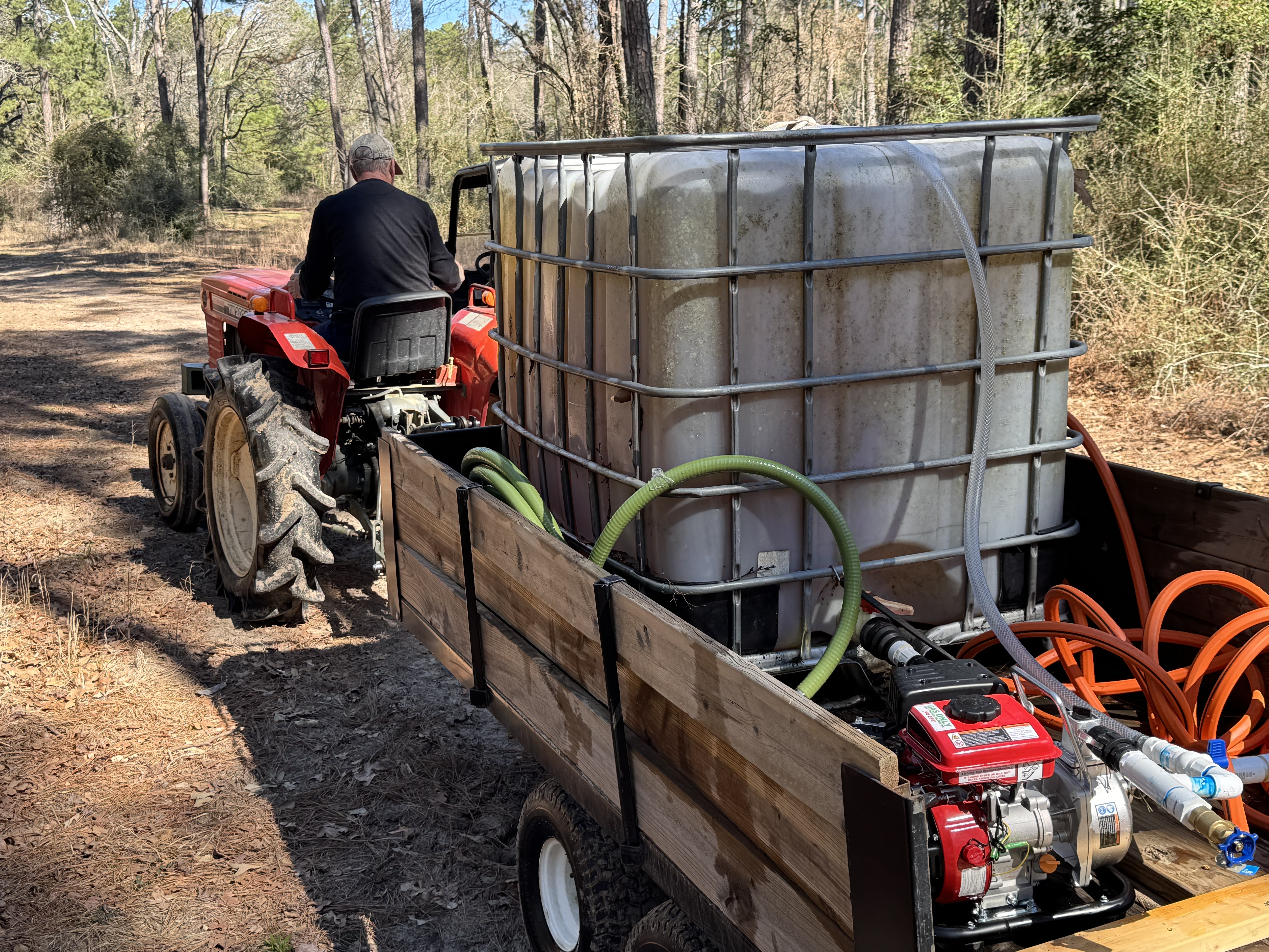

Built my system using a 285 gallon iso tank, a $200 HF 1” gas pump and plumbed to suck from tank or creek with recirculating line back to tank so I can keep pump running without issues. Probably have $325 total in system and use it on a Northern Tools 4000# off-road trailer. Can fill tank in less than 15 minutes sucking from creek and throws 60’ stream of water with 3/4” HD hose.
I also got a 275 gallon IBC tote like yours. Plan is to use it for watering and tractor it with forks when needed for fire protection. I like your idea of a trailer better for transporting flexibility in an emergency. This is why I ask you guys, thank you! Barrel/UTV setup I mentioned in the original post is for “immediate on site proximity” preplanning near burn piles.
Great layout - exactly what I was thinking! The barrel+UTV setup isn’t for emergencies, rather fire preplanning… but mostly watering in remote areas. Thanks again for the payload warning.

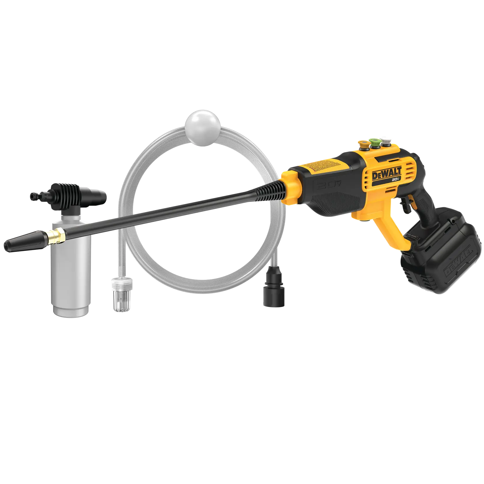

The Maine Forest Service has experimented with powering their backpack sprayers using a Dewalt pressure washer.
I'm not sure how that's been working out for them.
This DeWalt sprayer looks like a small scale version of what @tude mentioned above. Thank you!
