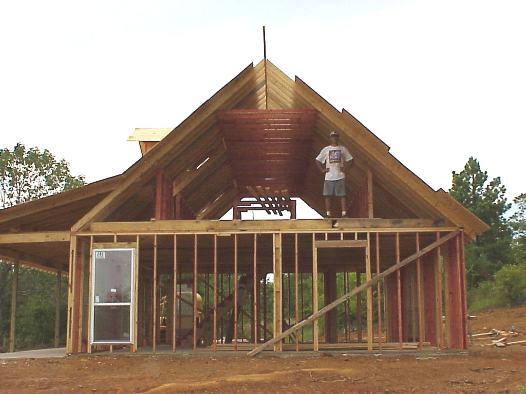

Hello everybody,Well weather was in are favor saturday and we got the trusses rolled.This morning we started bracing everything together.Today was very windy and we could not sheet the roof.Hopefully monday will be less windy,I will update you guy's soon thanks

Wow sure is nice to have a forklift to sit that ply up on the roof. When I did my house I clocked myself at about 15 minutes per sheet. Throw it up, spot a couple nails to hold it up on the roof, walk around and upstairs, silde it into place, staple, staple, repeat..60-70 sheets or so.
But your roof looks pretty mild, 4-12 maybe 5-12. The steep parts of mine are 10-12. Once you slip...you won't stop, shingles or not. :D

who your roof is pretty steep.Mine is 5/12 and yes the boomlift will spoil you quick.Thanks for sharing your picture.

Great pics and progress!! They re moving right along nicely.
I'm curious on what you are doing on that back porch? The posts are on piers, which I'm assuming means you are doing something other than a concrete pad?

I can't tell for sure what your fascia boards are made of. Looks almost like plywood. Are you going to cover them with another material, or is it dry enough in your area that you don't have any issues with them rotting? I've replaced quite a few fascia boards and soffits because of this on homes here, but we get over 4 ft of rain per year and have very high humidity.
What I really don't understand is why you have the edge of your roof decking a different material than the osb?
The PEX sure looks nice. I've never used it, but I'm seeing it more and more. It's got me to thinking I'll have to give it a try.

the fascia is 2x6 and the end of the roof is 1x6 shiplap it gives a clean look from the underside

OK, so you're not putting in a soffit?
Are you venting through the spaces between the trusses and leaving the ends exposed from the underside?
The last house I built, I used a low profile ridge vent that was just about invisable. I don't know what your plans are, but with a composit shingles, it's the cleanest venting system I've come across.

I thought the fascia looked like regular dimensional lumber. Out here they use a lot of hem fir for fascia. There is a fascia that works really that well won't split, twist or warp nearly as easy as dimensional lumber. Its LVL veneer fascia. It comes in 5/4 or 1.5" sizes in 16 or 20 foot lengths (maybe even longer). I don't know about really tough conditions like high humidity, but I suspect it will hold up. The 1x6 sheathing on the overhang is very typical and sometimes on stick framed roofs where you can really finish the tails nicely it looks much nicer then a soffit.
