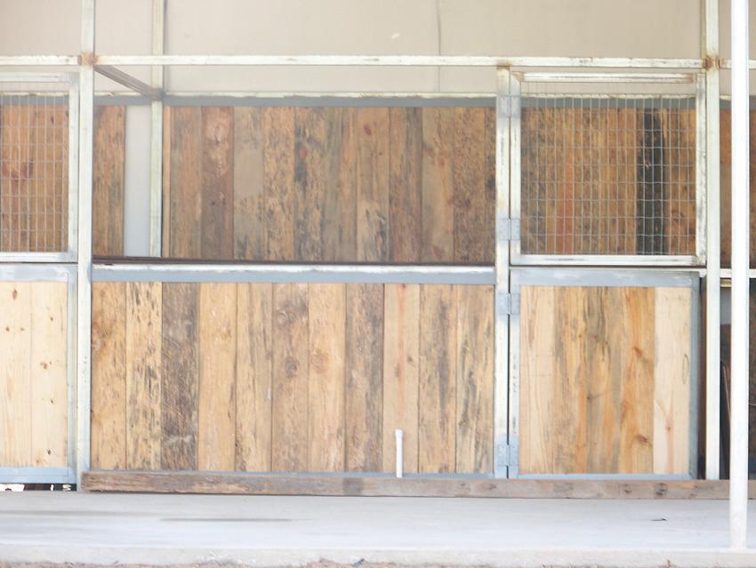

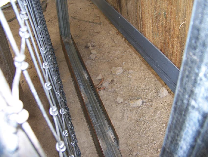

Hold on there. New member, first post and only two pictures. What's the big idea? I need to see some more pictures of the inside of your building. Pole building with block base?
I was wondering about that myself! BTW: :welcome:

You can buy premade stall doors. I see them in horse magazines. I use 1" square tubing, sort of thick walled, my cheap metal bandsaw and my Hobart welder. I skin with plywood. The joy of homebuilt is my openings are around 48" give or take 1/4" which could be frustrating. My big sliding doors were done on a frame of 1.5" square tubing allowing me a 11"' wide and 10' tall opening to drive the hay trailer through.

I like the idea of metal frames on the doors. We always had dutch doors on the old barns, but even when they were only 3 feet wide, we would have sagging problems over time. With 4 foot width, I think metal bracing and lots of hinges would be a good idea.

I like metal frames for the doors as well. Mine are out of 2.25" 12ga tubing, to match the rest of the barn, but smaller tubing would be fine. I went that big to be able to use 2x rough cut inside the frame.
