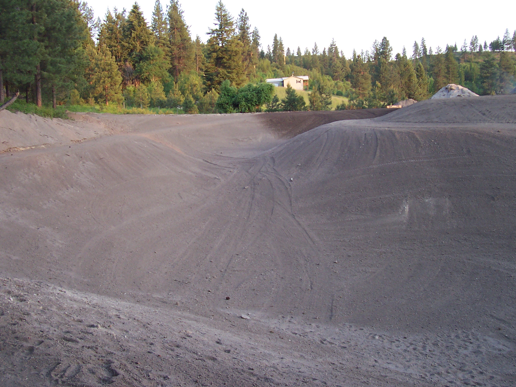

Here is a funny story for you. I have an artisan well that produces 30gpm at 132ft just down from my pond, so I dug down another 30 ft at the bottom of the pond. I did not hit the water table so I filled the 3ft x 6ft hole that I dug and compacted it with the bucket as I went. I filled the pond for 3 weeks 24/7. I had the pond about 2/3 full when the water found its way to the water table through the hole that I had previously dug. The pond emptied itself overnight. I have now let the pond sit for 2 years to recompact the clay based soil naturally. This next spring I am building a man made creek and waterfall to aerate and circulate the water. I my natural compaction does not work I will have to line the pond, but I am hoping that I will not have to do this. I do not like lined ponds.omh pro screen usa 4 10 2010 122.jpg

In my experience, the ground between the bottom of your pond and the water table needs to get saturated before the pond will hold water for long periods.
Also, hot and windy days can evaporate an inch per day. You could lose 2 1/2 feet in one hot dry month.
   / Building a pond on my property to stock fish #16
I thought that soil looked pretty light with no clay base , If it were me I'd drop about 10 large loads of clay in the bottom and let it settle over the winter and with your nw Pa winters it would probably stay filled come spring ? a local neighbor dug his 4 years ago and it finally held water this year .:thumbsup:

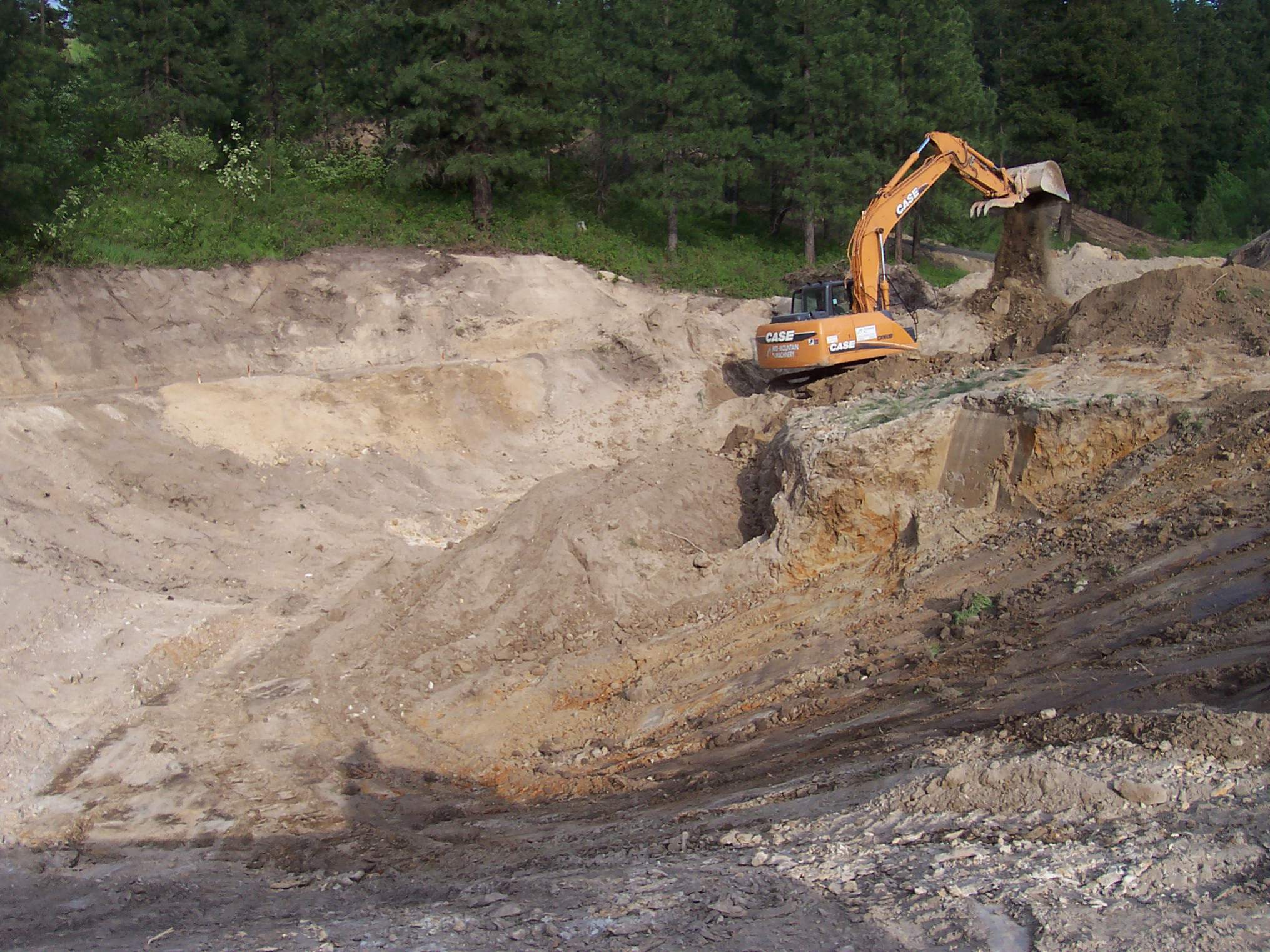

omh pro screen usa 4 10 2010 120.jpgwhat you are seeing is 2 inches of topsoil on top of the clay. I was not going to finish the pond right after I built it so I spread soil to grow good grass and not bad weeds. Here is the type of clay that I have to work with.

looks pretty light ,if you pick it up can you make a "snowball" out of it with out it falling apart when thrown hard , that would be good clay .
