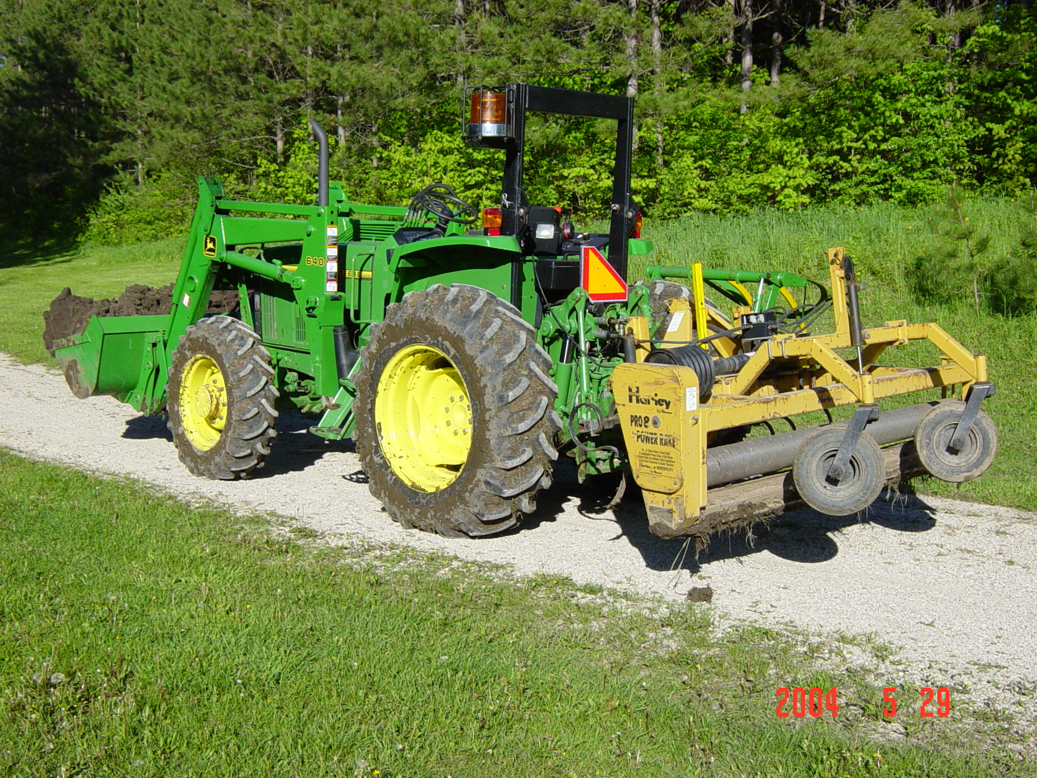

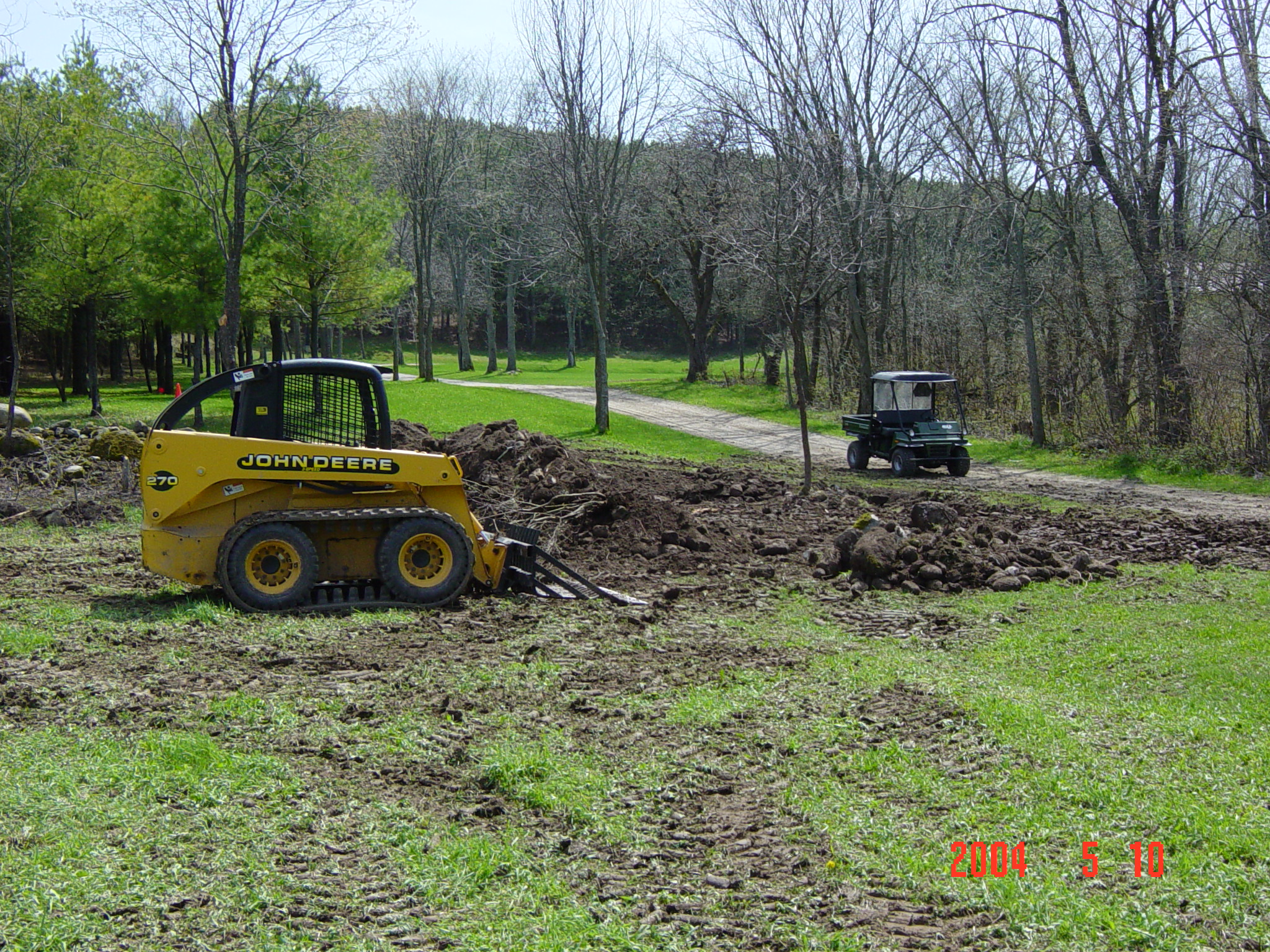

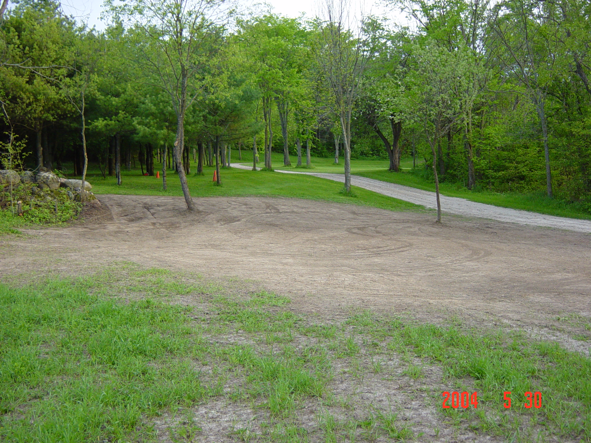

Just some old pics from my own Harley Work. Not my SS.
Sure, the area was seeded and rolled, but the Harley did the most impressive part of it.
