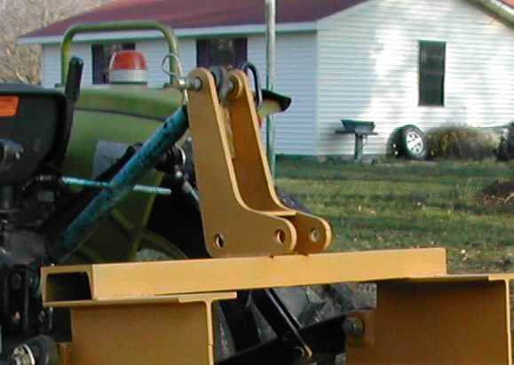

what are two parts that the top link hooks to made from.

The top link bracket is actually a bracket from a Yanmar tractor. The tillers that come with the Yanmar grey market tractors fit close to the rear wheels of the tractor and use a short top link. This bracket attaches to the tractor where the top link would go and then the short link attaches between it and the tiller. I have attached a close up.

thanks, That looks like what I need to hook a top link to on my Iseki
