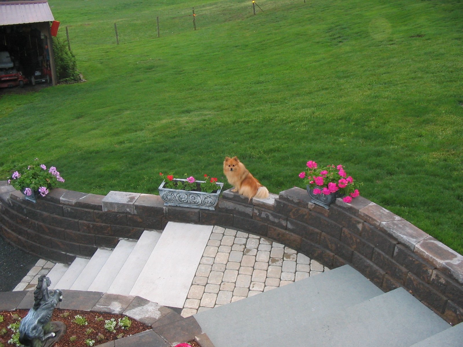

I agree about the engineering needed. I just finished tearing out a sandstone wall (3 tier) that I placed about 2 years ago...it started to slide! I replaced with Alan Block "Europa." The sytem worked great but is detail/labor intensive. But still nowhere near as hard as laying variable sized sandstone/barnstone. For wall over about 3 feet the system uses a geogrid to tie in to the soil behind. You need to dig out about 4 feet behind the wall to compact with this geogrid. It seems to use more stone than the system calculates. I have now placed about 30 pallets of this stuff. They have 4 block sizes in two patterns that makes nice looking wall. I guess you could use a similar geogrid between normal sandstone to help it hold better.
If you have facing stone I would put up block and core-fill. But keep in mind that some of the "pre-engineered" systems like Alan block can hold back better and drain better than poured or block concrete. If you don't need a lot of strength (3 feet with no surcharge) could you just core fill every fourth hole or so and drop rebar? That would save a lot of concrete. If I recall it takes just less than 4 block (8x8x16) for one cubic foot of fill concrete or insulation. I don't know if this helped but I just wanted to share my experiences.
