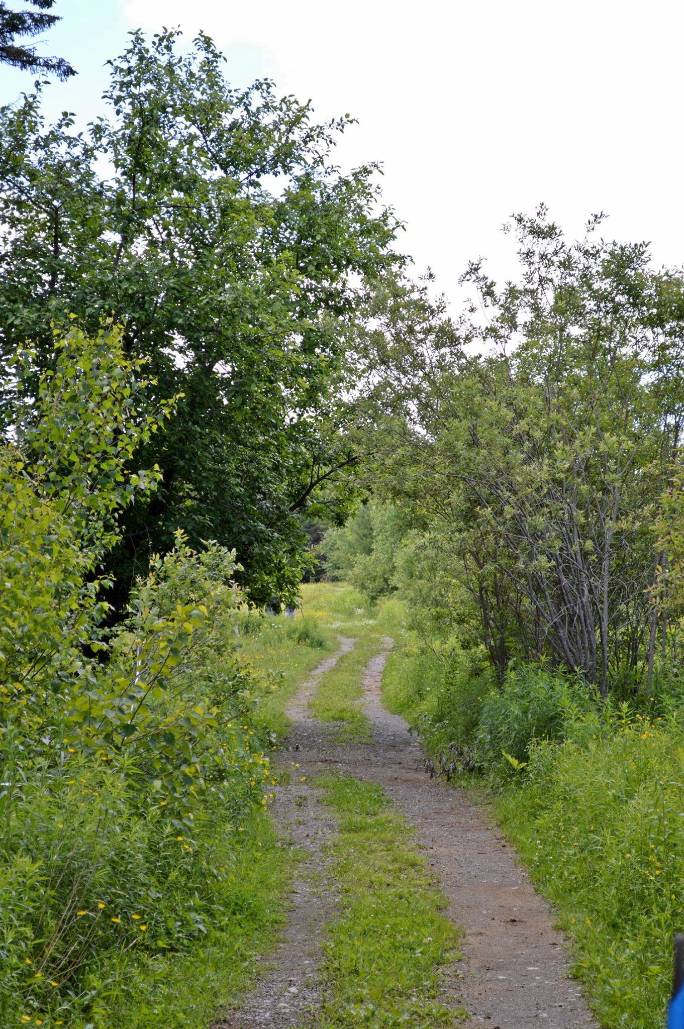

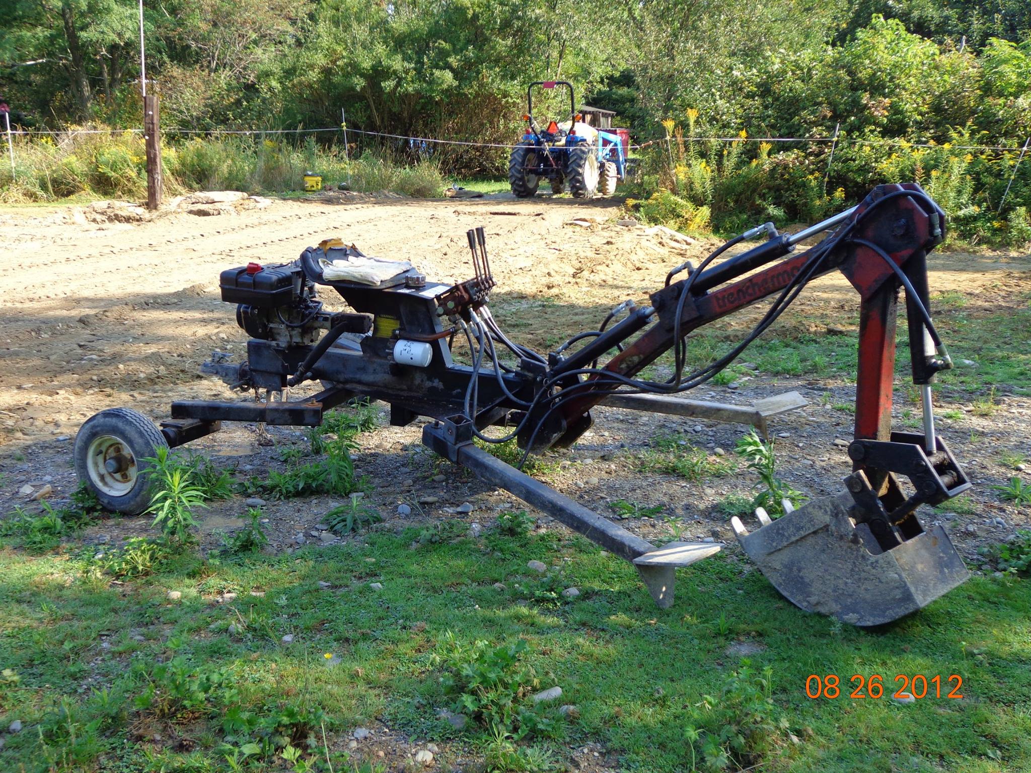

I put in a small road to my back field through wet clay and a boggy area. I ditched one side all of the way that was on the high side of the land. That stopped the water from coming across. I ditched 1/2 of the other side. I dumped the dirt from the ditching onto the roadway. Then I spread 4" of gravel over the road. It has held up well- daily traffic from my horses and tractor. I used my mini backhoe for the ditching. -- (A tractor could handle those trees in the OP's photos.)
I used this mini backhoe. 21082867_10210391335995010_741538823851393330_o.jpg This is the road- solid footing as the horse canter to the back and as the tractor makes repeated trips to the back.
------Pay attention to drainage in putting in roads. If that isn't working- the road will be a mess when it is wet. I use culverts to direct run off to other ditches that I have put in. 11402353_10204860318883039_6865676161383161918_o.jpg
