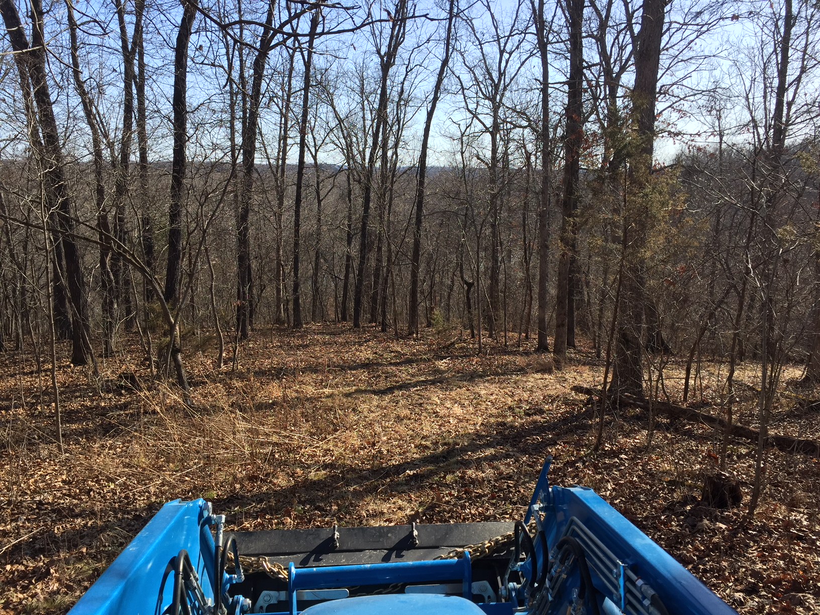

Got in some tractor time today and all went well. Goal of today was to pull/push trees along the route. I did reassess and change the route a but based on suggestions here for water control. I cleared a bunch of small trees. Got almost to the bottom. I pushed a 4 or so tree over instead of uprooting it snapped at the base. Its layed all the way over but still attached. Couldnt pull it nor push the stump out and its on the steep section so I stopped there for the day. I plan on going back Saturday and finish getting that tree up, get to the bottom then start with the box blade.

Pictures or it didn't happen.... :laughing:
The pic taken from the tractor shows the reroute. Instead of going straight down the hill I went to the right and followed the slope around for a bit.

Looks pretty good. You sure you want to tear that up with a box blade?
Yeah, that's a good question. Why not just get the trees out of there and drive up and down a while and see how it packs down? The more you disturb the soil, the more likely it is to erode. Unless you have to cut down the slope, leave it go. The roots in the soil will help prevent any erosion.

Some of it definitely to get the right grade/slope etc but a fair amount of it I could probably not run the box blade over. The ground is not real soft. A little loose on top with scattered 6-12” rocks but pretty solid under that.
If its useful at all we had a dozer come in last winter and clear a road and clear a small cabin area and that ground is very hard. I havent graveled it yet and I can drive on it when the ground is wet without leaving ruts. He did a great job and only cost me $400! He also did the clearing that you see in the pic taken from the tractor. His dozer blew up though and hes now driving a truck. :/
