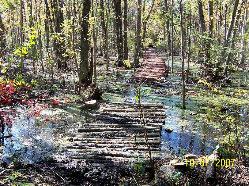

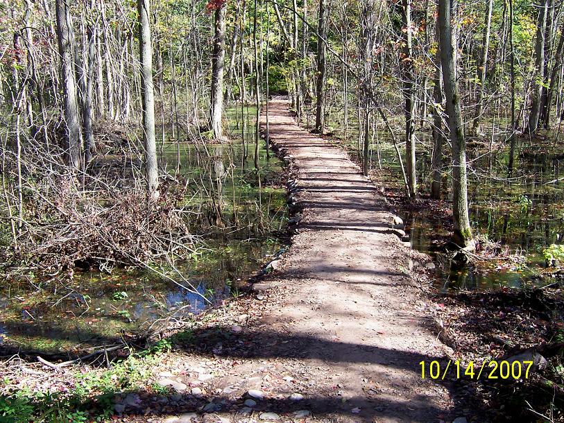

MarkV:
This road is built similar to your description. It's about 80 yards across a swamp. I put the logs in, covered with field stone, then covered the stone with dirt.
I also have some shorter sections of road where I used just logs, as you described. The log roads (we call them corduroy) will last for generations, but they would be tough to ride a bicycle over.

MarkV:
Chipndust shows a perfect example of what I was talking about. Great job by the way. In my case I wasn't near as wet as his swamp, just clay mud like the OP's that would not dry out. The logs plus 8-12" of soil and it is as smooth as any of the other trails on the property, also stays dry.
