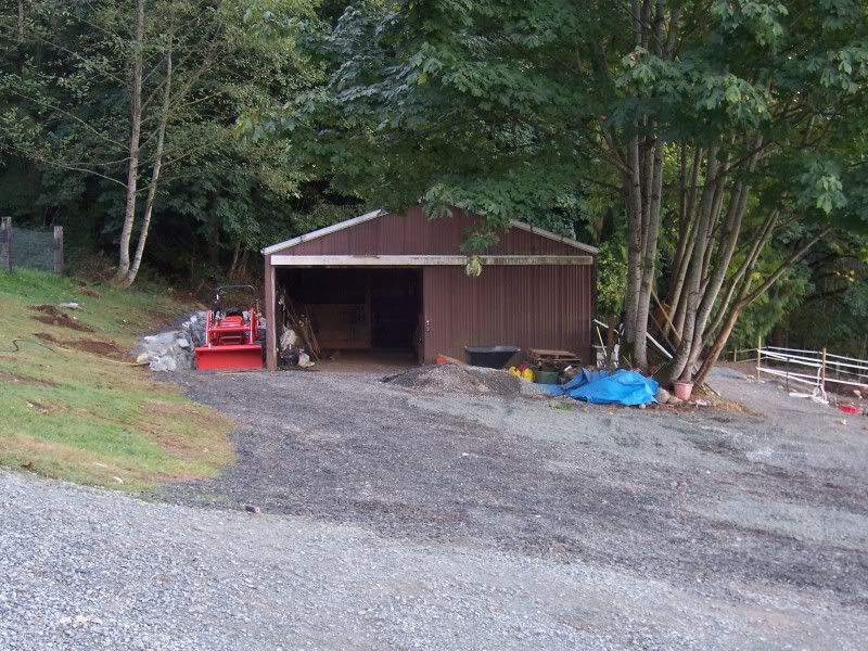

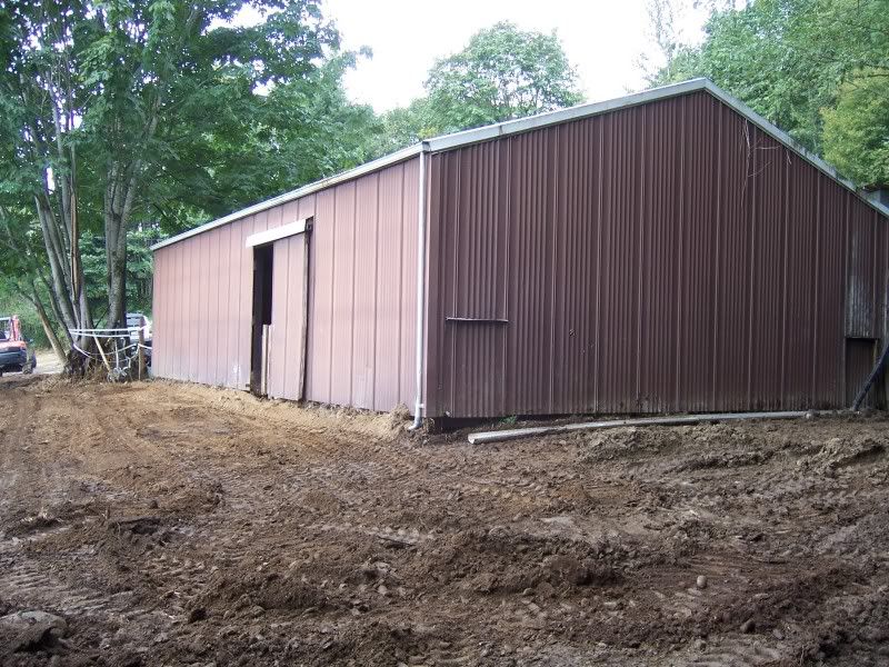

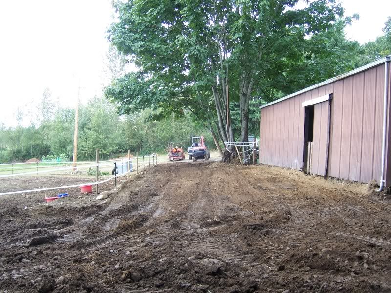

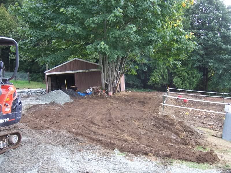

ok so the project is almost completed. I had 14 yards of of 1-1/4" minus brought in just before the rains came and got it spread out, it was a good test to see how the drainage was working and after making a couple slight mods water is going everywhere it's supposed to and nowhere it isn't. A few days ago I had another load brought in. I think one more load ought to take care of it through the winter. I am trying to figure out a good way to keep it even and take off any high spots, etc.. maybe a boxblade but I am thinking something more like a drag or a rake, oh well will save that for another thread.
This segment of photos shows the grading before the gravel is laid..
side/back shot:
area that was built up to provide access around front side:
built up transition to driveway:

anyhow i still have piles of wet soaking mud laying in the end of the low spots which is now probably setteling and making it a mess to work with :( I need to move probably 50+ ton clay/soil mix about the property. biggest problem I have is my drive is LOW and has small raised grade between the barn & drainage plane the drive is lowest spot which means the cars/trucks will always be setting in the wet spot waiting to freeze into ice. the phone lines and septic are on the other side of the raised grade and is a good 16" higher so I'm sort of stuck for ideas other than an attempt at tieling it away & going under/through the phone lines, drive enterance and the septic field :( :( IF I go the other way I could tile it but would need about 300 yards of tile & probably would have to be 6" + to handle the volume this also means going over/thourgh /past the elec service waster return & water service to the barn... again not a good choice..

You know what I wanted to ask you is I notice in some of your pics like the last 1 is it seems like you building is lower on the left side. Is that just an illusion or did it drop on you

yeah it sort of looks like it's sinking but it's just my poor picture taking skillz.. hehe. here is another shot where i actually tried to get it lined up right. the project for next spring is going to be to paint it, it needs it in a bad way, things around here like to collect moss and mold...
