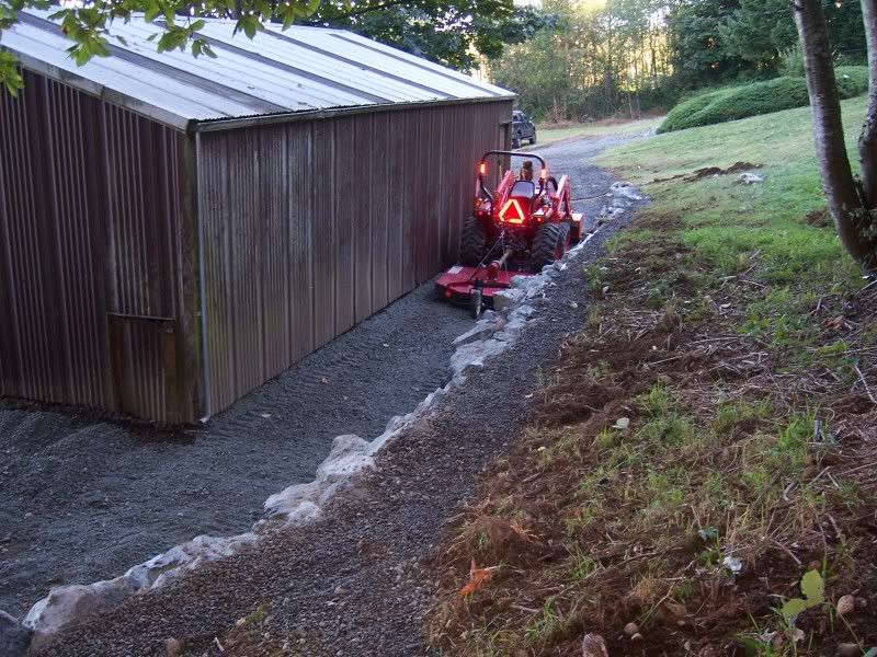

Well this project is pretty much completed, I need to do some final cleanup and such but the big work is done, I think it turned out pretty decent and should perform as intended.

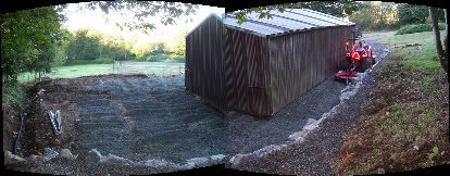

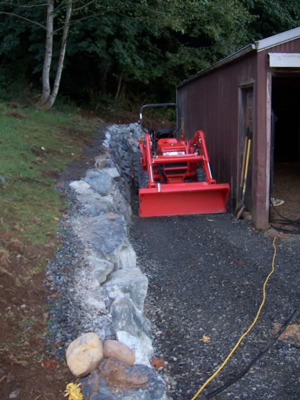

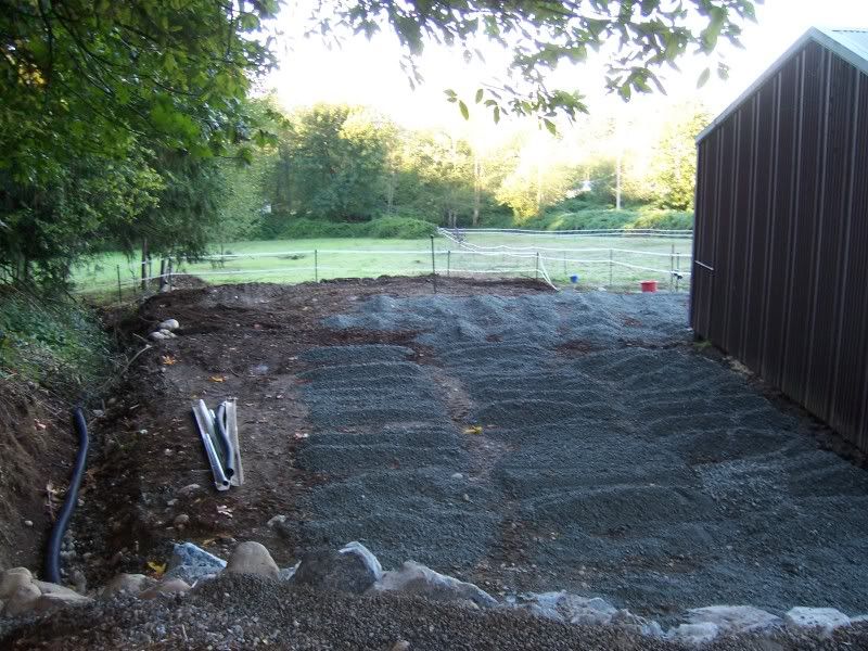

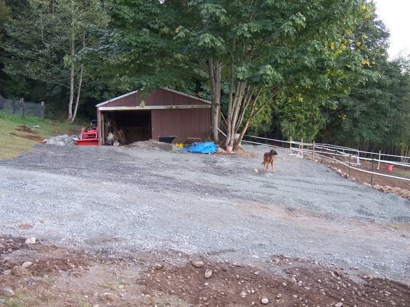

Well - I thought I would add a couple after pics to show the difference between what it looked like before I started and how it looks now. compare these to the first set of pics on this thread:
I tried to stich the 2 and this is what came out:
View from front:
Just enough room to get the tractor in there:
