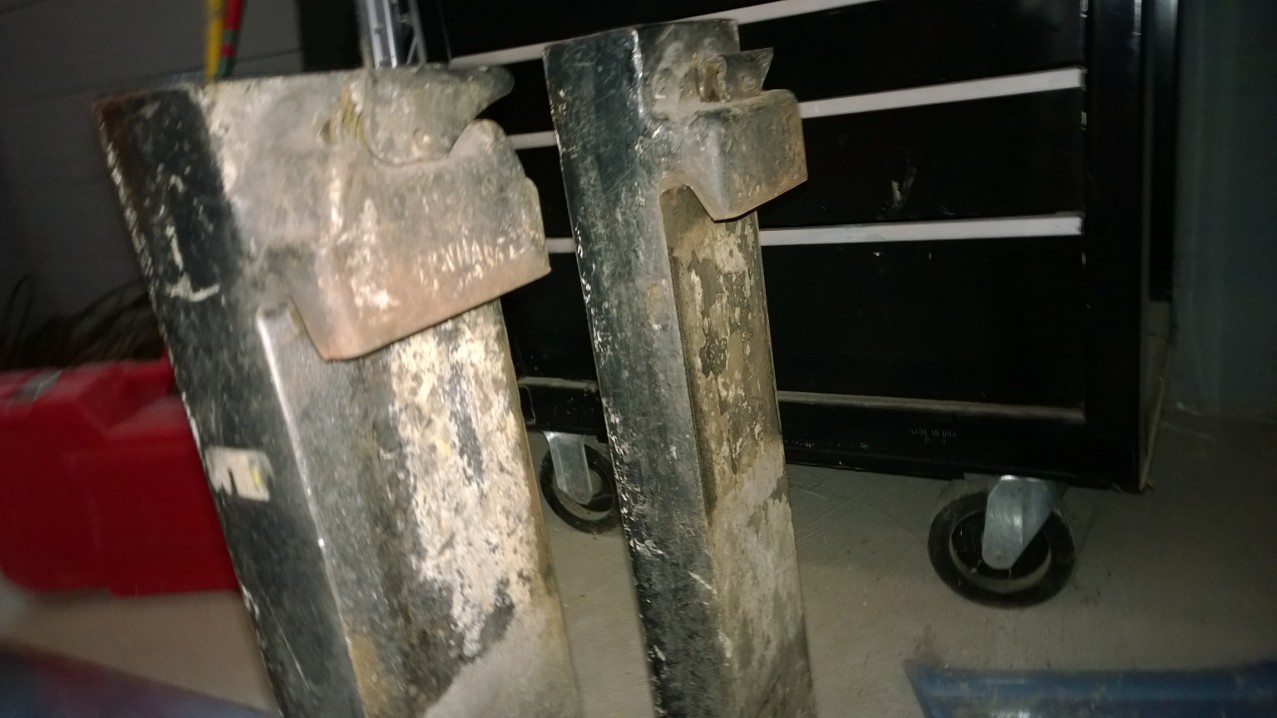

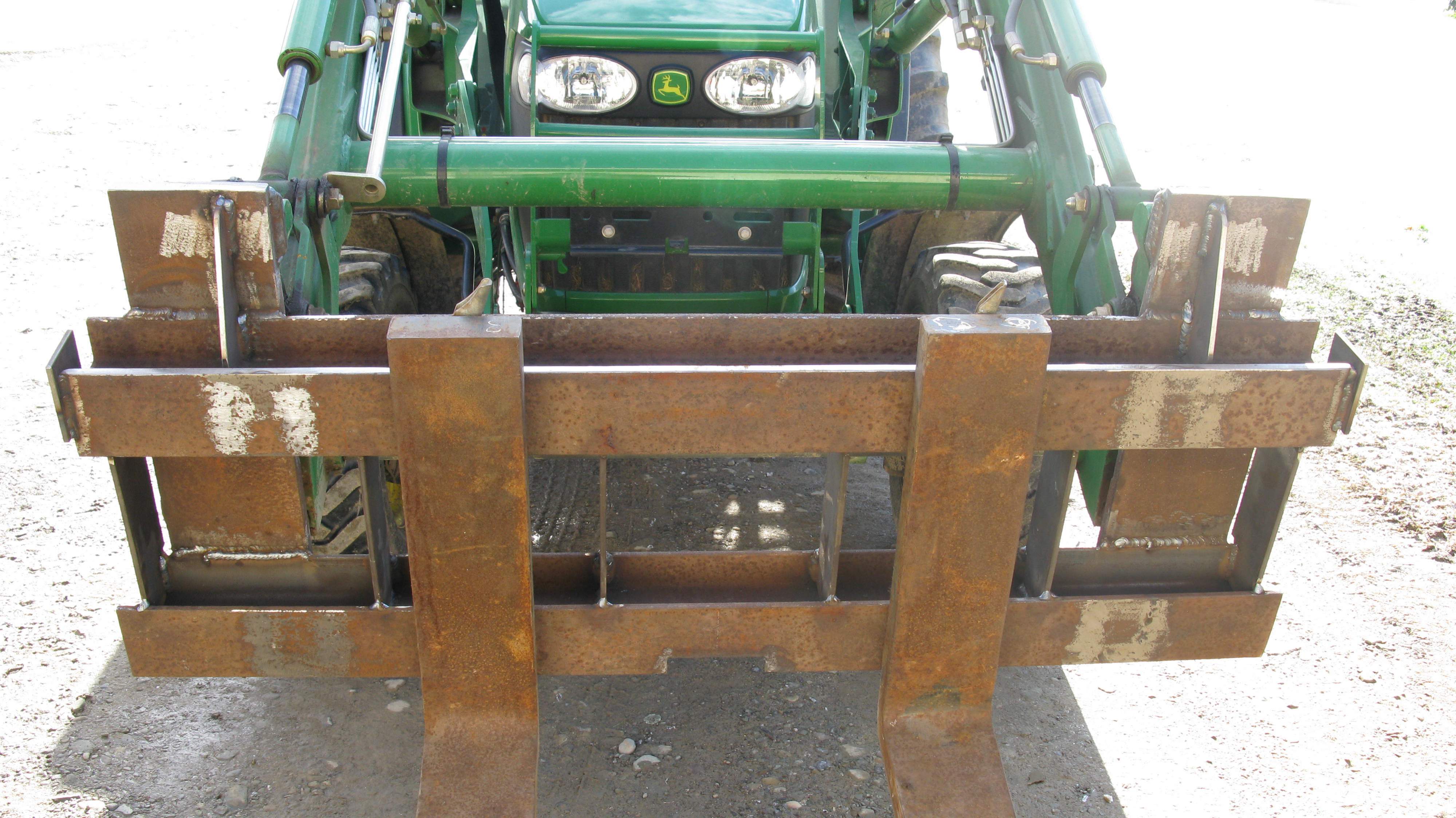

I was just about to purchase some quick attach forks when I got these used forks from work from a fork lift. I need some idea or pictures of people that built their own forks. I don't have any metal, so I would have to buy some along with a quick attach plate.
   / Building a set of forks and need some idea's. #2

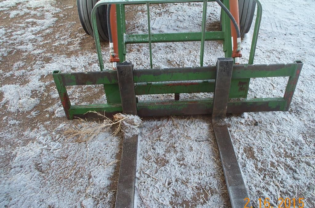

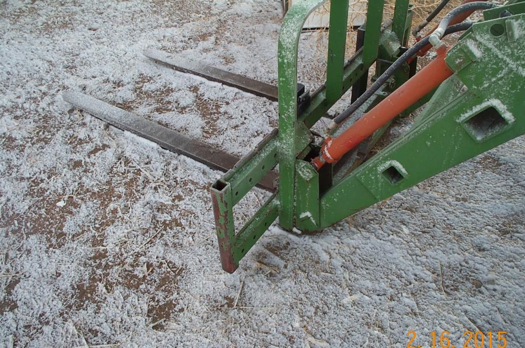

basically the same type of forks I have on the tractor,
I made a frame and on the frame there is a spacer, and on that spacer is a lip with notches that the top "hook" sets on, the notches are about 4 inches apart, (the pin in the top locks in to keep them from sliding, the back of the frame are quick connects on it,
basically copied the same as the top for the bottom but with out the notches, leave some tolerance in them or they will not slide, (to slide my forks I tilt them down and let them hand mostly on the top lip and they will side a lot easier, I will see if I can get a picture here and post it,
by clearance or tolerance, what I mean is look at the pictures of the forks on the top of the slide bar, there setting on the ground and the loader is all the way down, there is about 1/4" of movement up and down if tighter it will make it very hard to move or slide them as they will rack some and lock tight.
I had the old plow and used it frame to make the frame, I would think in a lighter duty loader one could use a heavy wall tubing if you have solid use it, (most all fork lifts have solid frames the forks attaché to),
If you look from the front you will see a notch the width of the fork, it make put them on the frame easy, hook on the top and let swing down and slide side ways. if one try's from the end it is a lot of effort,

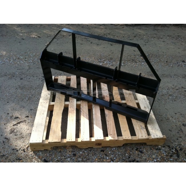

Would have been nice to get carrier with it, then it would be just mocking up a QA to it.
While I am not much help, and without knowing your skills (fabrication) I think you might just spend more money trying to make something vs buying.
Everythingattachments has QA pallet forks for ~$650. Not sure if the forks you have are the same as theirs, or will fit their carriage or not, but might be worth asking them if they would sell just the carriage without the forks?

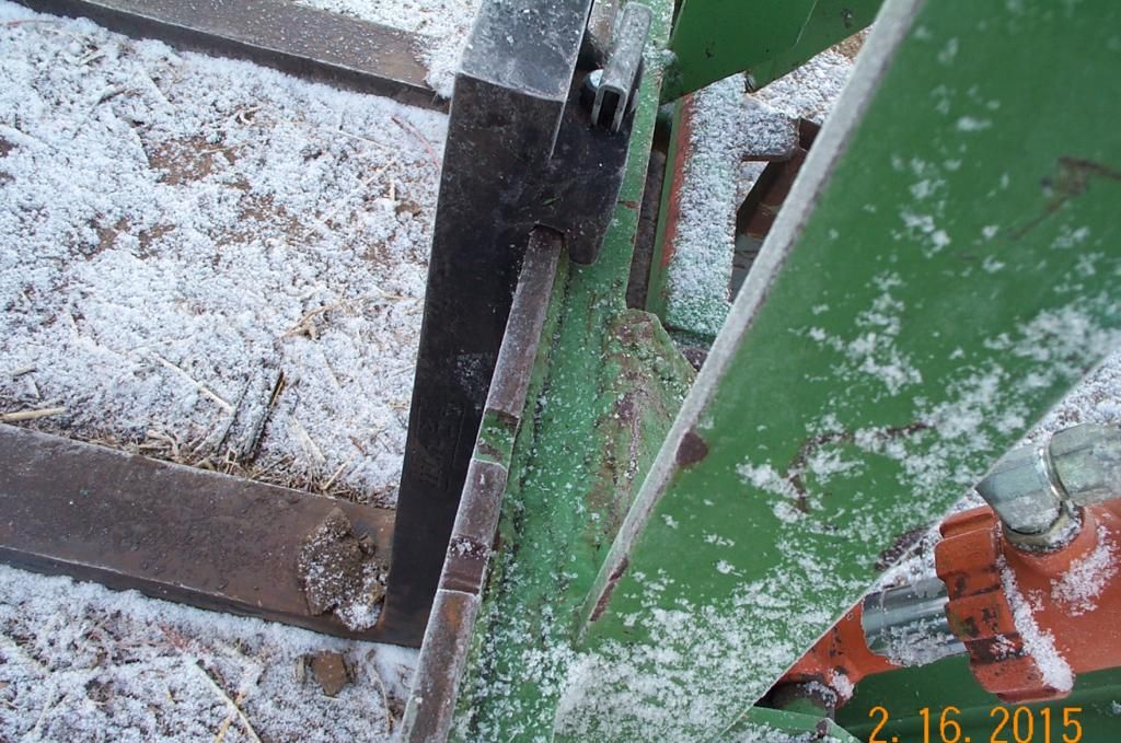

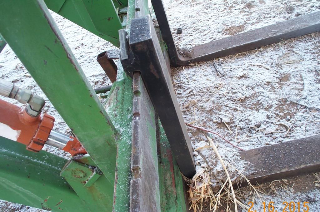

Plan B for the pictures
Note the notch in the bottom in the middle
you can see the solid iron and the 1/2" flat I sued for rail/track
note the clearance in the rails to the forks

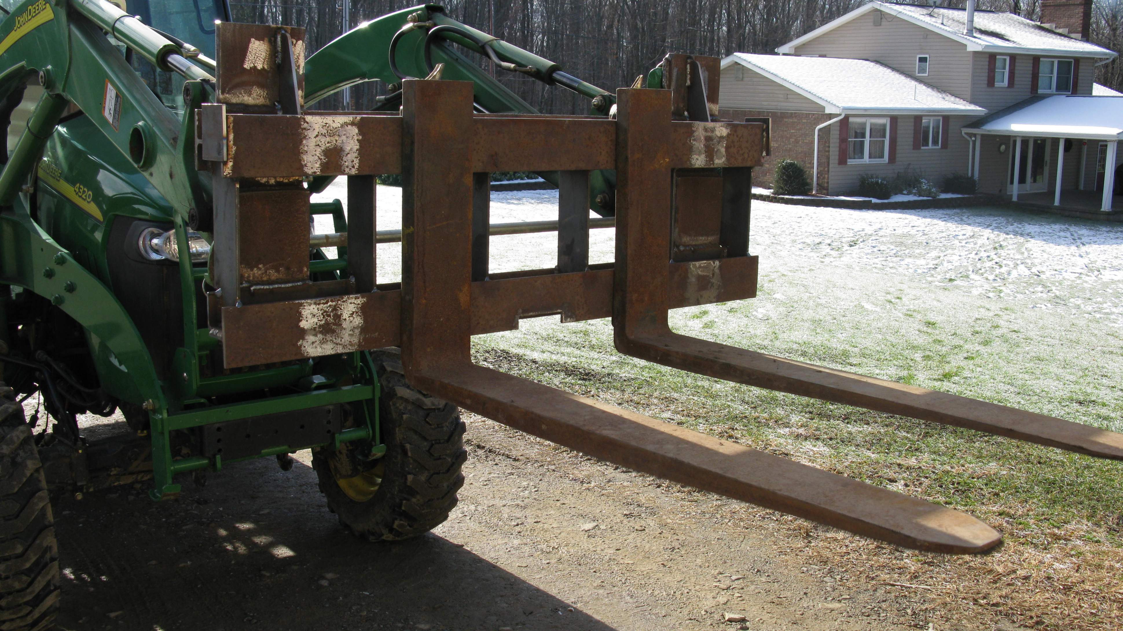

IMG_2534.jpgIMG_2529.jpgIMG_2531.JPGI made this for a friend several years ago. He had the forks and some old material. I just put the stuff together. I did not paint it because I was tired of working on it. The old material needed ground and rattled before I could weld it. He purchased the JD mounting hardware. Next time all new material. If I remember correctly the dove tale for the forks is 22.5 degrees. Maybe you can get some ideas on how to approach this project after seeing these pictures Keep everything level, because the last thing you want it to have each of the fork tips at different heights say 4 or 5 inches off. Just a note when I wanted a set of forks I just went out and bought them. About $820 plus tax. I posted this before but I do not know how to copy the link into the post. Later. Wrong again on the dove tail it should be 22 deg Thanks to Xfatman

I didn't know I could buy just the frame and using my Forks. That would still save me some money.
#13
I got my Pallet Fork Frame in last week and put the forks on it. Works great. Thanks for the suggestions. This saved me some money.
