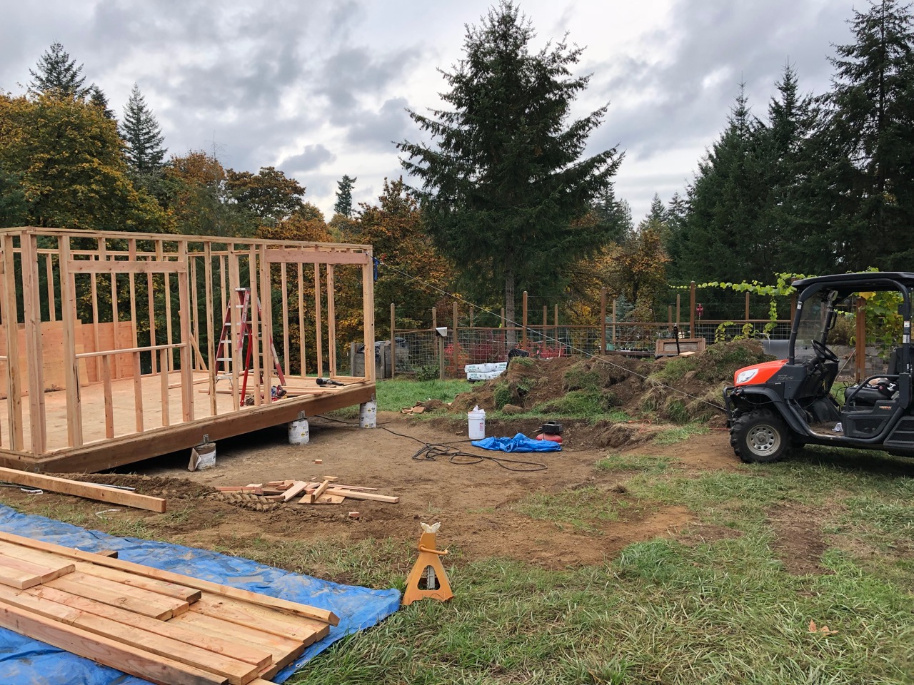

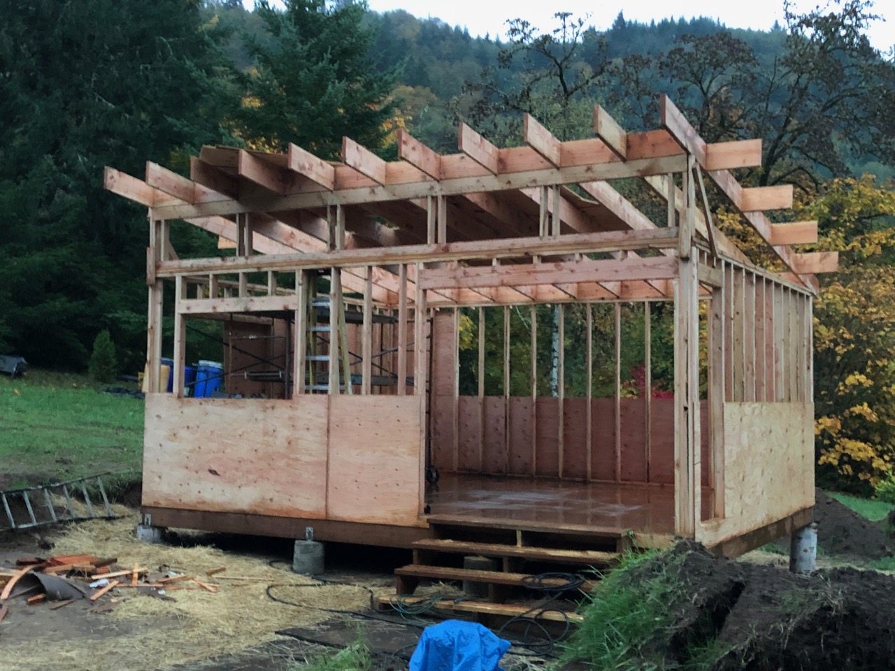

So I got home late September, left a couple of weeks later and the Movie I was to start folded due to the director hating the script. So home I went, and the wife said "You are not sitting around waiting for your shop to get built, you are helping build mine". Helping generally means providing the money, and the manpower, and doing at least 50% of the labor but not being in charge while being in charge. Its is complex dance...
Anyway, we had bought shed plans on the internet a while ago.

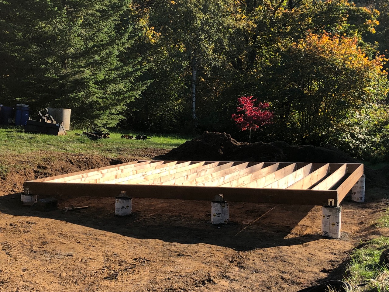

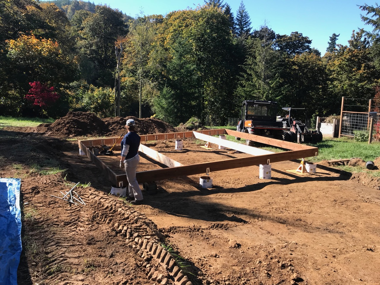

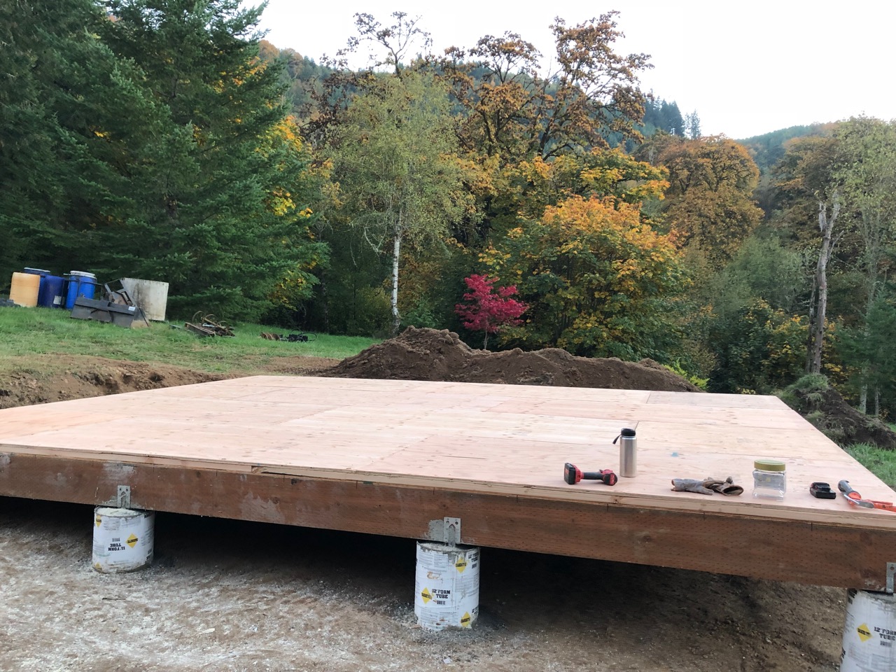

So pretty self explanatory, We had some other dirtwork going on so the guy dug out a space for the building. It was neither level and was far too deep, thank you very much for not listening. So more concrete than necessary was put to use.

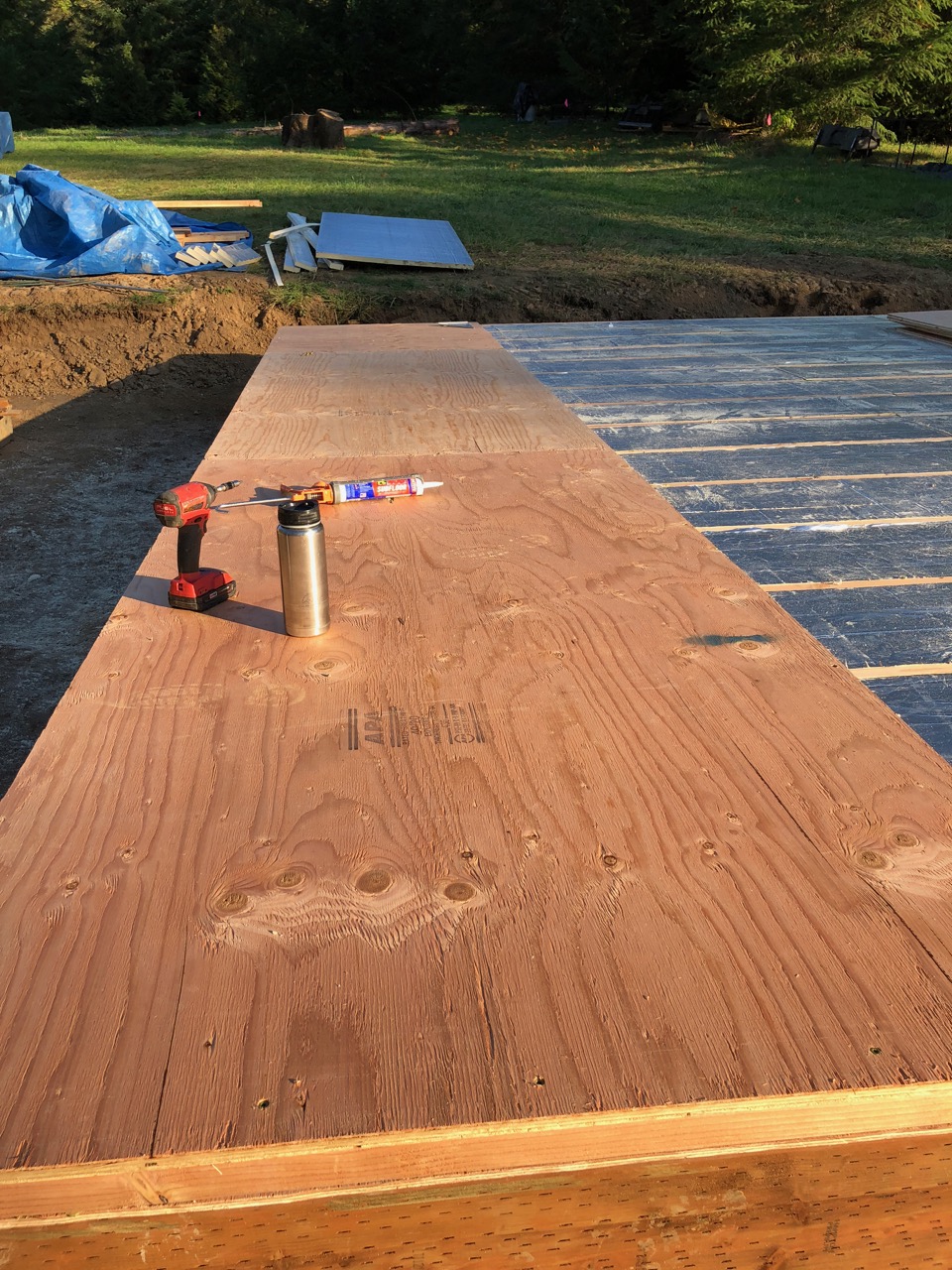

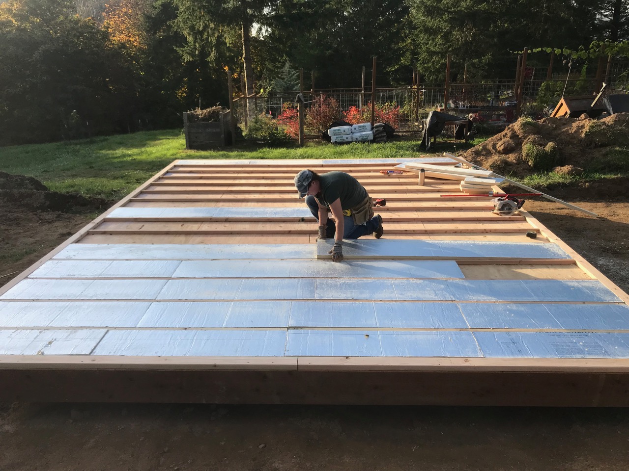

We Framed up the bottom, and the wife informed me she wanted an insulated floor. so we got some 1.5" closed cell, laid down a 3/16 sheathing, but some 2x2's down and then put in some insulation. Then some 5/8 flooring and bobs your uncle.... Oh, I had to fly out at this point for a meeting.

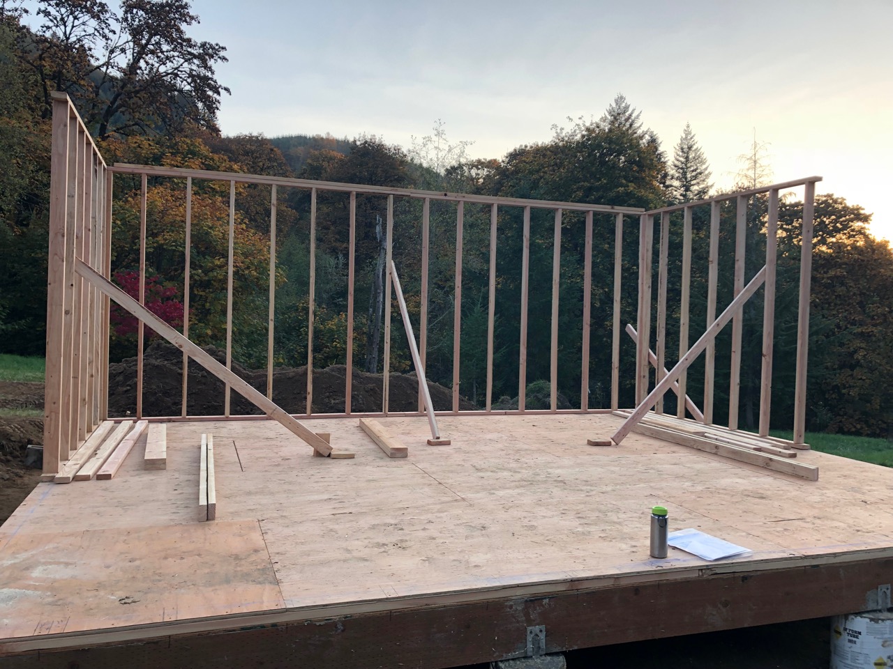

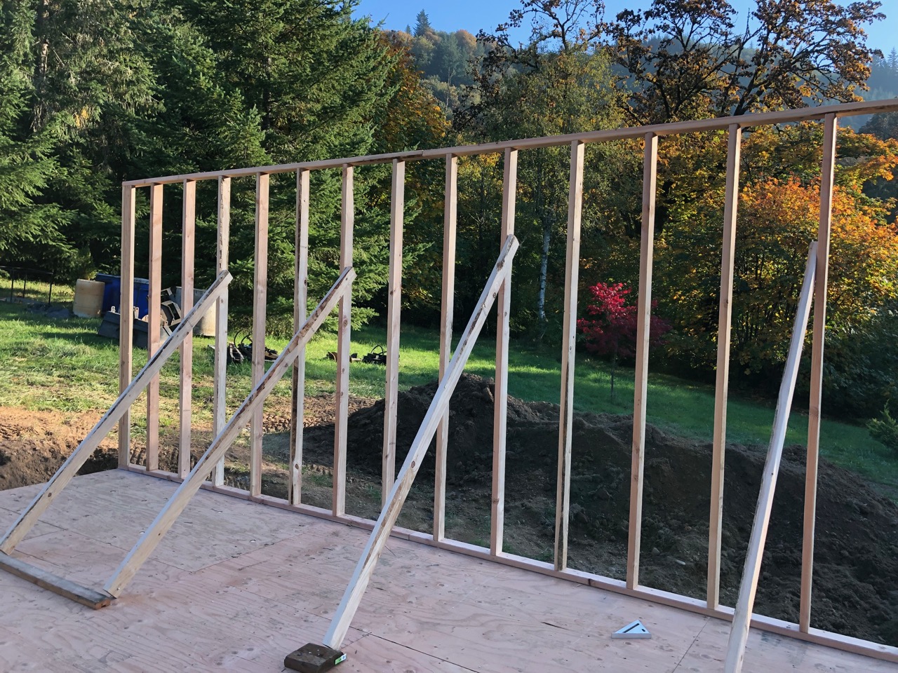

So I got back and to my surprise the wife had made 3 walls. Raised them alll on her own. Pretty impressive I have to say.

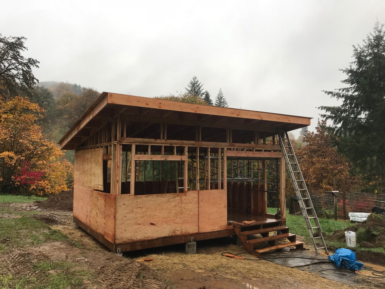

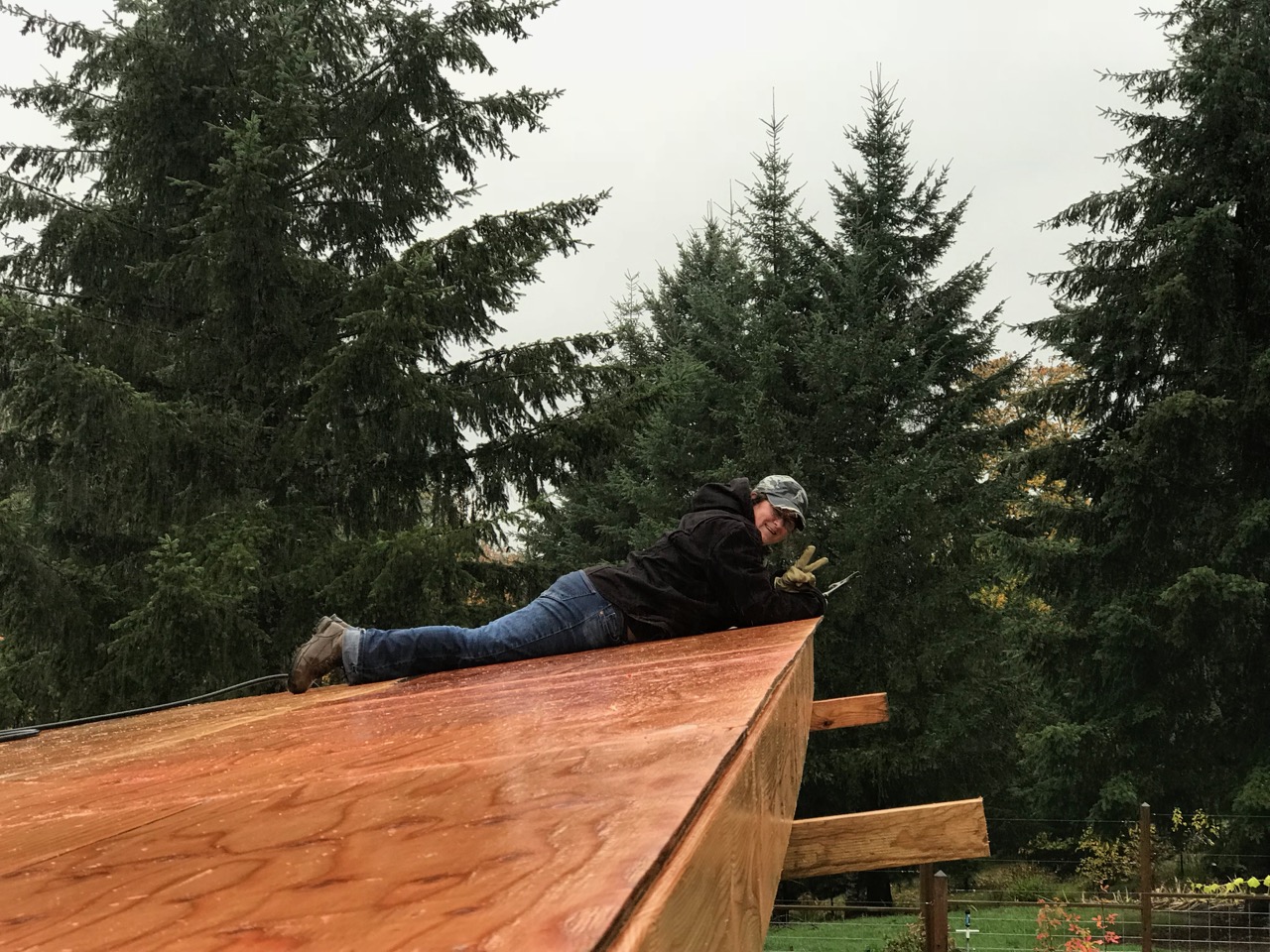

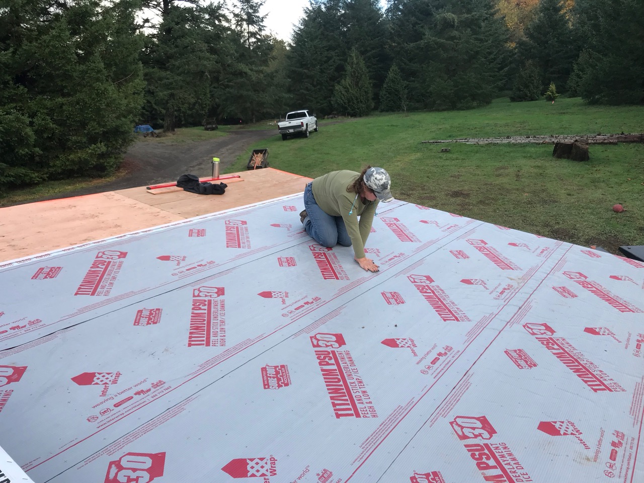

We finished off building the walls, brought the kubota over to help square up and then started sheathing a bit to firm up the building and then got news of impending weather, so we jumped ahead to the roof. Finally today we got on some fancy underlayment that is UV proof for 120 days and Sunday we can return to the sheathing
My hope is by the end of this coming week the sheathing will be done, the wrap will be on, and I will have the front door in and the porch started.

On the framing of the floor. Why didn't you rest your joists on top of your beams instead of using all those joist hangers and building up the concrete so high?

I hesitate to comment about this, especially since it looks like you are doing a nice job and keeping everything really neat. I only want to say a couple of things for others that may want to follow in your footsteps.
When you wish to use foam board insulation in the floors there are two things I would do differently. First I would skip the runners and just run the insulation continuously and then I would use screws all the way through to the first layer or into the joists if wish to try that. If you use 5/8" or greater decking for the first layer then you can just go for the decking instead of trying to hit the joists. This will save time and money and is how I do all of my roofs. I use big washers on my roofs but that is to get the 110 mph wind rating. You wouldn't need that. Second is that I would wait until the building was dried in before adding the insulation and second layer of decking.
I am concerned about the rain water that gets into the layers and how long it would take to dry and what kind of mold and rot that can occur. I would get it closed up at this point and run a dehumidifier for a long time to try to pull the moisture out through the plywood. For sure don't cover it with anything that will inhibit drying until a deep probe moisture meter comes out under 15%. Good luck with the rest of the build. You're going to love it.

I dislike smart people;-) Honestly until you said it I never thought of it. I just followed the plans we were given. And also why take the absolote fun of mixing 50 bags of concrete by hand and pouring them into small tubes deep in the ground.

Ray, great advice. Honestly appreciate it. I am very new to working with foam sheets and the strength of the sheets makes me unnecessaryly leary. I was worried that the sheets would not support so I ran those stringers. As for drying, yeah, we will be water tight very soon and intend to put a propane heater in the building for a day or two.
   / Building a "She" Shed #14
Propane heaters add moisture
   / Building a "She" Shed #15
Propane heaters add a lot of moisture. Get a big dehumidifier from the rental yard. Run it for a month. That will help but test with a deep probe sensor. You don't want to have a building that always smells like mold. The right way to fix it is to remove the plywood and let it dry out. I'm giving you the easier way. You can also pick a spot that will be covered with a cabinet or what have you and use a hole saw to investigate what is going on underneath.
The foam sheets will support lots of weight. Tons
If that is polyiso then the minimum compressive strength is 16 psi.
