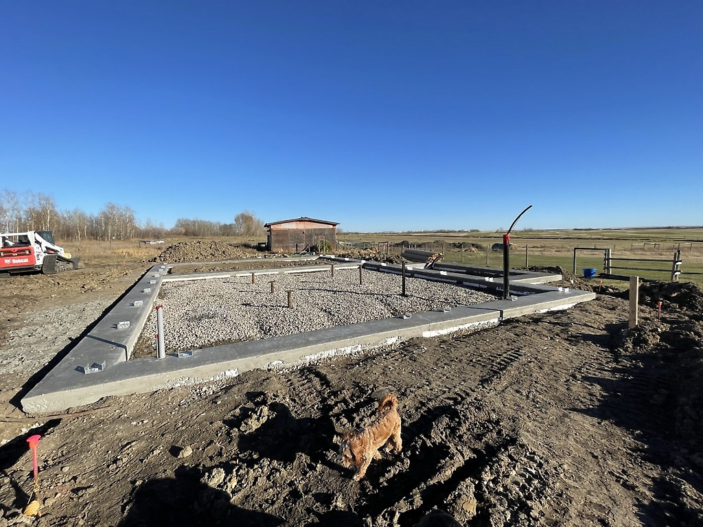

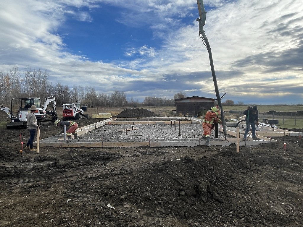

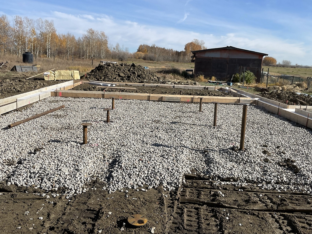

Lost some time due to illness and other priorities - thankfully the weather here has been unseasonably warm.
My contractor decided to add some screw piles into the area for the main slab. His sheepsfoot blew a bearing early in the process and it was backordered by Bobcat for several weeks, so he was limited to his hoe-pack. Given the depths the perimeter screw piles went, he wasn't comfortable with the slab situation so added in 6 screw piles (at his cost) and they all took a 10' extension. Had to do this prior to finishing the forms for the perimeter to get the equipment in.
