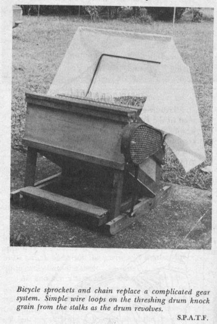

Sorry it has taken a few days to get back, but I have not been on-line. I will contact ITDG (I think they have moved) but would appreciate the title of the book/publication that the photos were in. Old McDonald.
/ Building a small scale thresher #23
Tools for Homesteader, Gardeners and Small-Scale Farmers. Published by Rodale Press and Intermediate Technology Publications Limited. 1978.
I am amazed that this kind of stuff has not yet made it to the web where it could benefit people living in out of the way places.
