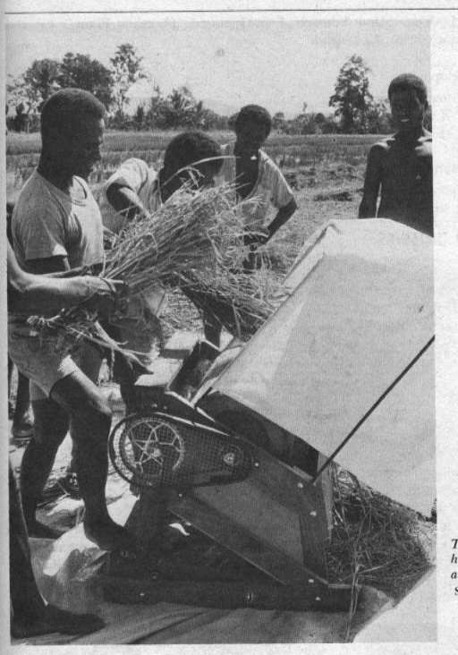

One last picture.

Sorry it has taken a few days to get back, but I have not been on-line. I will contact ITDG (I think they have moved) but would appreciate the title of the book/publication that the photos were in. Old McDonald.
   / Building a small scale thresher #23
Tools for Homesteader, Gardeners and Small-Scale Farmers. Published by Rodale Press and Intermediate Technology Publications Limited. 1978.
I am amazed that this kind of stuff has not yet made it to the web where it could benefit people living in out of the way places.

My sentiments exactly. There is simply no second hand market here (except for trade-in tractors) and anyone with slightly more than the amount of land that can be handled by donkey power is relying on buying new, or. as I have just done, contracting - and that is limited to haymaking. Not a combine harvester anywhere in the vicinty. Reaper binders there are, hence the need for a thresher!!!! Thanks for the other info, and the site looks interesting from a quick glance, I will have a better look later. Old McDonald.
