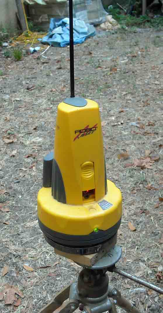

I was thinking of some laser-leveler to shoot from leg-to-leg and cut off the tops, but not sure what to use.
I am also working on an all-steel building. To determine the exact length
of the columns, I use a laser tool called RoboLaser, from Toolz. I bought
it when it first came out back in the mid 90s, and I used it extensively
to get my grades correct in digging the foundation for my house.
It is a motorized self-leveling laser that is remote controlled. It sends
out a dot that is visible in daylight (no special detector needed). The
remote turns it on/off, and rotates the body of the unit. I mount it
in one location on a tripod and mark where the dot hits my columns.
Toolz is now RoboToolz, and the device has been improved. There is even
a super-bright green laser now, good for 300 ft, instead of only 100 ft.
You can find the older tool used, or pay $100-150 for the newer one, new.
Several people I know bought these after seeing mine work, and how
reasonable it was.

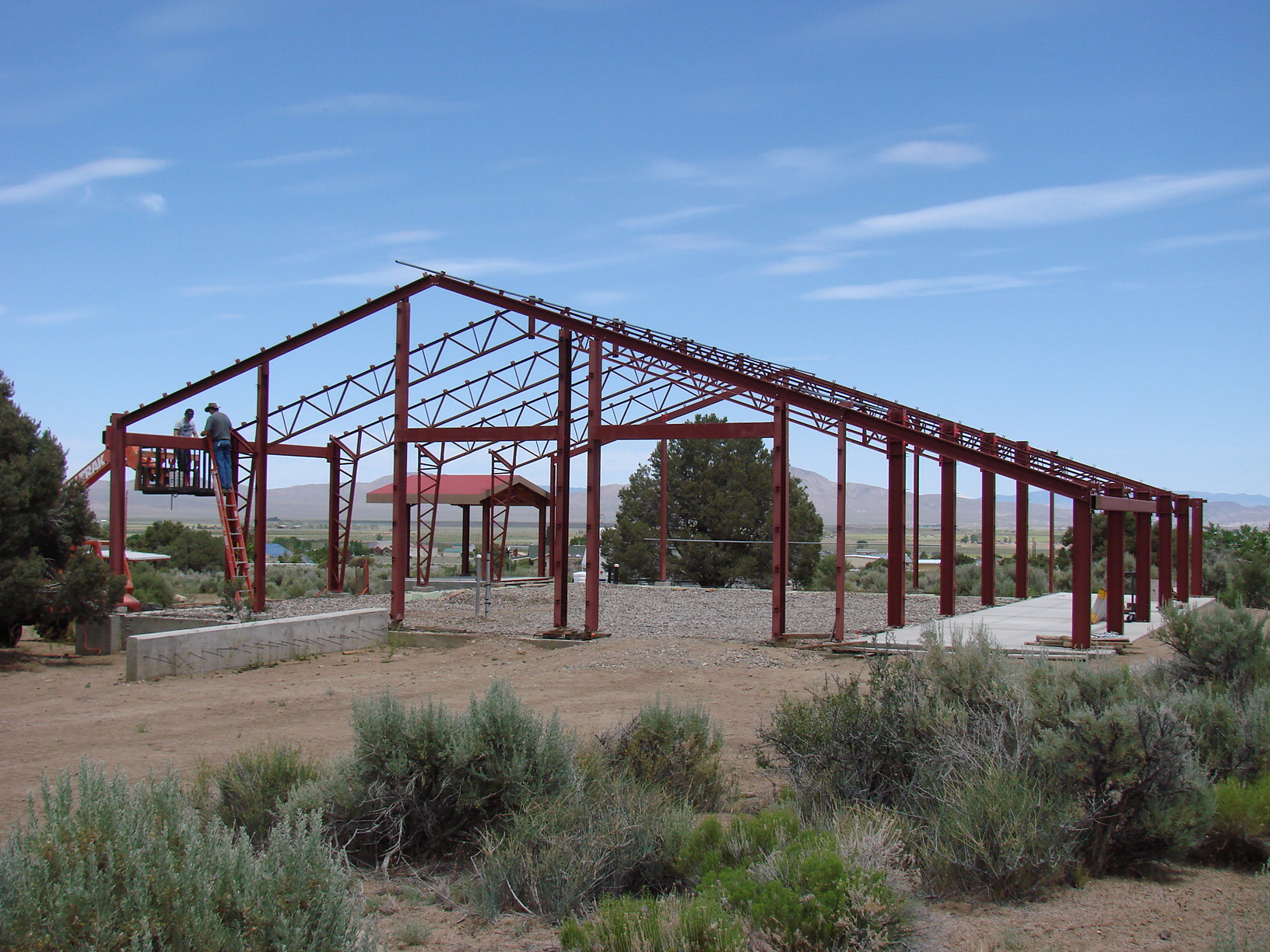

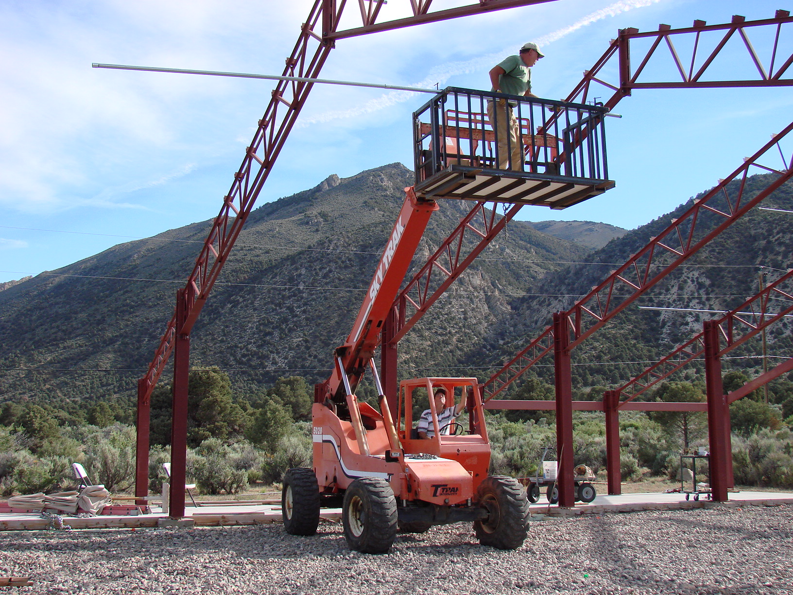

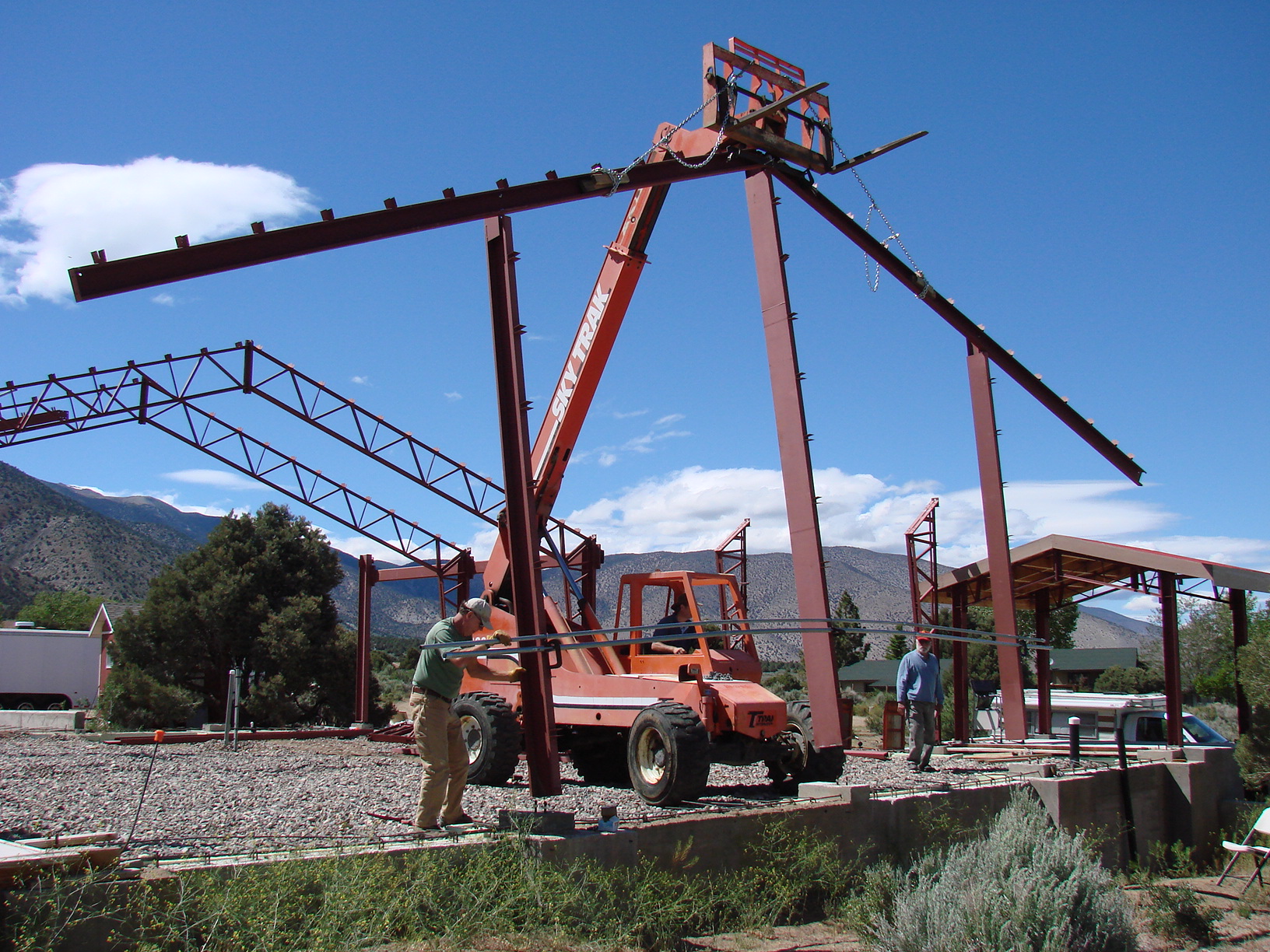

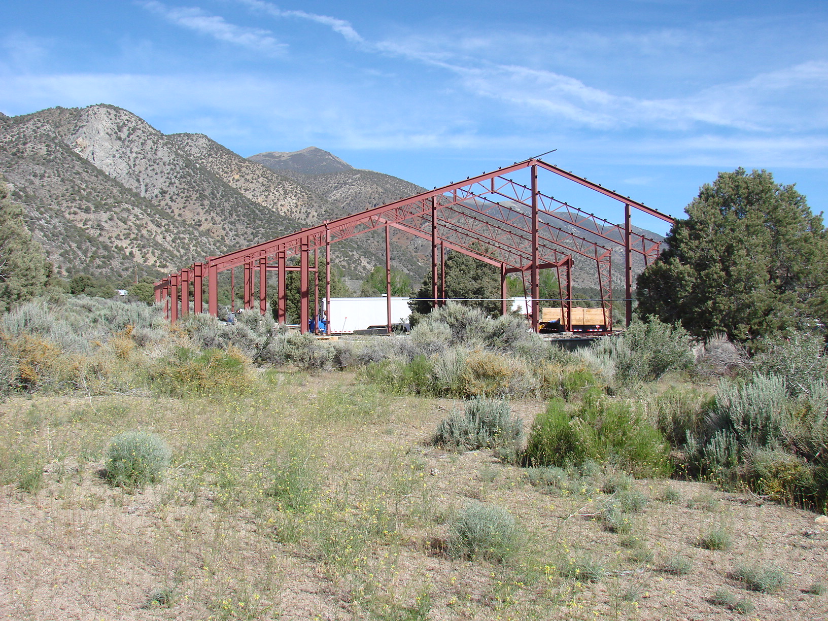

Here are some more pix of our project. Next is the roof.

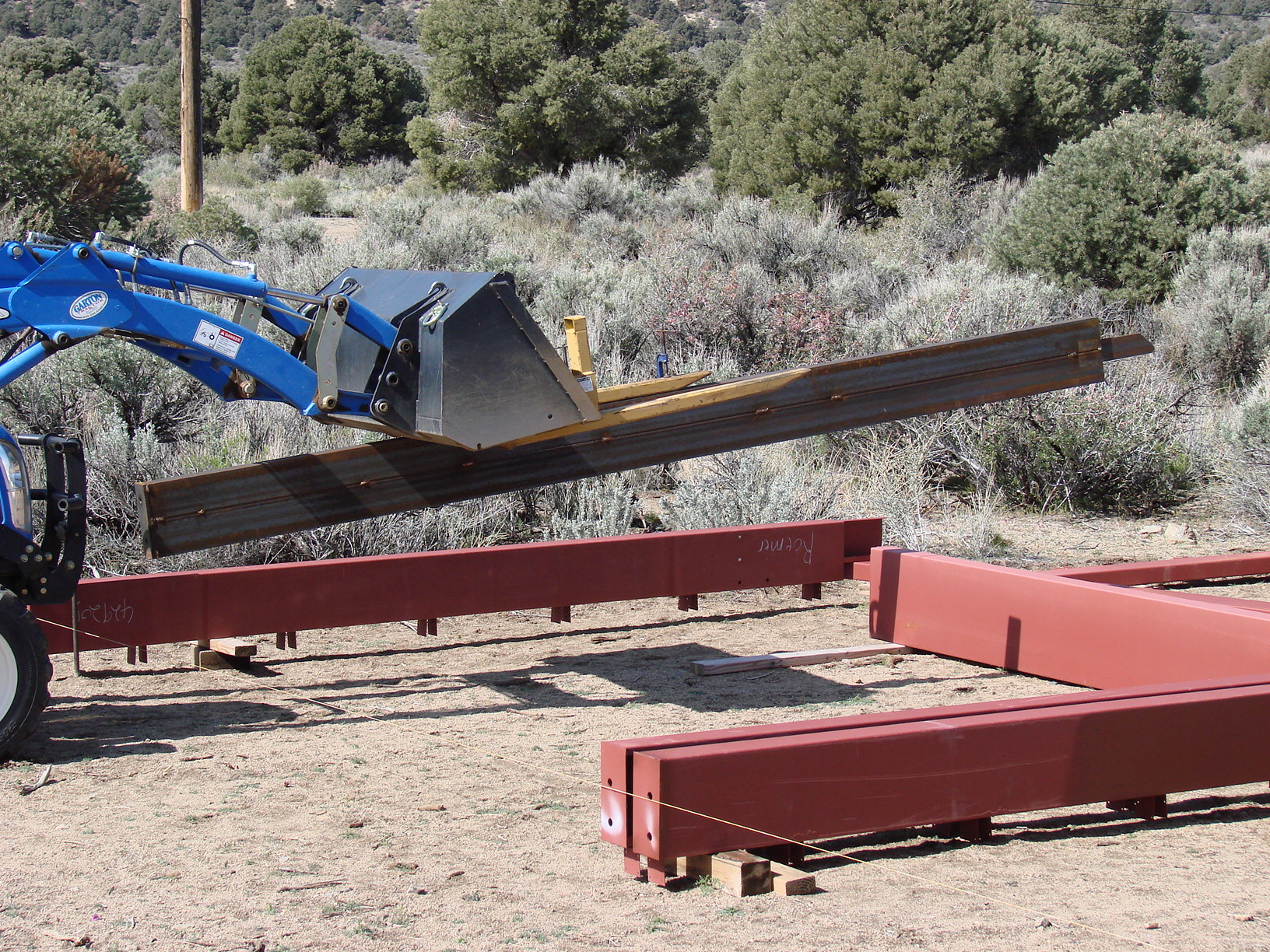

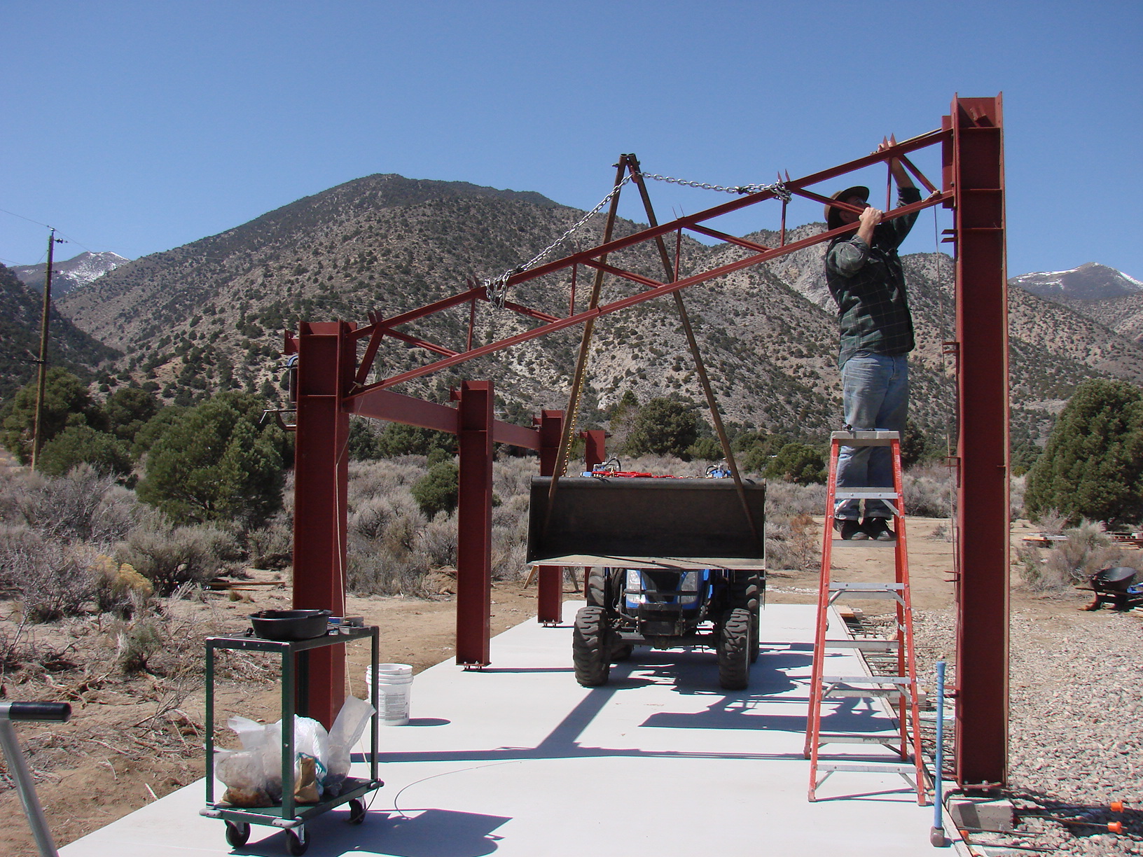

Some things that have really been helpful with this project are the basket for the forklift made from scrap steel, the A frame in the tractor bucket made from 1 1/4 inch pipe and chain, the tractor which has moved many, many tons of material, dug the foundation, dug about 700 feet of ditch, dug the septic tank hole and graded the whole area.
