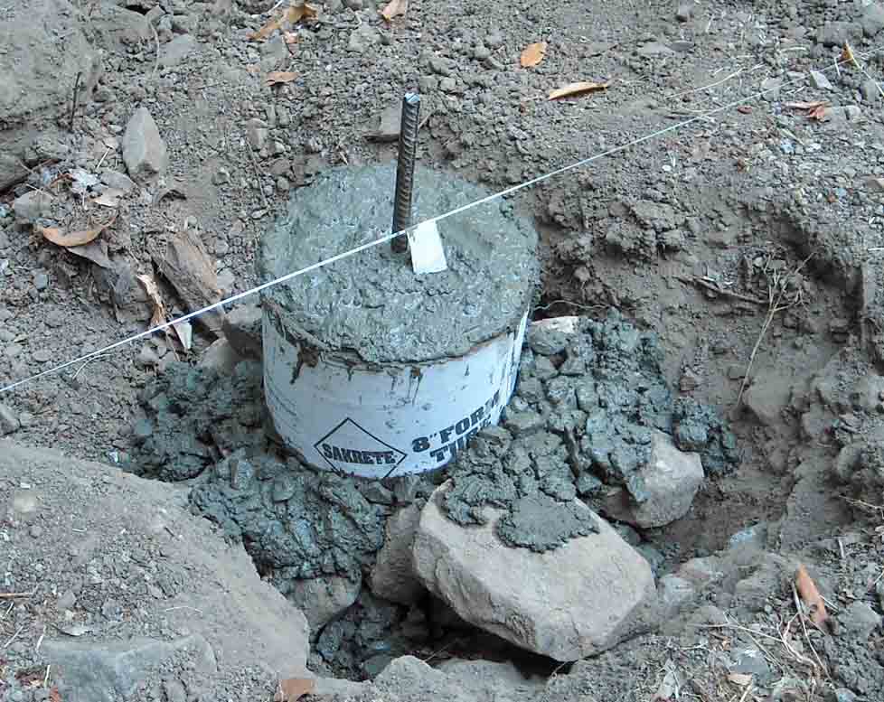

   / Building a Steel Barn #26
There is no right or wrong way to do this, but some ways are easier than
others.
If you wet-set the columns, then mark them for height, they have to
be field-cut for final length. That process is fine for wooden posts, as
you might do for a fence or post-and-beam building.
For steel, the final cuts are harder to do in the field. What I do is pour
a footer or concrete tube column in the ground, then set the steel
columns on the hardened footer. Then I place a reference mark on the
steel column using my laser. I then remove the steel column and cut
horizontally with my bandsaw. Replace the column over the rebar stub
and pour some concrete inside it to anchor it.
In the photo, this foundation is for a building that will use schedule 80
steel pipe for columns. I have also done it that way with 4x4 steel
tubing 14 feet long for my deck. The down side for my method is you have
to set the columns twice. My columns are inline and matched in height
by +/- about 1/16".
