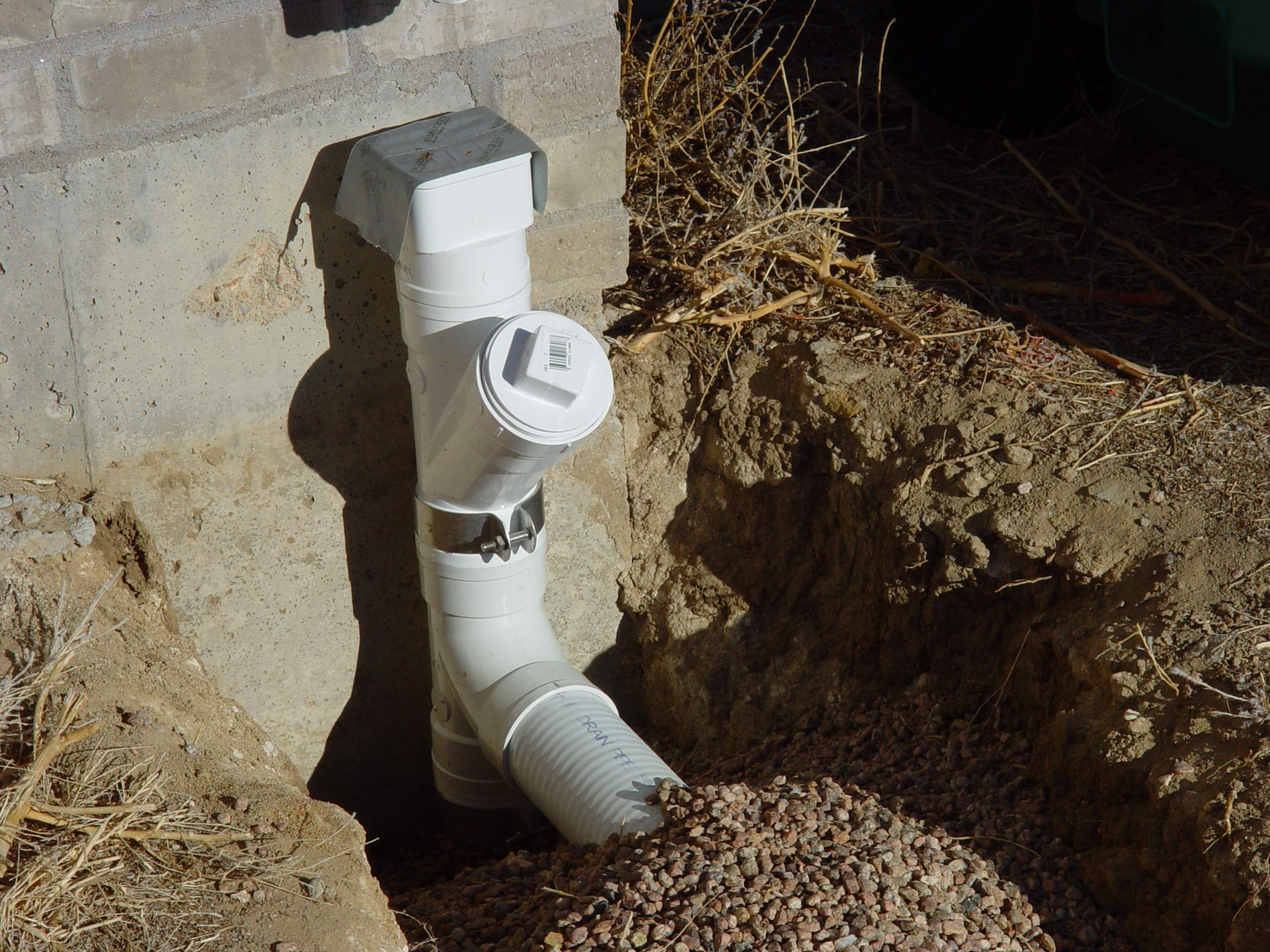

This is what I recommended to Obed to help clean-out any debris that might get caught in the drains. I would turn the wye to be parallel with the house though.
I did something very similar to what you did; but I added a dirt boot that I can shove a small bore shop-vac hose in the cleanout to suck out debris.

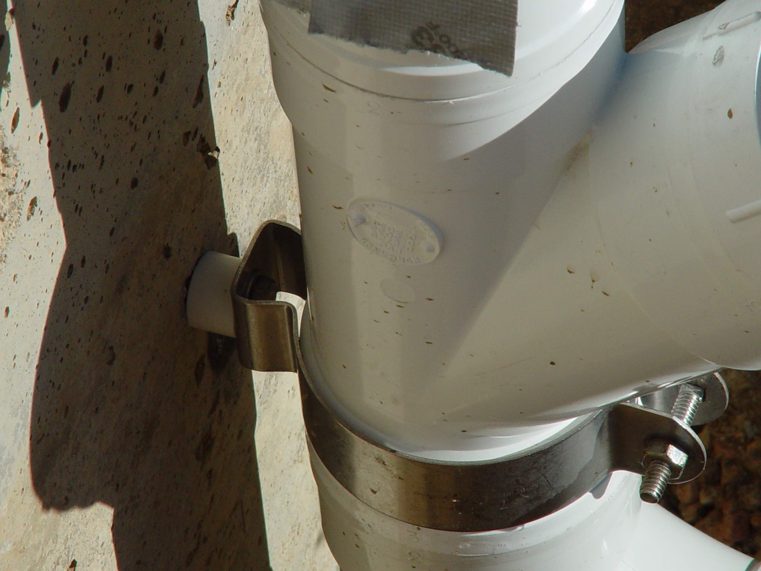

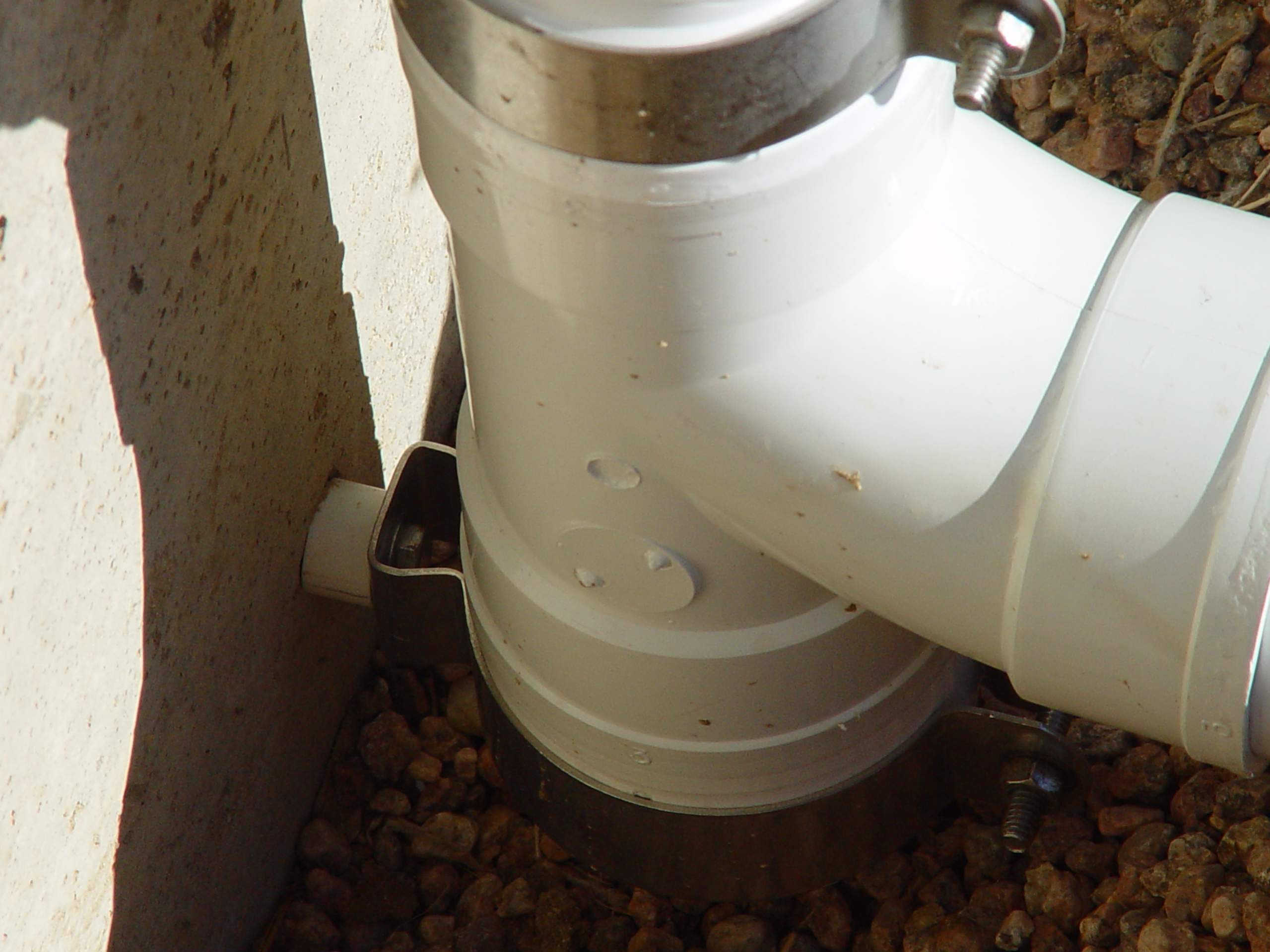

mjncad, that looks really good! Where did you get those clamps/straps you used to tie the drains to the foundation?

The rule to keep in mind in any waste or gravity flow piping is to keep the curves/bends to a minimum and as gentle as possible.
There are elbows known as "Lazy Els" that make a 90 degree turn but over a larger radius with less tendency to clog and easier to clear if they ever do.
Using 2- 45 degree or half els with a straight piece in between accomplishes the same thing, just like the way a downspout leaves the gutter. Had a 90 been used up there and another back at the house you would create certain clogging.
If you don't glue the rectangular to round transition piece to the top of your soil pipe it is very easy to unscrew the downspout screws from the hangers and remove the downspout for a more direct access to the elbow in the ground below it without any visible Y stub sticking out from, or against the wall at ground level. The 3 tight elbows under the Y fitting shown in the picture of, I think Obed's house, is just designing in a big clog area. All those sharp corners could have been eliminated by using two 45 degree joints with a piece of straight between them, making the Y clean out superfluous and the natural flow a lot better. When the final grade fill is done a lot less pipe is exposed than having a Y sticking up above the soil. On a one story house all the downspout holding screws are usually reachable from a step ladder. If the ones at the gutter hole stub are hard to reach you can just leave them out as the diagonal run of the downspout will hold it in place.

The clamp straps mjncad show in his pictures are for electrical conduit.
They can be adapted for many purposes and have a variety of mounting accessories.

If you don't glue the rectangular to round transition piece to the top of your soil pipe it is very easy to unscrew the downspout screws from the hangers and remove the downspout for a more direct access to the elbow in the ground...
Ron
I do this on mine. The adapters are not glued to the underground pipe, there's no pressure so they don't leak or come undone. When it's time to clean them I just pop the adapter off and can easily stick in a hose or snake. It is a cleaner look than the 'Y'. As a preventive measure I stick a hose down each one every spring, I've got gutter guards though and barely ever get anything inside the gutter or pipes.
