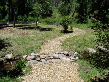

Will also need to look into adding some dirt banks or something at the driveway entrance to divert the water away from coming down the left side of the driveway and down behind the shed.
put a small mound in drive called a water bar to direct water were you need it to go.
or some thing like this to keep it flush
