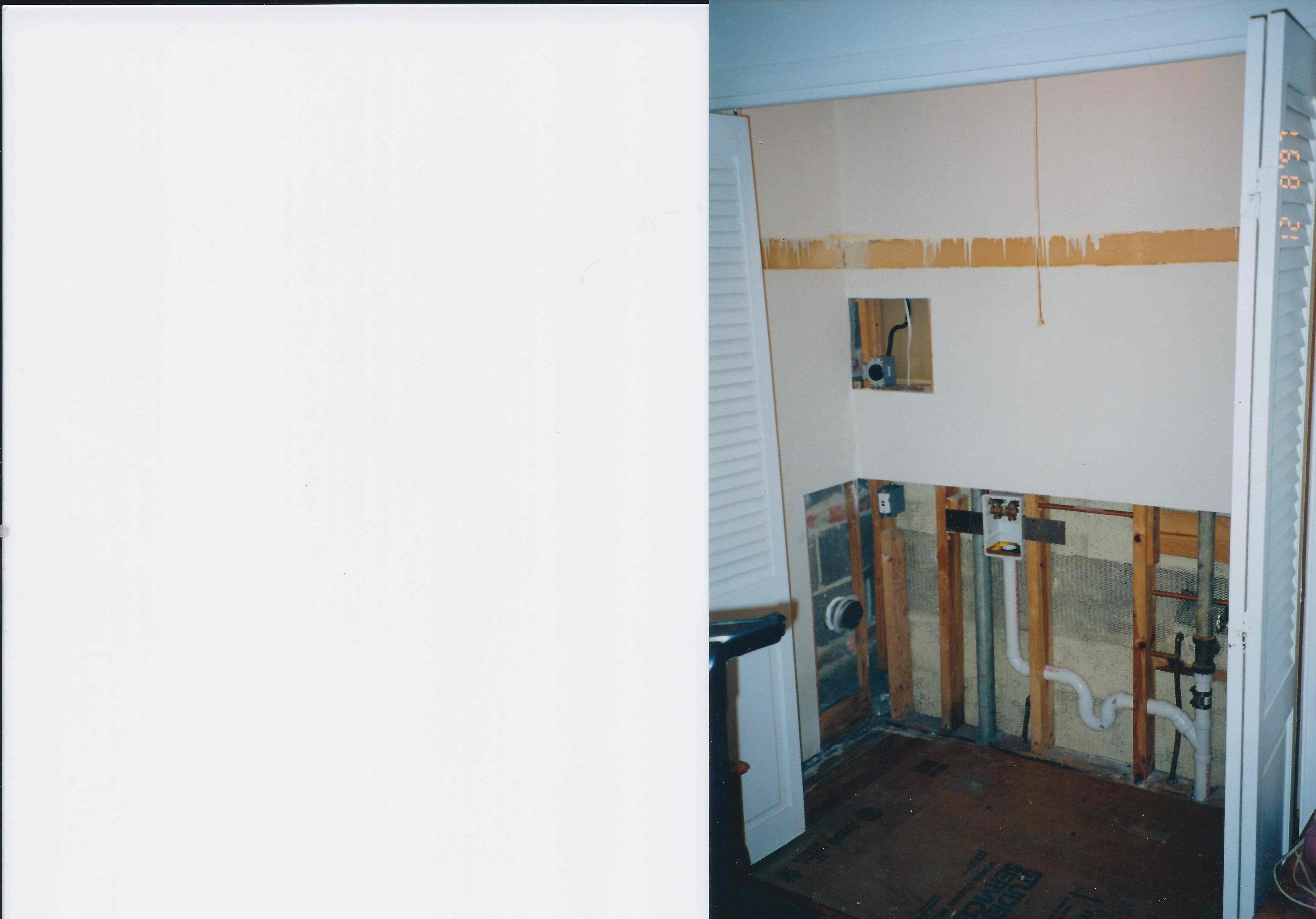

Attached is a picture of my drainline for the washer that I installed way back in '97. When I previously briefly hijacked this thread for my soffit vent question, I got some really good suggestions. While not optimal, the setup in the picture has worked fine for nearly 16 years.
I suspect the issue is with a combination of liquid fabric softener and hair at some place in the PCV piping I installed. As such, I have used an entire 32 Oz. bottle of some seriously strong drain cleaner - it came as a bottle packaged within a bag. I am going to let that sit overnight and rinse with hot water tomorrow.
If any of you plumber types has clever suggestion, I would greatly appreciate it. The next step, as I figure it, is to get my large snake out and try that. The problem is that my snake is quite large so I am not sure that I could push it beyond the trap.
-Stu

Stu,
Is this laundry closet on the main floor of the house? Looks like concrete block on the outside wall.
Is there a basement or crawl space under the floor where the pipe goes down?
If the drain cleaner doesn't work and doesn't eat your pipes you might try an electric fish tape or a piece of solid copper wire if you have them.
The problem may move to an underground part of the pipe if/when you break the clog loose.
In any case, be careful of working on the pipe with the chemical drain cleaner still in it. Wear goggles and rubber gloves.
Since the vertical pipe has a rubber cheater sleeve connection on it, you might take that apart to see if the vertical drop is still clear.
If it is clear and snaking past the trap doesn't work, you may have to cut off the horizontal run with the trap and replace it. You can do it.
Ron

Stu,
You could replace the trap with a cleanable trap--if that isn't one. Use the cut where that fernco is installed to put in a clean-out wye?

Ron, what looks like a concrete wall is actually the bathroom on the other side and yes it is on the first and only level of the house. It is one of the old ones that used wire mesh and metal to set the tiles in. I have a conditioned crawlspace beneath. This drain dumps into a 4" CI main drain - I think it is only 1.5" PVC.
To be clear, I don't really have a clog per se. Instead, I have an obstruction of some sort that does not allow the water to drain quickly enough. These modern front loading washing machines dump water at a scary fast rate.
Dave, thanks for the tip. I am not clear on how that would work since this is in the wall and covered by drywall.
Now that I look at the pics I took so many years ago, I am not sure why I chose to tie into that drain (vanity sink on the other side) as opposed to the main vent pipe which is literally right there next to it. Either it is an optical illusion or that is a larger pipe anyway.
