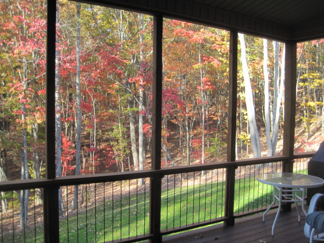

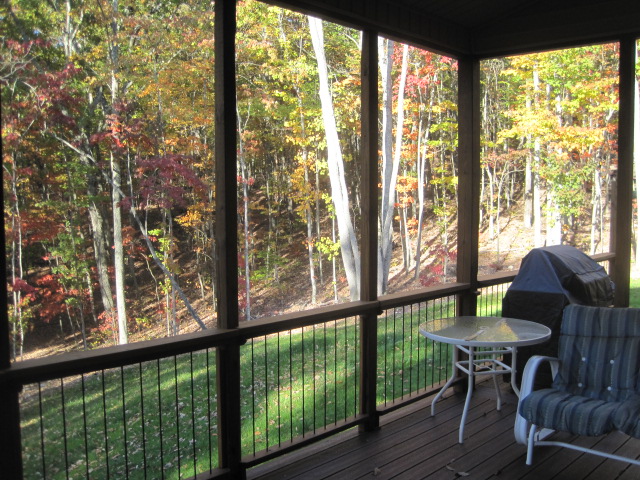

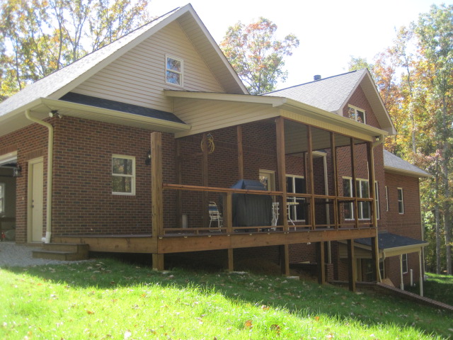

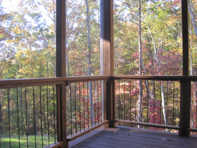

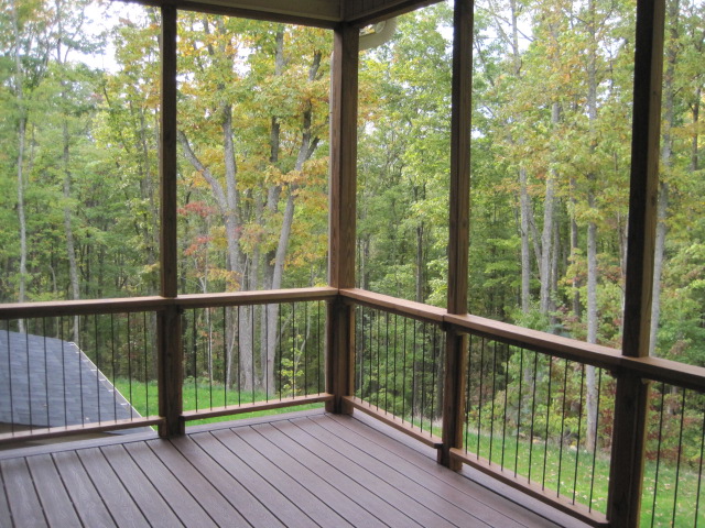

We built our deck using Trex. We really like it. We just finished the deck this past fall so I can't yet speak to the mold issue. Trex is expensive.
We were considering the cable railing like you are considering. That stuff is expensive. We wanted something that would not obstruct the view from the deck. However, we visited a friend's house who installed something similar. The first thing my 2 1/2 year old girl did was start climbing it. The horizontal cables are easy to climb. That made up our minds that we couldn't put that on our deck because one end of the deck is 12 feet from the ground. Counting the railing, if our daugher climbed the railing and fell, it would result in a 15 foot fall.
Instead, we installed vertical steel rods that we got a paint shop to powder coat. The rods were much less expensive than the cable railing but looks as nice, maybe better. We are extremely pleased with the results. The view is not obstructed and our now 3 year old girl cannot climb over the railing. Our porch building project is documented in my thread that is quoted in the links below.

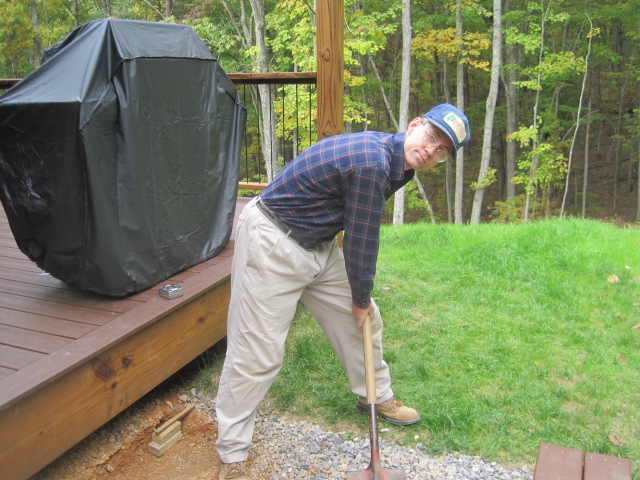

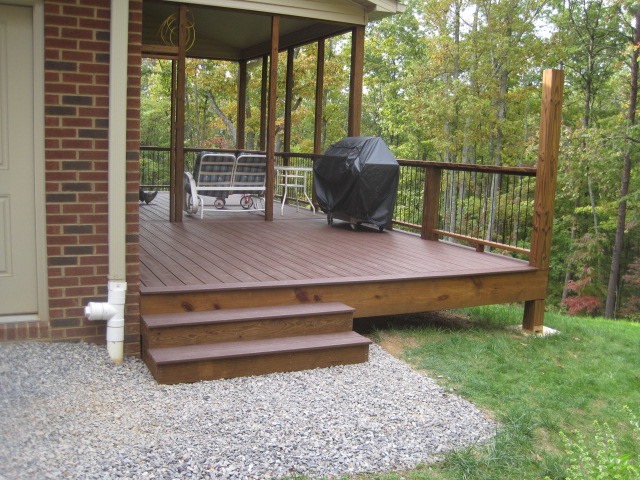

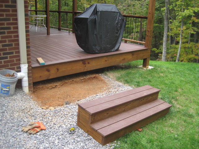

On Saturday I took the day off and went whitewater kayaking. When I got home I discovered that my wife had moved the steps and started the prep work for putting the steps on their final base. She scraped off the gravel and dug out some red clay dirt. I took over and finished the job. I added gravel to provide a level base that would give the steps the correct height. Each step is a 6 1/2" drop. After leveling out the gravel we sat the steps in place. They feel rock solid when walking on them.
Also, you can see that my wife has finished staining the posts, railing, and rim joists. She also stained the steps.
We will take a break from working on the porch and deck for a while. At some point we will install removable screens on the porch.

Fall Pictures
I've enjoyed the fall colors tremendously this year. It helps not to have a bunch of projects with deadlines hanging over my head so I can look up and smell the roses. This is the last week of daylight savings time. Getting stuff done outside slows down this time of year with the shorter days. I guess there's a reason things are designed this way.
attachment.php

Stu,
We used 110 2 5/16" dia. steel rods at about $1.30 per 3' rod. In addition, I believe we paid $1 per rod to get them powder coated black by the paint shop. These are numbers are from memory but should be in the ball park.
Obed
