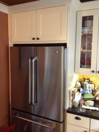

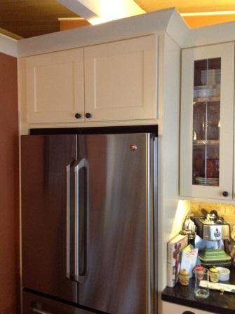

I don't know about others...but I love counter-top-depth refrigerators. They have their cons - more $$ (at least they used to be), less space (inside fridge), and less models to choose from...but I love how it keeps the fridge from 'intruding' into the kitchen space. Plus, it looks like you will have a walk-way in front of your fridge, and the doors don't come out as far as a traditional model, which would be nice in front of a walk-way. OR, you could achieve the same look by recessing a standard fridge into the wall behind it (kind of like some medicine cabinets in bathrooms). It can look perfect, especially if you box/frame in the fridge.
Also, I know it is a 'crude 3D model of the kitchen,' so it might be dealt with already, but I would consider the following regarding your fridge. It looks like it is tucked up right against the wall. This can cause issues for opening the door (or opening it far enough to pull out drawers/etc.). A nice solution (which does require taking some space - like 3" or so from the length of your counter), is to 'frame in the fridge.' You basically install a small filler strip (say 1 1/2") from the floor all the way up to the to the top of the wall cabinet on the wall side of the fridge, while on counter side of the fridge you install a pre-finished piece of plywood (including filler strip). It is kind of difficult to explain, last pictures might help, but I bet your contractor/cabinet supplier will know. In fact, it is shown, although hard to see, on the website of your cabinet guys - you don't see the side of the fridge this way...so clean, neat, and looks more 'finished,' IMO.
Lighting (both under cabinet and over cabinet) is AWESOME...very functional (at least under, especially with dark counter tops...great for young and old eyes alike), very nice for indirect lighting, they make great night-lights (your mom gets up for that late night glass of milk), consume next to nothing (LED strips), and are CHEAP if installed before the kitchen walls/cabinets are finished. An earlier post referred to this type of lighting for the stairways I believe. It is the same thing...as he said, make sure you get the right color (warm-white unless you want that hospital feel :().
I am attaching a couple of photos of my kitchen. Notice how you don't see the side of the fridge (counter side), and while I didn't shoot the angle very well for this, you can see the filler on the left of the fridge (hope it makes my previous explanation easier to understand). The first has my upper lights off, the second has them on...lower lights on for both shots.
