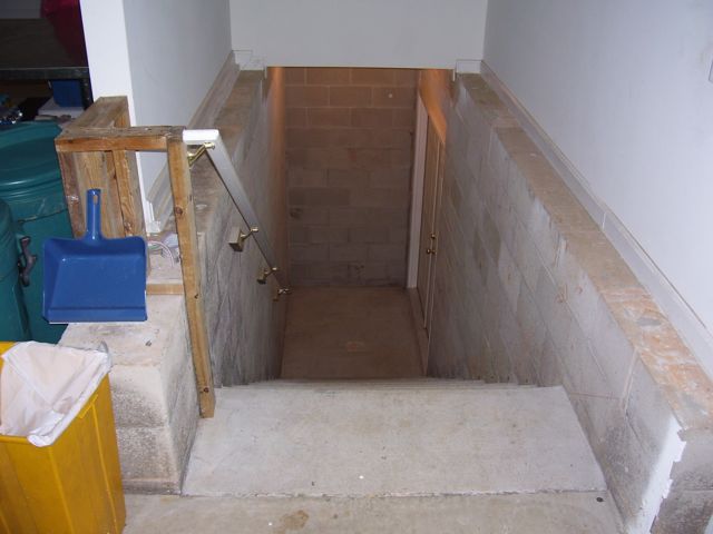

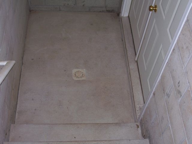

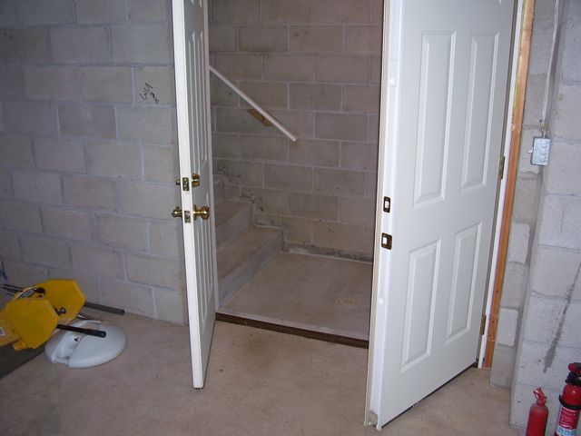

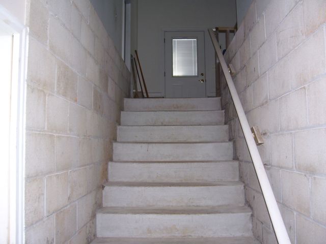

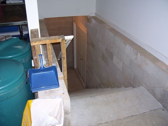

Pete, FYI here are a few pictures of my cellar steps from the attached garage to the basement. The steps are approximately 4 foot wide and I have a double door in the basement level that opens up for wide objects. The builder also put a drain in whenever I hose the steps down. I believe the drain goes to the sump pump. Just an FYI for ya!! Stanley
