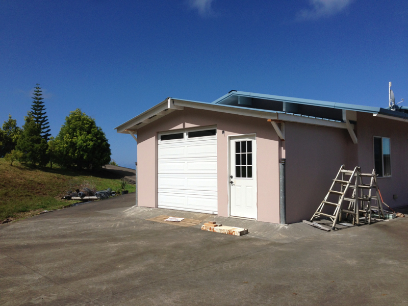

Pacerron, you are absolutely correct about having a personnel door. The 3rd picture in my post prior to yours shows an entry door and then you can go right into the basement or open up the large garage door if you wanted too. Gotta have a single entry door though.

There will still be a personal door. It has just not been cut out yet. Was waiting on the stairs to get done to know how far in from the corner it can be.

Pete,
Your latest pic day 51-5 shows all the windows cut into the garage.
It looks like you have eliminated the original door out the back to the patio, possibly because of the
stairs to the basement?
How much distance are you going to have between the top of the steps and the sidewall of the garage?
Since you are going to have your Genset on that side of the garage near the meter box you will probably have a concrete
pad or walk along there.
I do not like garages without a personnel door.:thumbdown:
Having to raise the double door to get outside from the garage every time is a pain even with an electric operator.
I would think your mom would like having a personnel door to let the dogs in and out, to come in from gardening to the mud room, read the meter, etc.
Living by herself on that back road she may prefer leaving the garage door closed while she is at home, even with the dogs for protection.
I have attached a quick mark up of your pic showing a personnel door where you now have a window.
Would that work?
Excuse my sloppy perspective; I only had 5 minutes to play with the pic.
Ron

Pete beat me to it as I was going to speculate that the door wasn't cut in yet. I thought the mandoor was going to be on the wall leading to the terrace by the corner I suggested earlier that he locate the AC condenser.
Going out the back to the terrace was the original location.
I would still prefer it there, ( yes, my personal preference !) but there could be some safety issues, as well, if the door located on the back is very close to the top of the stairwell.
The door would normally swing in with the hinge side away from the stairwell. Coming in from outside often leaves us old folks a bit blind for a little while until our pupils finally open up. Falling down an open stairwell immediately to the right of the door opening could be a potential hazard that is not necessary.
The space between the door hinge side and the Genset wall has to be pretty much left open anyway so the door can swing back against the wall it is mounted on, Mounting the door in the back corner so it can only swing 90 + degrees against the inside of the Genset wall may fix the problem of being too close to the stairwell but the area still must remain clear. That is why I asked Pete for the distance from the top step to the Genset wall.
Some counties now require a dam to keep liquids and volatile gases from going down the stairs into the basement along with a metal door with special seals at the basement level. If this is required in Nelson county, then the area between the top of the stairwell and the Genset wall will have to be poured another step height, 6"+ higher than the garage floor.
A lot depends on blending the final landscape height with the door locations as well. The plan calls for a stamped concrete deck from behind the garage
to almost the back end of the house. It will likely be poured at a level below the wood joist plate on top of the concrete prefab walls. Then the wrap around wood deck will be up a step to an inch or so below the first floor door bottoms.
Steps, stoops and other tripping hazards are not a friend to us as we age.
You can see by looking at any of the pictures showing the front of the garage that there is a bunch of fill yet to come before any apron or deck pouring begins.
Ron

Uh-Oh.........
I should have looked at all the pictures. This one shows that there is only about 48" between the Genset wall and the first step.
Since the meter box is already set where you want it, it looks like the personnel door needs to go up where the window is close to the front on the garage sidewall.
