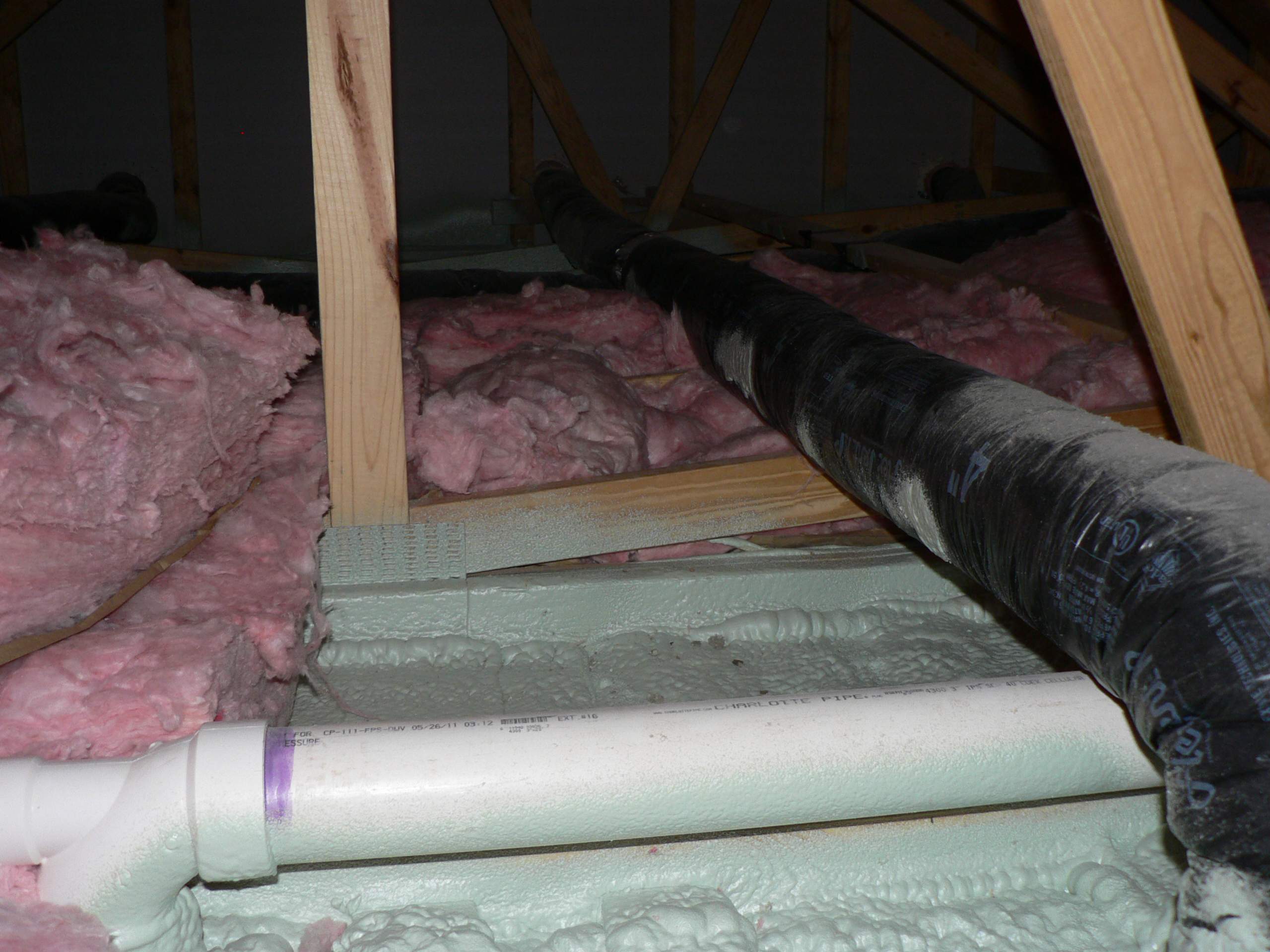

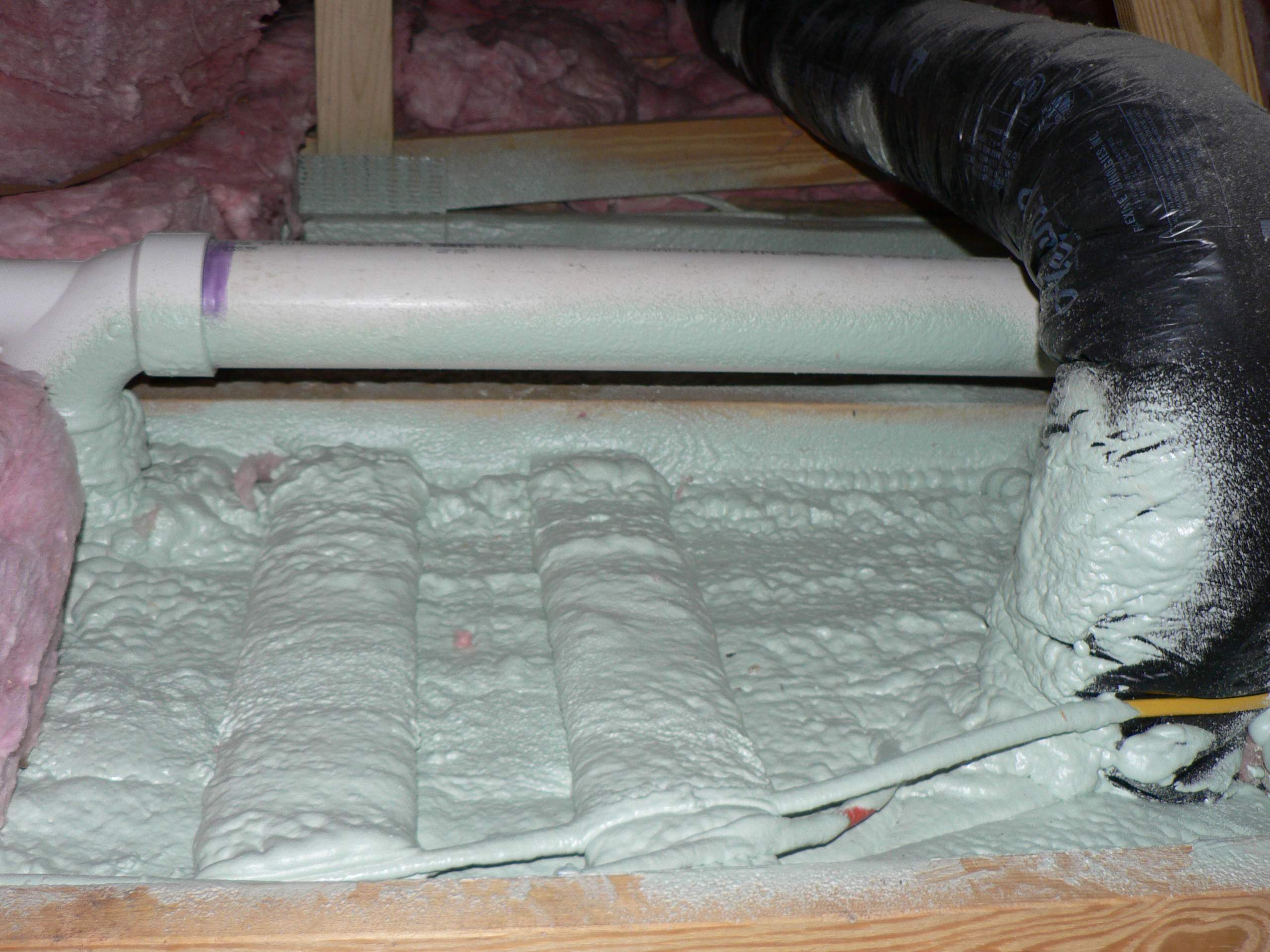

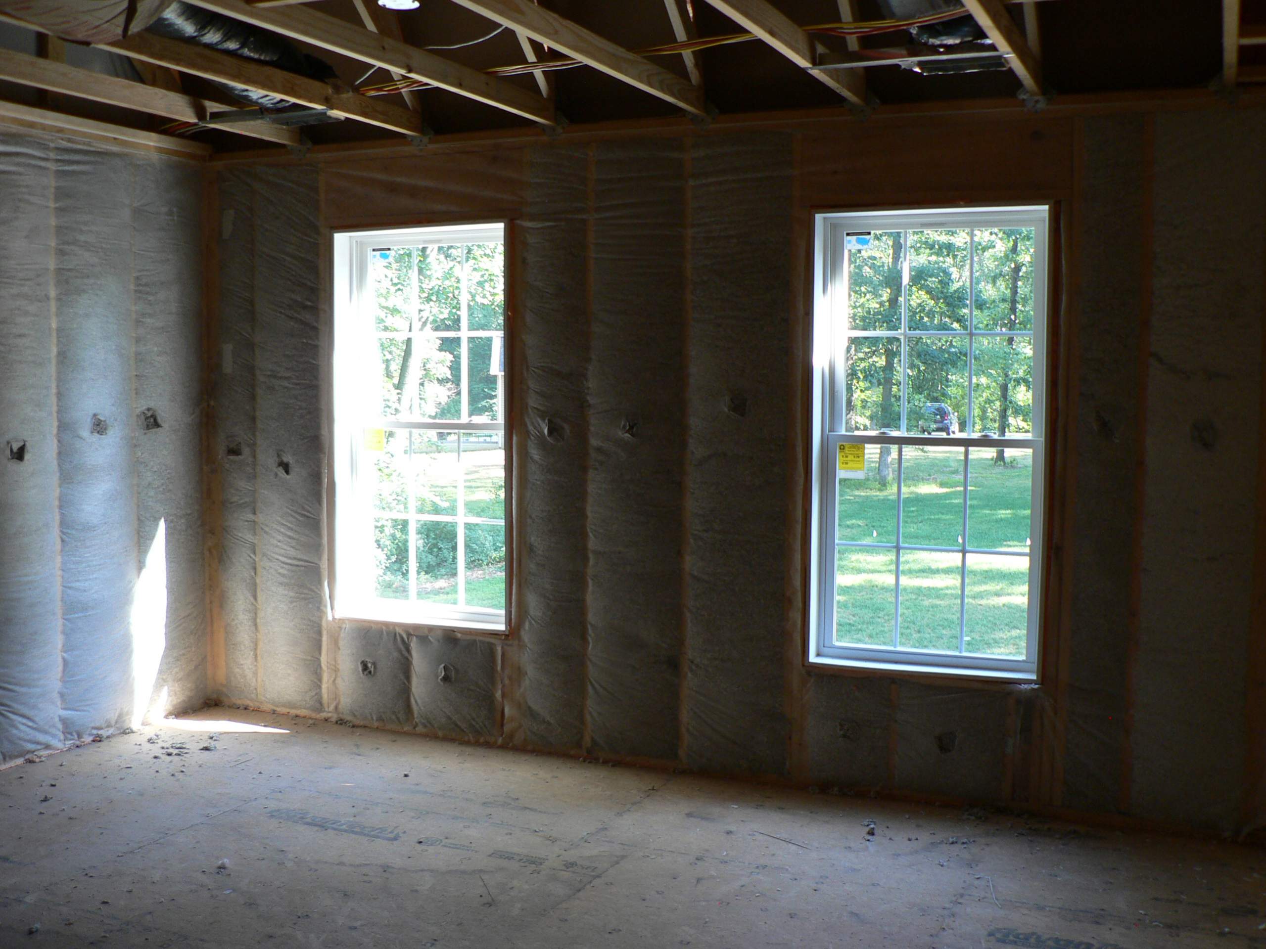

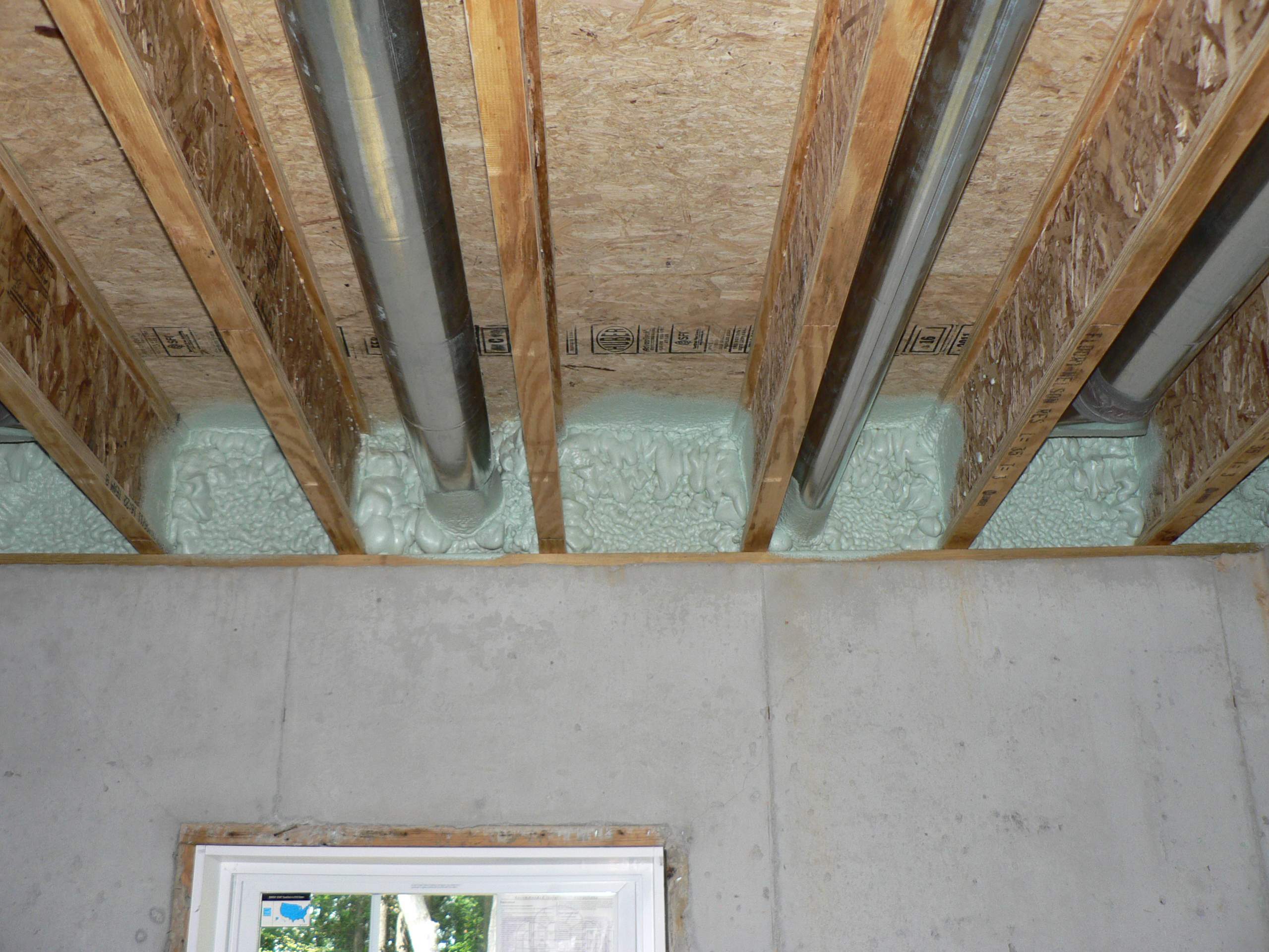

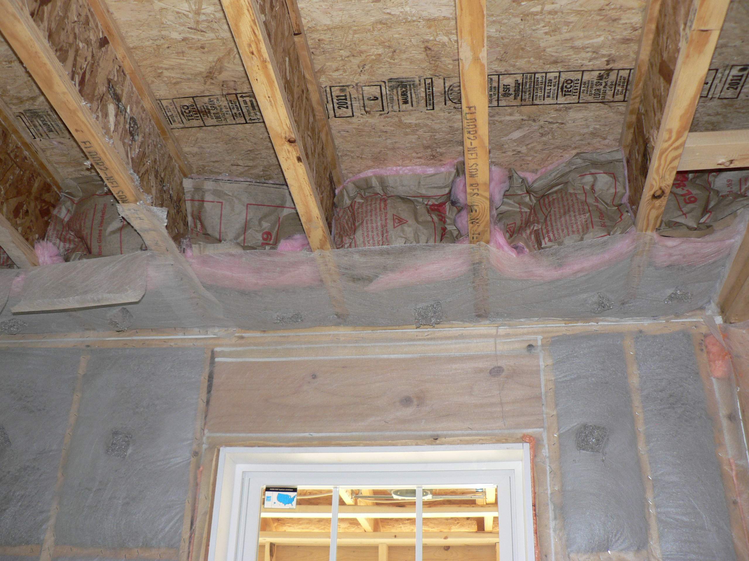

I have been following this thread for a few weeks now. First let me say how much I enjoy the topic. I am enjoying the pictures and the suggestions. But, I do have some thoughts on insulation. We have been in our house about 18 months. As many have said, I was very concerned about energy costs. We used a structural insulated sheathing STYROFOAM SIS? (U.S. Residential Only) which contributes an R value of 3. Properly installed, SIS provides a great air intrusion barrier. But, as you know, all of the rough-ins compromise that barrier. So for the band boards, I had an inch of closed cell foam blown in.
We used 2X6s for the exterior walls. The walls are insulated using a tight pack (also called dense pack) cellulose.
Then, for the attic they sprayed another inch of closed cell foam (R-6) on the "floor". And then blew in R-49 in cellulose.
Note, the fiberglass batts were there from the sprinkler install. The county required the batts over the sprinkler runs. Then the insulation guys moved (and replaced) that fiberglass to spray the closed cell foam. And then ultimately blew the cellulose over the whole deal.
I am very pleased with how tight the house is. We are in central MD so we do not get super cold weather. On a day in the teens, I can go around to exterior outlets/light switches and feel no cool air. In my old house, I bet I could have blown out a candle!
As others have said, I would consider some of these options over doing standard fiberglass batts in the walls and just blown-in insulation in the attic.
