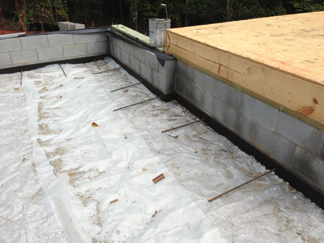

Pete, will the stone in the garage get vibrated down prior to the concrete pour? Stanley
I asked the builder about that today and he confidently stated that #57 gravel self compacts and that there would be no point in vibrating/compacting it further... Not sure, but I know who to call now if the floor ever does something undesirable. :D
He is right in a way, though the 57 does need to be spread the right way for it to settle/equalize, and you have to assume the base is solid!
When they did the garage on our new house, they spread the gravel (a little smaller than #57) and worked it in to make sure it settled, but did not vibrate. Then they drilled holes in the walls all the way around and stuck in short rebar pieces before they poured the slab. This still lets the slab float horizontally, but won't let it move vertically at the walls, and should prevent cracking if there is any minor settling. The builder said they have been doing that in this area for about the last 4-5 years, and it has really cut down on issues.
