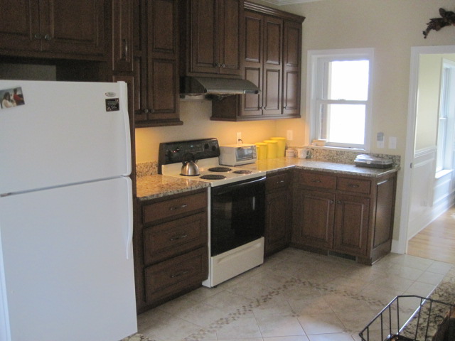

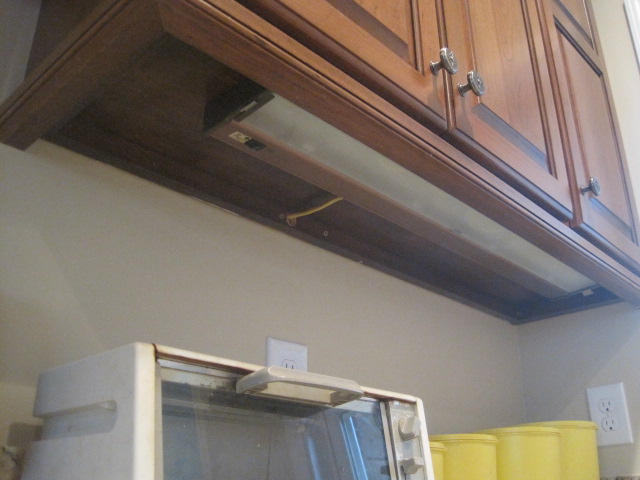

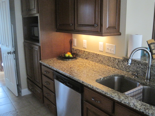

Any recommendations for under cabinet LED lights? I spoke to the electrician about it, and he will wire in a single feed, so the plan is to get the kind that you can string together.
Pete,
Here are some pictures of our under cabinent lights. They are just simple flourescent lights. The fixtures have two brightness settings. We keep ours on the soft light setting. For our needs, LED lights wouldn't have worked and looked any better than the less expensive flourescent lamps. We have lights under 3 cabinets; one light switch on the wall turns them all on or off. Each fixture also has its own switch so, if we wanted, we could turn on each of the under cabinet lights individually. We always turn the all cabinet lights on or off together.
One thing to note, make sure the electrician installs the lights at the front of the cabinet like shown above our toaster over. The light beside our sink was installed toward the back of the cabinet close to the wall; it doesn't light the countertop as well as the other two cabinet lights.
