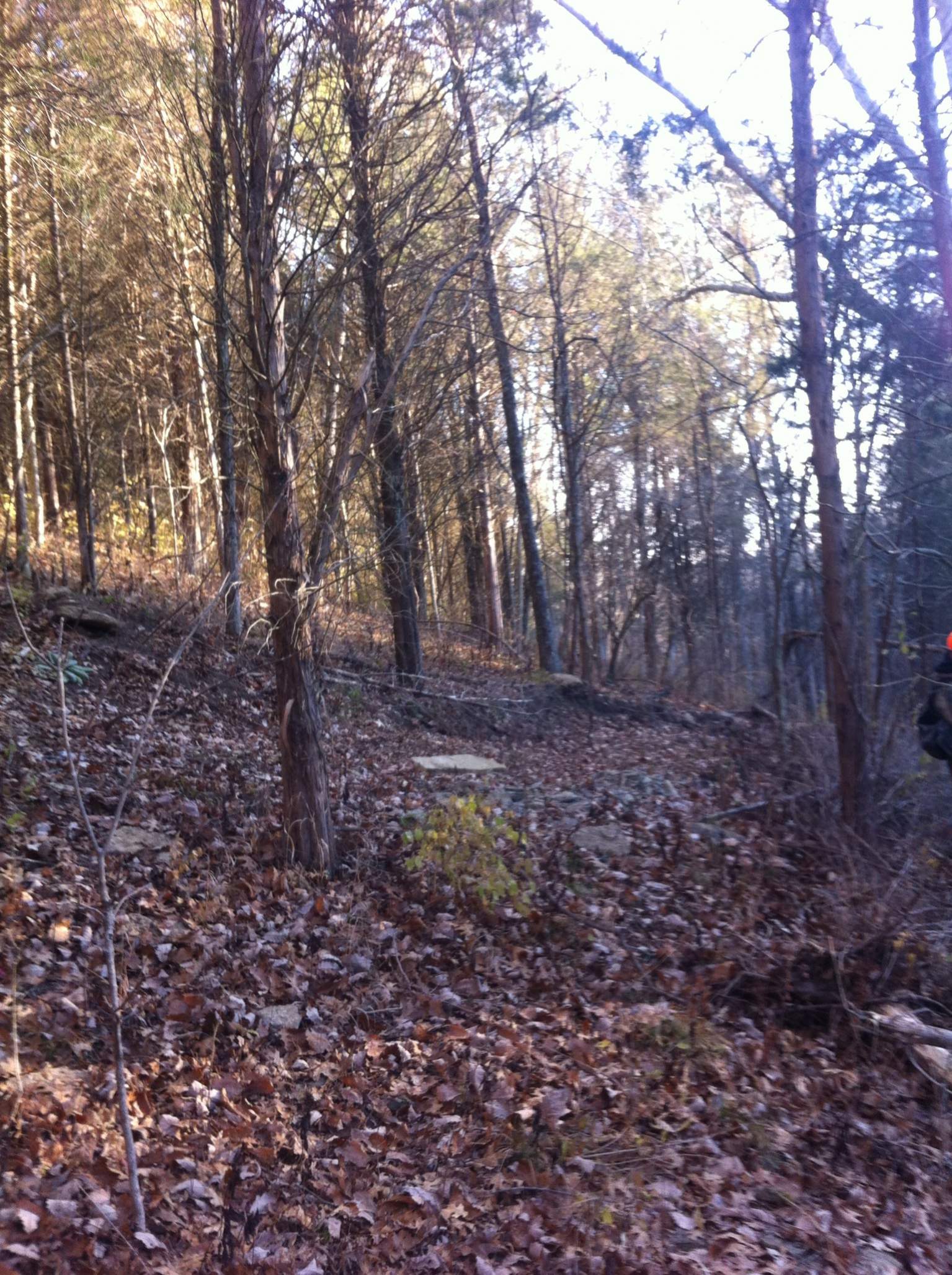

Okay, here are some trail pictures with switchbacks that I did a few months ago.
First is an easy switchback but I needed a fair amount of fill on the far side of the turn

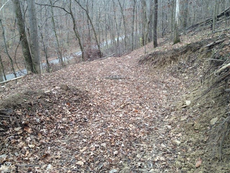

Here is a tight one. I really need to dig out more on the left bank and fill in wider after the turn, on the outside. Right now it's a three point turn.

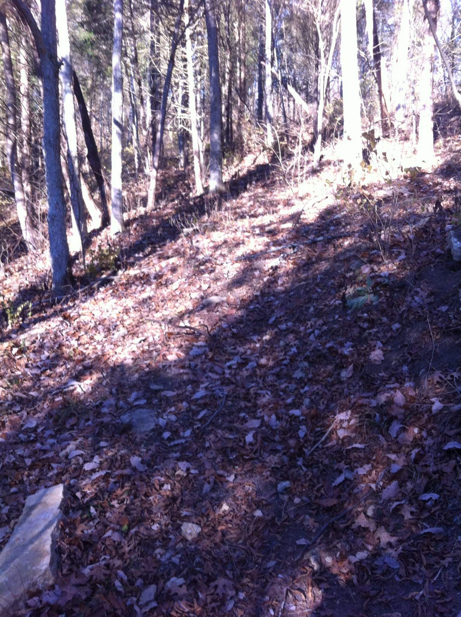

Here is the bottom of that turn, looking up the trail
It doesn't show very well but there is about 5 feet of fill on the right side.

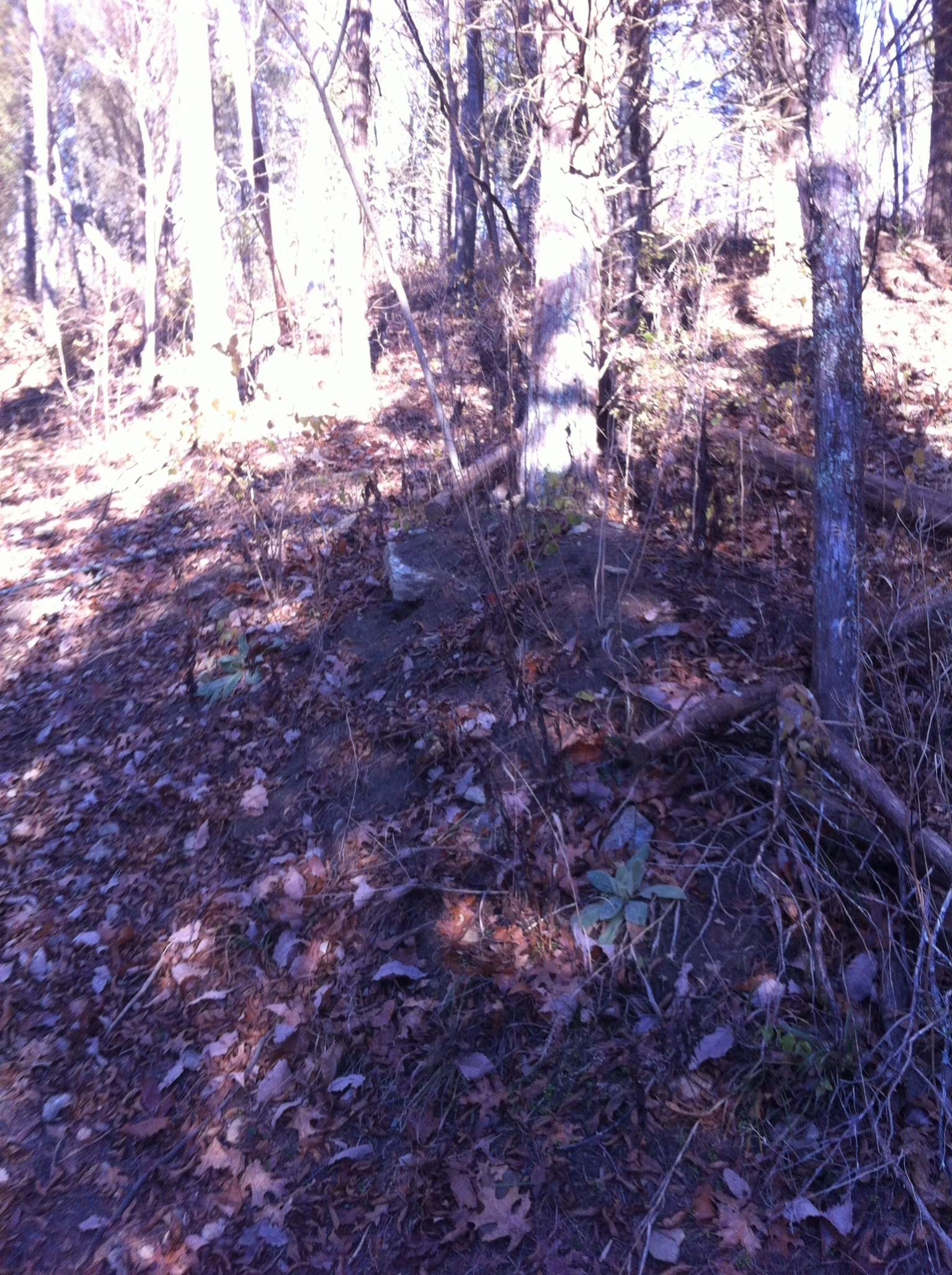

Here is a trail junction/switchback. A lot of dirt was dug out coming down here and used to raise the main trail a couple of feet and widen it.
I hope these help somewhat.

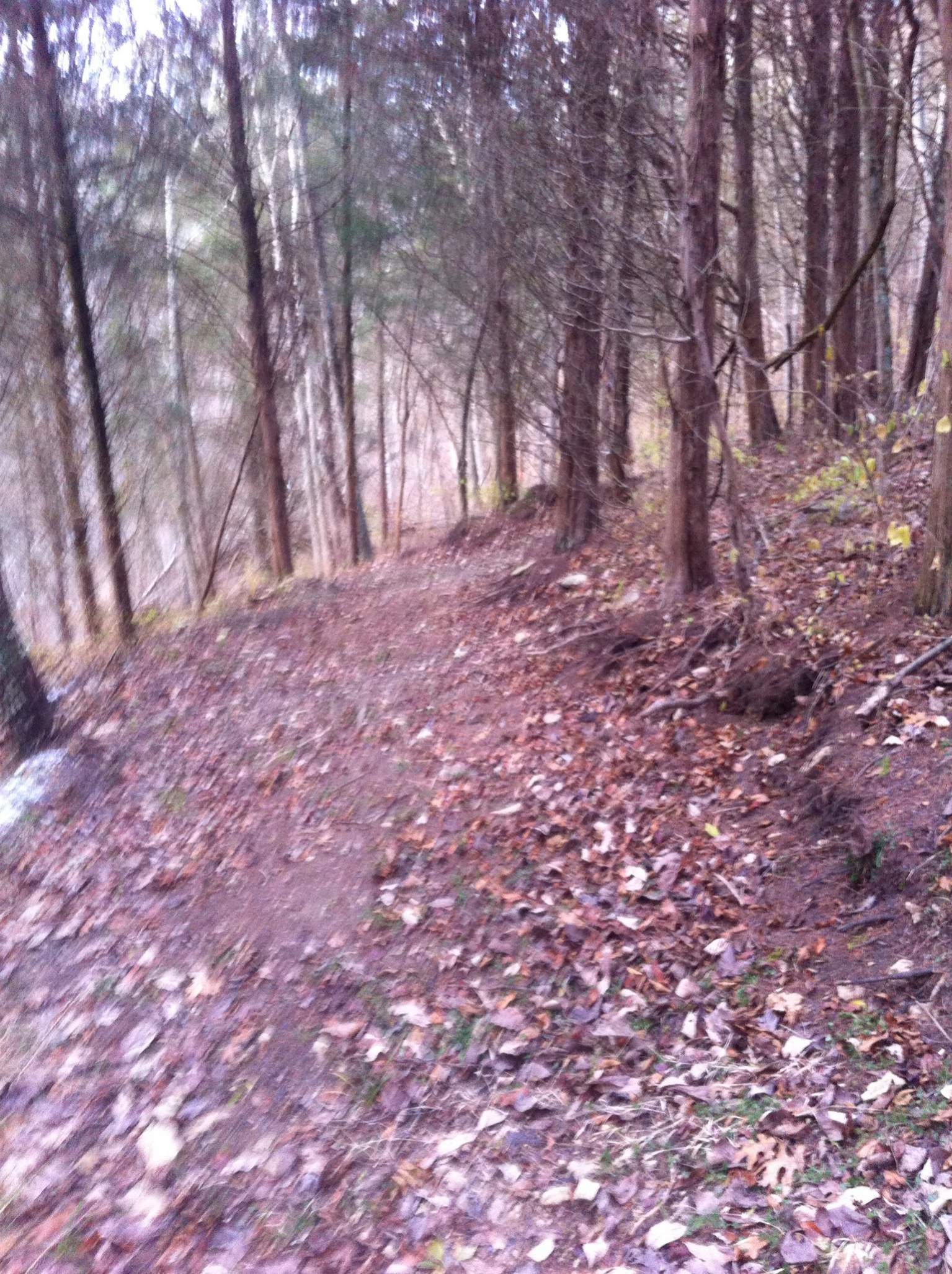

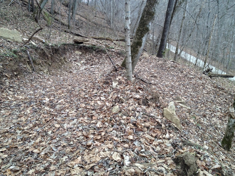

See if they show up
