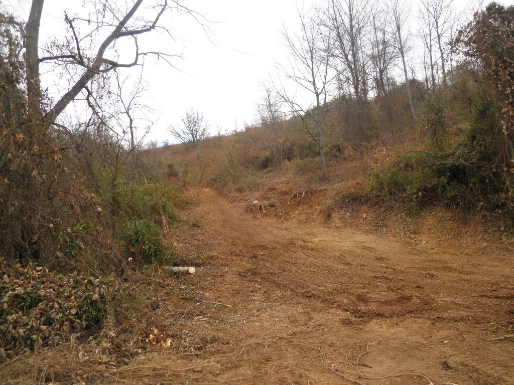

I have 10 acres in western NC that I'm cutting roads through...It doesn't sound as steep at the OP's, but is too steep to drive up with a 4 wheel drive B21.
In fact, I have some pics of a road I'm beginning to cut across one of the hills with a rental B21...
I'm taking dirt from the uphill and just dumping it onto the downhill and compacting with the tractor. So, half of the road is solid undisturbed earth and half if compacted fill.
Of course, what that results in, is the downside of the hill past the new road is now MUCH steeper for about 20 ft or so.
I guess the only way to get around this is to dig further into the hillside and instead of dumping on the downside of the hill...taking the dirt off the property and selling it or something....

Matt, Looks like you are doing an intersection rather than a simple switchback? Yes, those are more complicated because of the change in grade.
In my experience, although you have the fill compacted well, it will still settle for several years. I've started leaving extra height on the fill area so that it will hopefully settle closer to level.
BTW, I originally did work with a B21 but that little machine always worried me on a hillside :) I've graduated to a mini excavator and a skid steer.

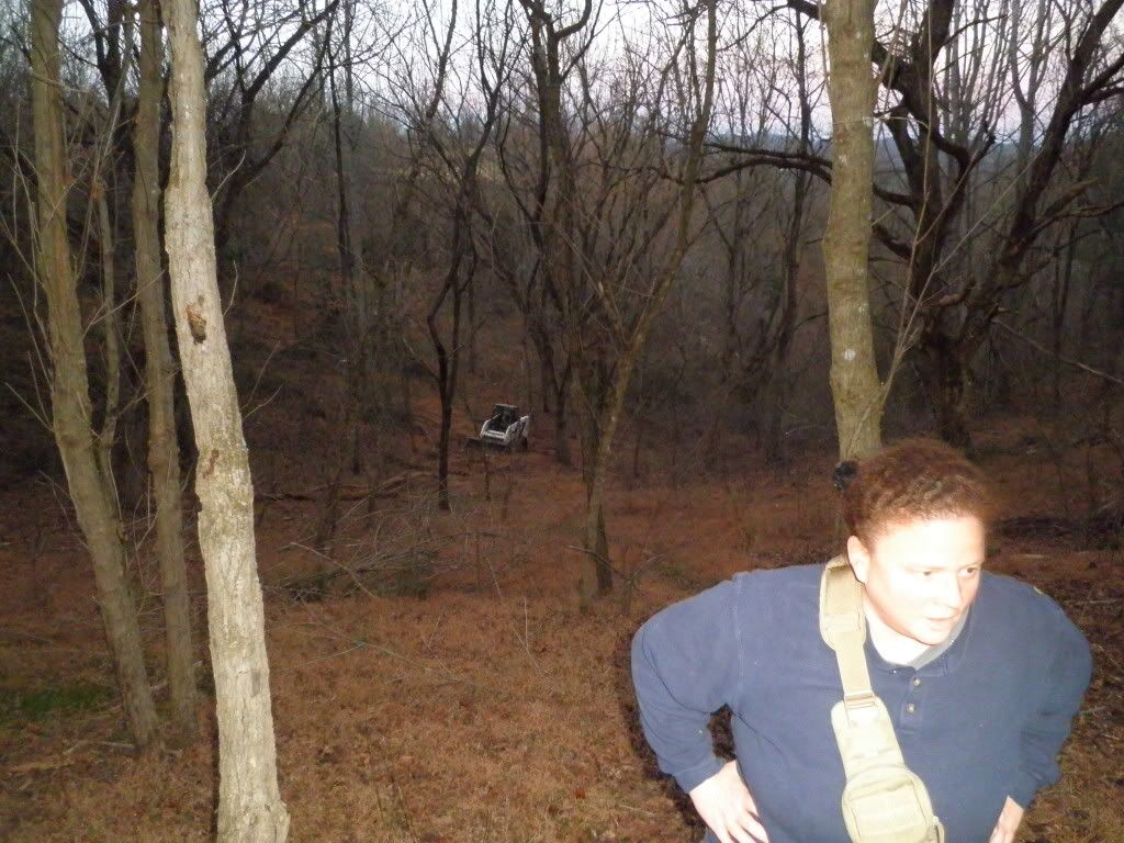

Thanks for the replies. It amazes me what you can do with a little tractor. I like the idea of digging Dow as opposed to building it up. Our soil here is clay and settles forever if you don't compact it as you put it down. While possible it would be a lot harder on this particular part of the road than just cutting deeper into the hill. Attached is my machine. I don't think I could do this without it.

Your right, that isn't a switchback, but when I get to the other side of the property, about 600 ft or so, then I will be doing a switchback....hence my interest in this thread...
do you think a skidsteer and mini excavator are better on inclines?
To rio grande, I would love to see some pics if you have any.
and if anyone has pics of switchbacks they have done, that would be incredibly helpful also.

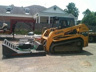

I will get some pix this week of what I have currently. I have run both on soaps and am just more confident with my tracked skid steer but I have hundreds of hours of seat time in it. I have about 20 career hours in a track hoe. I have never run a little one.
I hope to get it all cut in soon. We are deer hunting now so I am not doing any excavating. As soon as the deer are all killed as long as rains don't set in I want to. Get back to work.

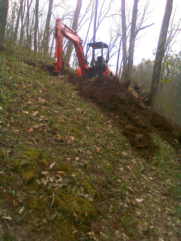

A mini excavator more maneuverability and stability than a small backhoe and definitely more swing. A backhoe is limited to putting the dirt no more than 90 degrees to the side. And it has the dozer blade for pushing and leveling. A skid steer can often work faster (depending on rocks) but needs more width to maneuver. I kind of alternate between the mini-ex and the SS. Of course if you need to move dirt any distance, say for the switchback, a mini ex is very slow compared to a skid steer.
When initially cutting across a steep hillside, I definitely prefer the mini ex over the skid steer. If you don't have room to maneuver a skid steer, it's hard to do the initial cut with one across a hillside although I'm sure some good operators can do it.
Here's one photo of me working across a hillside
uh yeah, that is steep...
love the pics, as sometimes they can tell the story a little easier...
I have a lot of road to cut and dirt to move, and might have to consider doing a mini ex and skidsteer combo rather than a TLB.
I was looking at the L39 Kubota, and it would be the cheaper route for sure...
Pretty much all I have to do is dirt moving and digging. I wont be pulling a bush hog or anything like that...so maybe a tractor isn't the best fit for me.

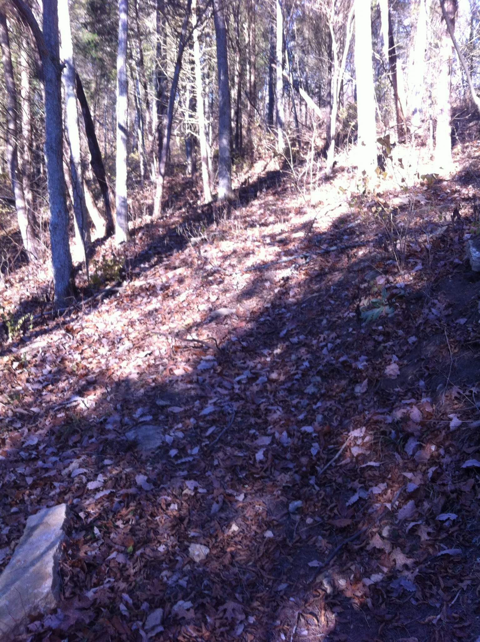

I took some pictures of the switchbacks this afternoon. I'll post them after I get the phone recharged.
/ Building a switchback in a road #12

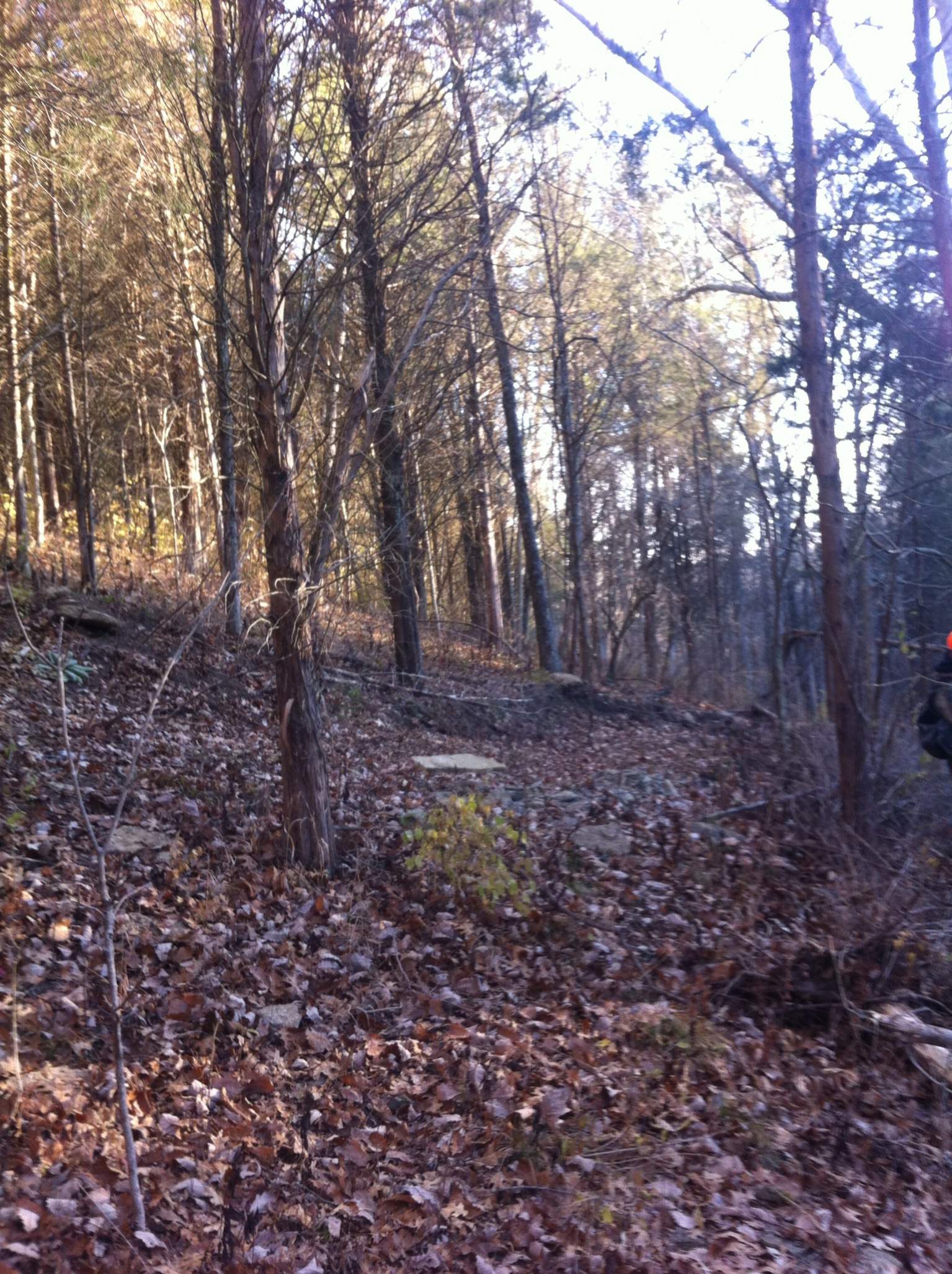

Okay, here are some trail pictures with switchbacks that I did a few months ago.
First is an easy switchback but I needed a fair amount of fill on the far side of the turn

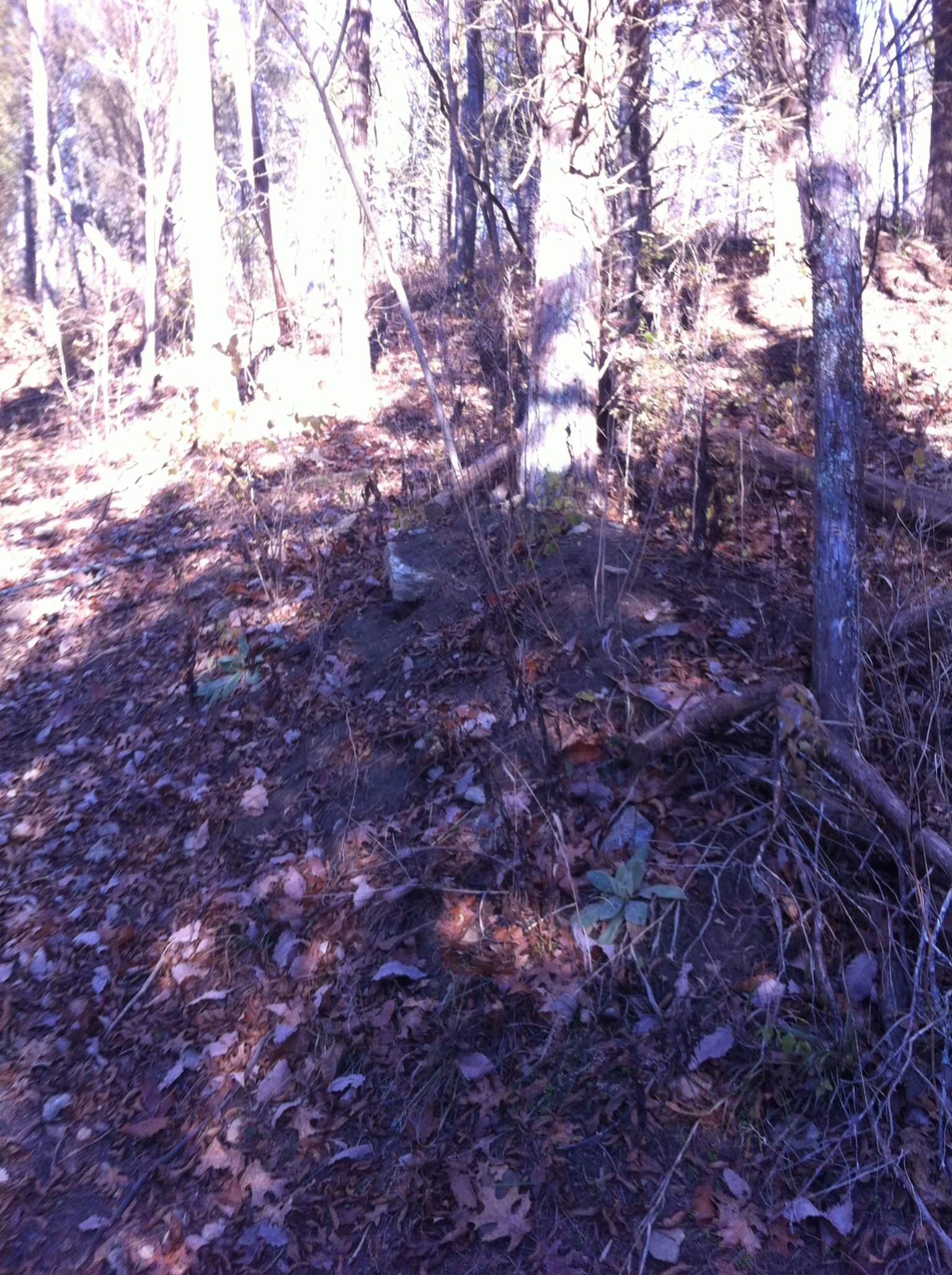

Here is a tight one. I really need to dig out more on the left bank and fill in wider after the turn, on the outside. Right now it's a three point turn.
Here is the bottom of that turn, looking up the trail
It doesn't show very well but there is about 5 feet of fill on the right side.
Here is a trail junction/switchback. A lot of dirt was dug out coming down here and used to raise the main trail a couple of feet and widen it.
I hope these help somewhat.
Ken

Ken mine is similar to your first pic, but mine falls a little quicker. I am going to try to hunt tomorrow and will try to get some pix.

I've done a few cross slope cuts with my 855 TLB. My approach is to start at the bottom and work up moving backwards all the way. Dig from the up hill side and deposit on the downhill side. All logs and rocks are used to stabilize the bank. I cut past level so the uphill side is lower than the downhill side. I make sure my outside wheel stays on original dirt and not fill. For drainage I put Big O drains under the trail every so often. This way water runs along the uphill edge for a bit then crosses under and is directed away. No erosion this way.
Switch back turns should be level. Stop climbing and level out then make the turn before starting to climb again. I try to pick a good spot on the slope where there is a natural level spot or depression to minimize the digging. Add some drainage features around the turn to assist with moving the water away.
Typically I will cut and fill all the way up before I go back to do any final grading or smoothing. That way I have the length of trail to drive along and am not trying to turn or maneuver on a narrow ledge.

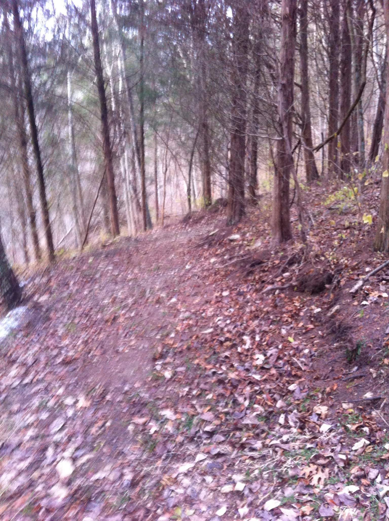

See if they show up
