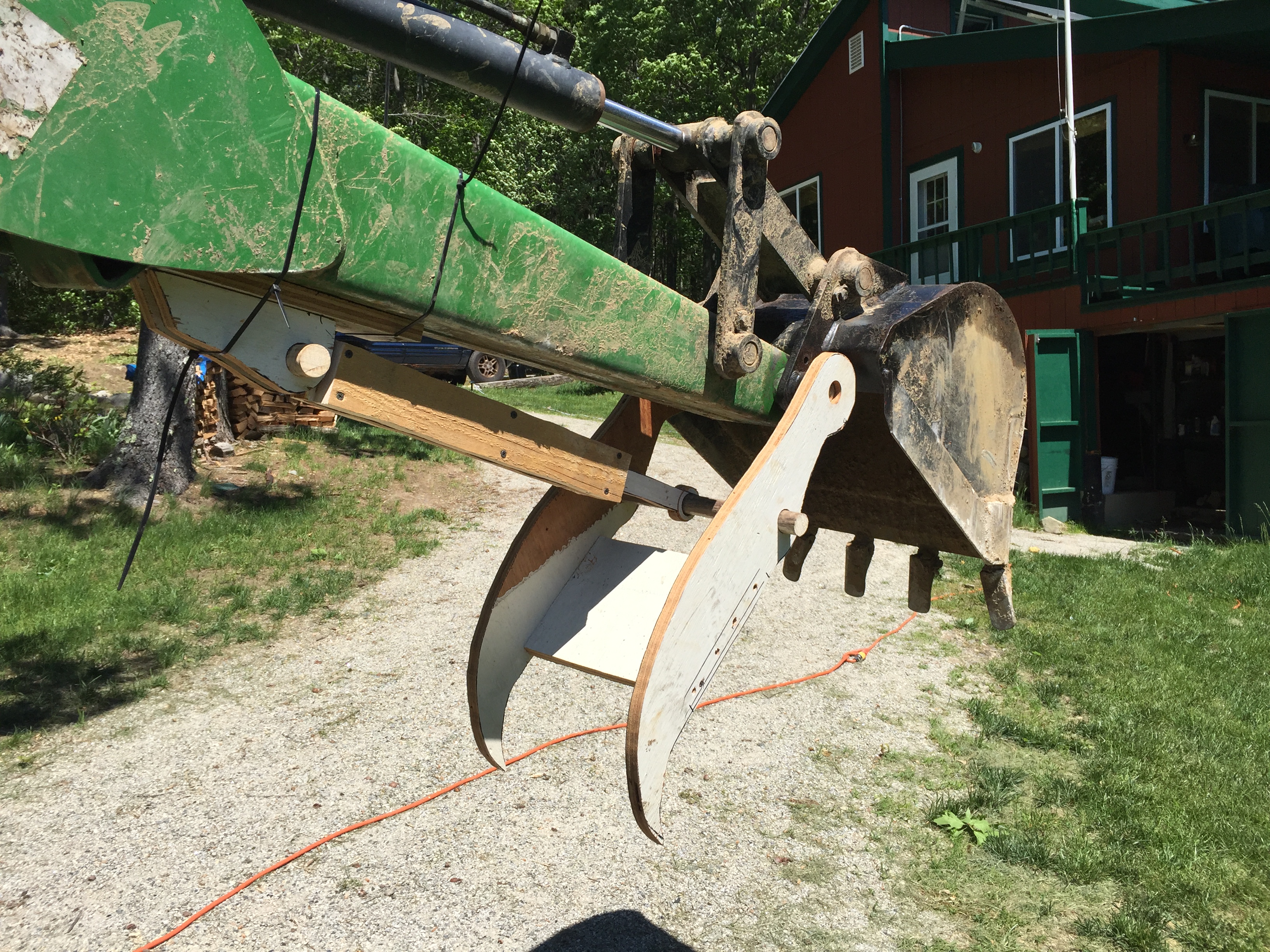

This weekend I spent some time building a wood model of a thumb. This is just to work out the general geometry. I know that I need to add some support for the pin where it ties into my wood hydraulic cylinder. IMG_2551.JPG

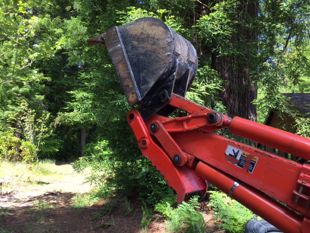

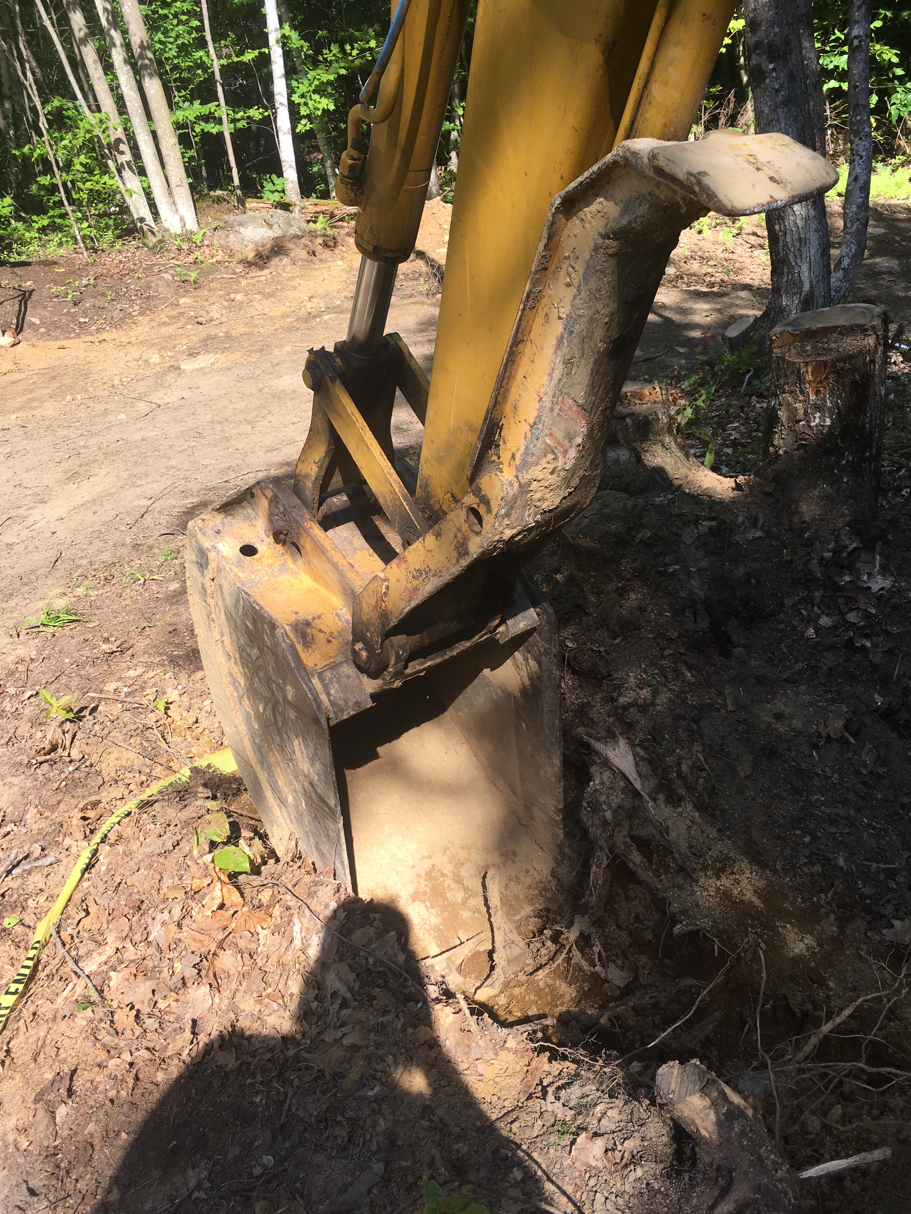

I was pretty happy with this until a friend of mine sent me a photo of his thumb. His thumb tucks in very nicely around the hydraulic cylinder and shields it from damage while digging. Now I'm going to have to modify my design to incorporate this type of configuration.IMG_2055.JPG

Building a wood model is a great way to design before fabrication. :thumbsup:

There are various ways to protect the rod end of the cylinder.
