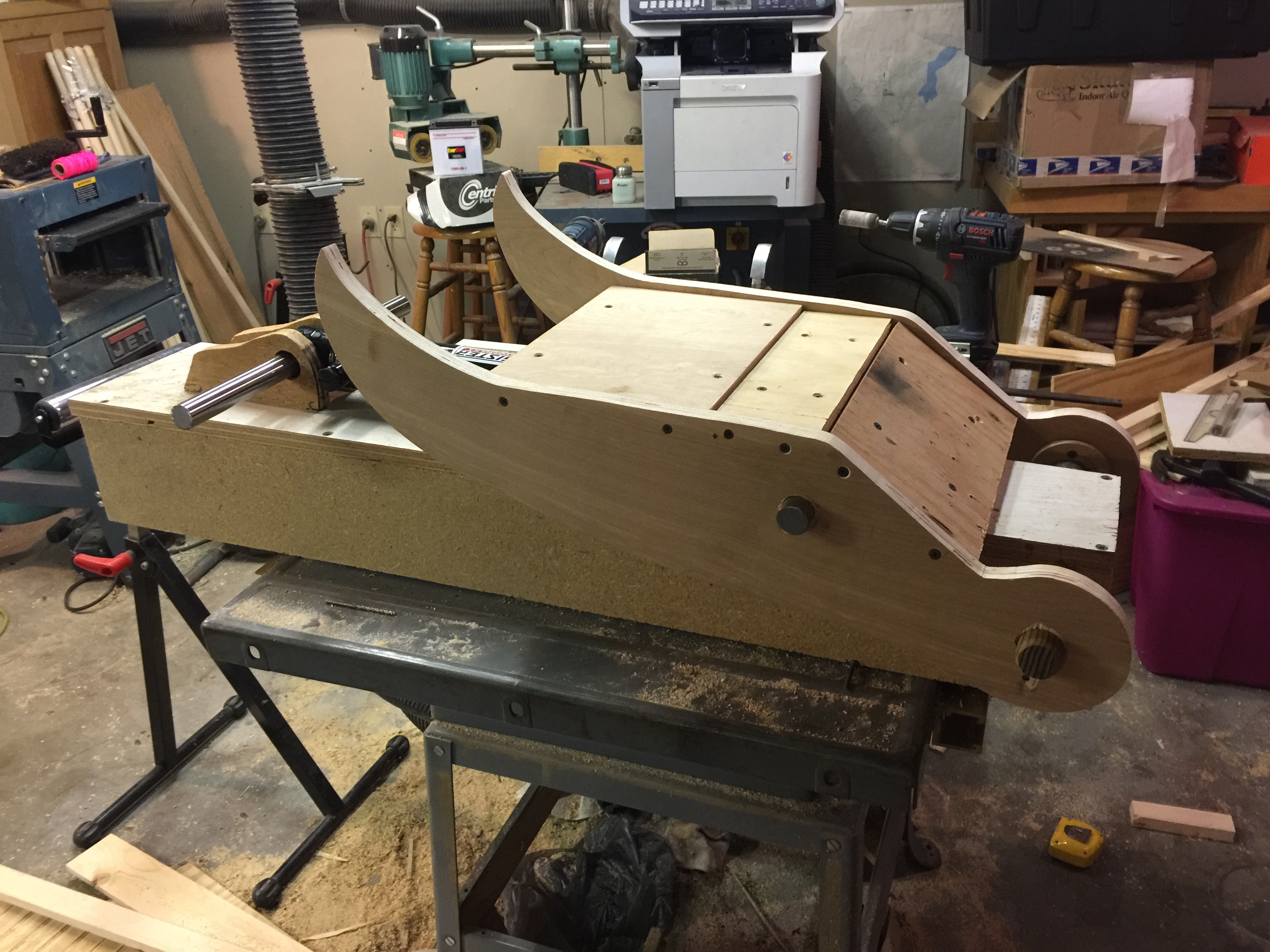

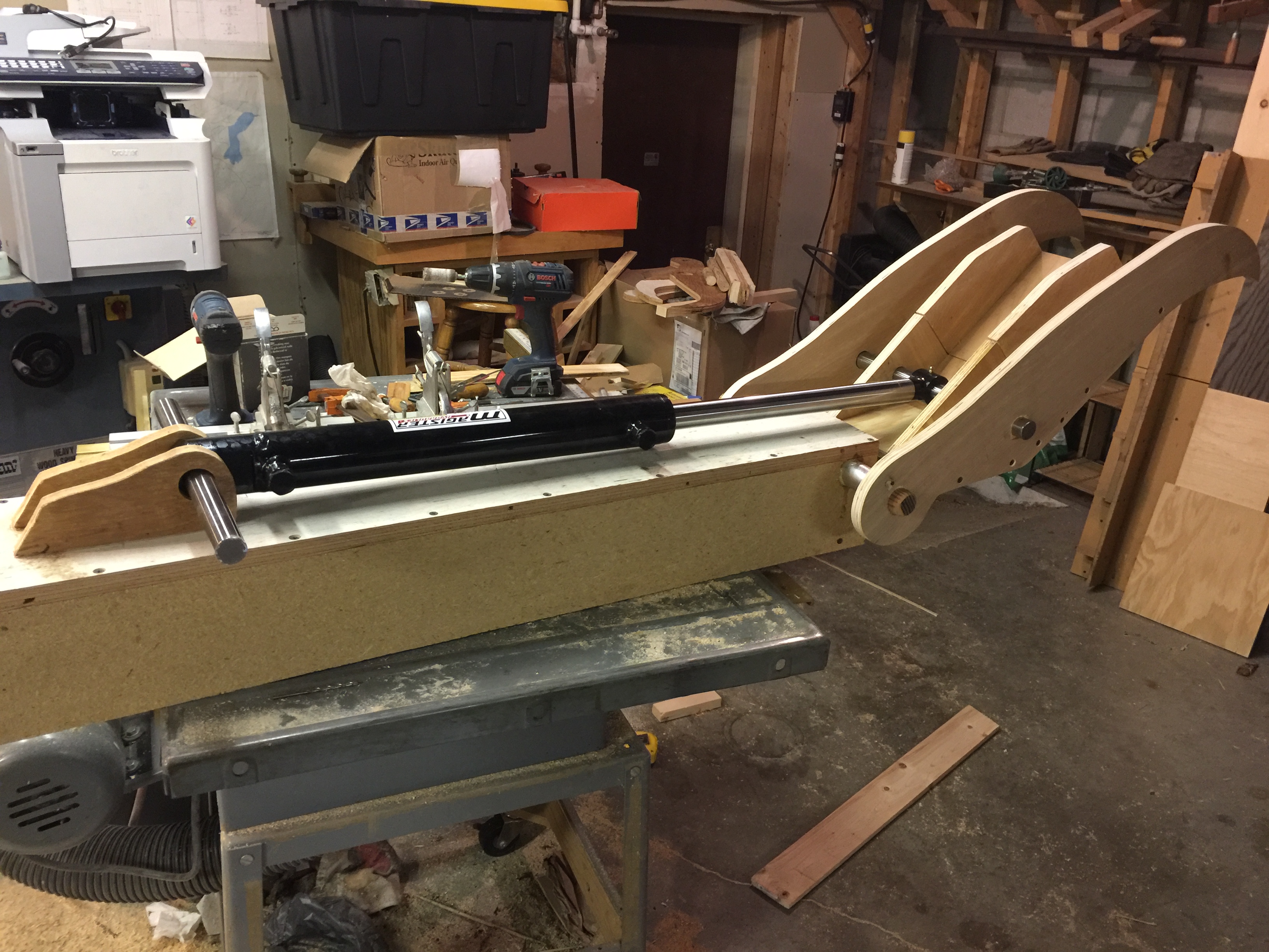

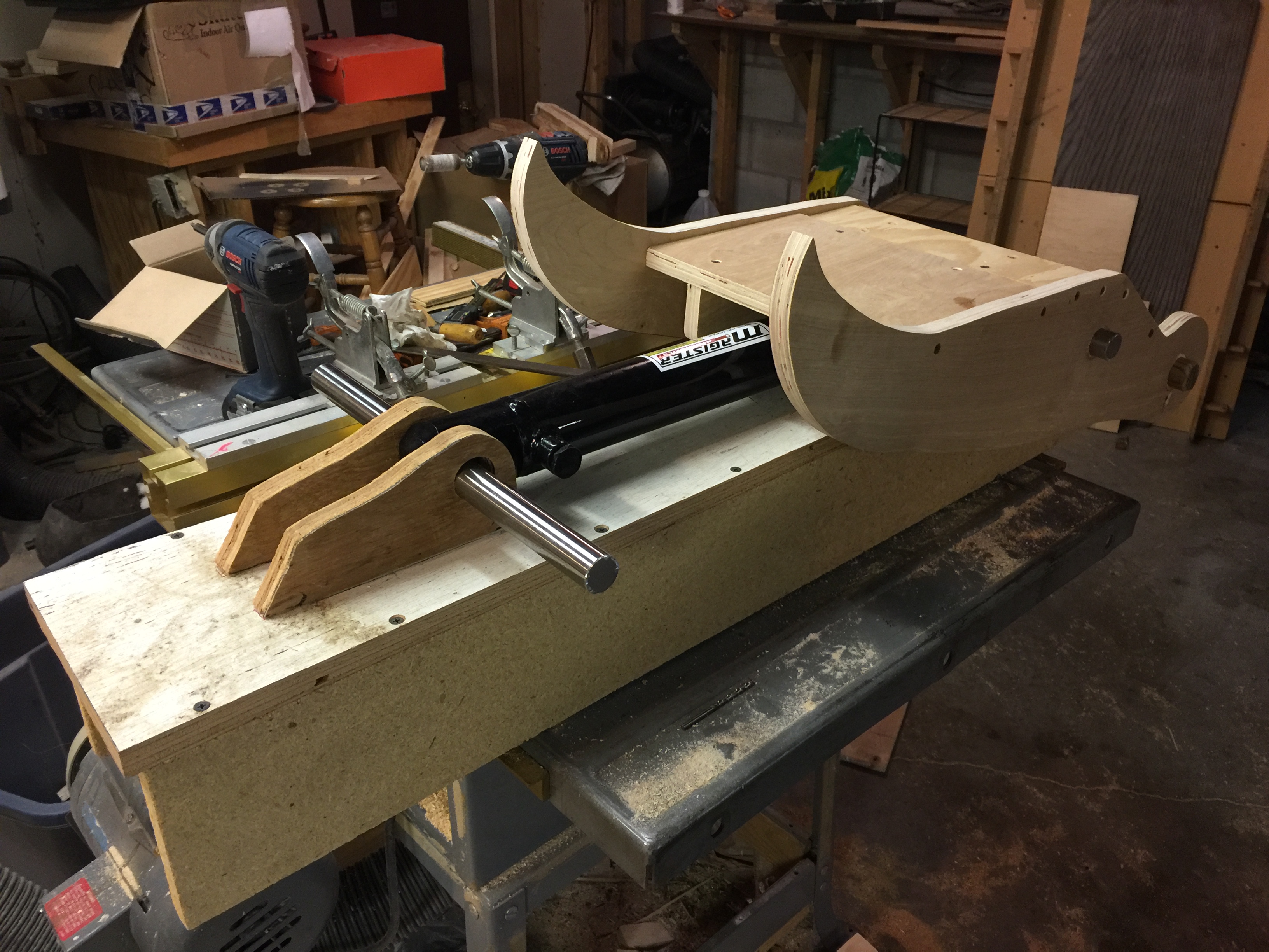

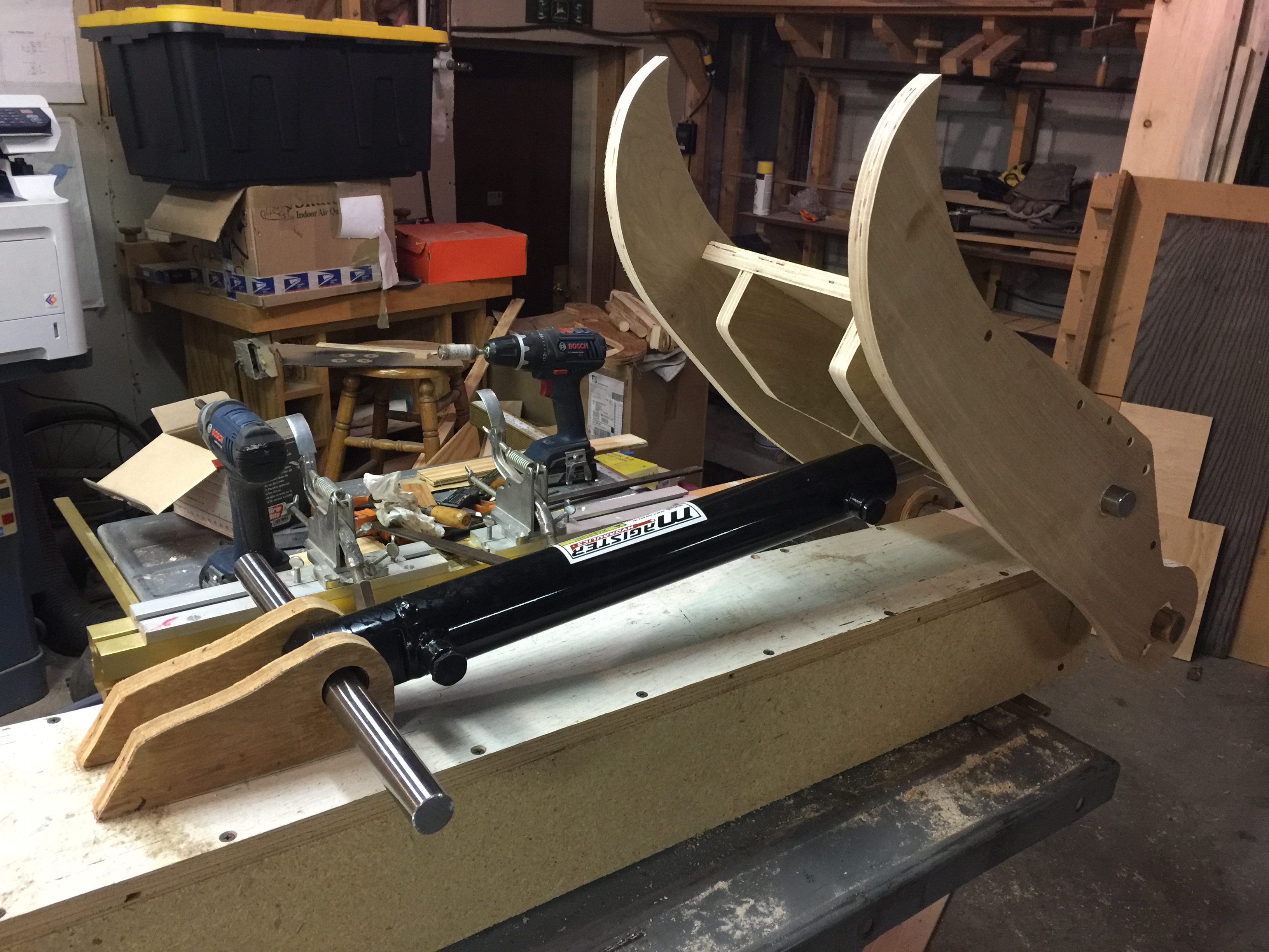

I dropped by the local JD dealer. They were able to look up the bucket cylinder specs. It's a 2 1/4" bore. My thumb cylinder is a 2" bore.
Here are some pics showing the final wood prototype using the cylinder from Magister.
You can see the internal ribs that close on the dipper and protect the thumb cylinder. The ribs will need to be made a little shorter to avoid interference with the forward hydraulic port.

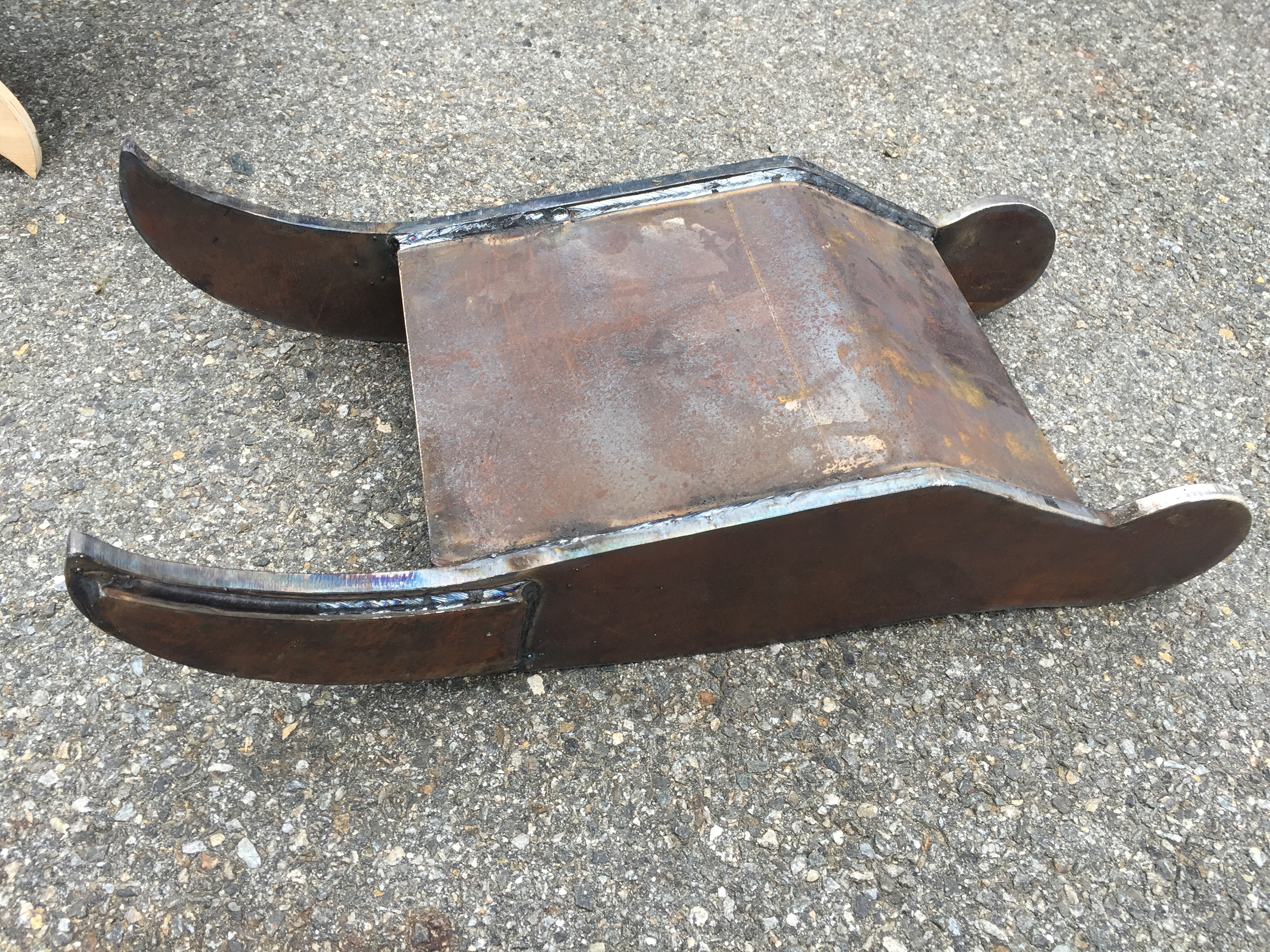

We made great progress yesterday with getting it fab'ed up in steel. The sides are 1/2" steel, with 3/8" reinforcement near the end. The center plate is 3/8" steel bent on a huge press.

Here's a video showing the cutting of one of the tines. One of the wood tines is screwed to his jig and used as a template. The cut steel part is 1/8" larger on each side due to the size of the little knurled rotating stylus that follows the outline.
