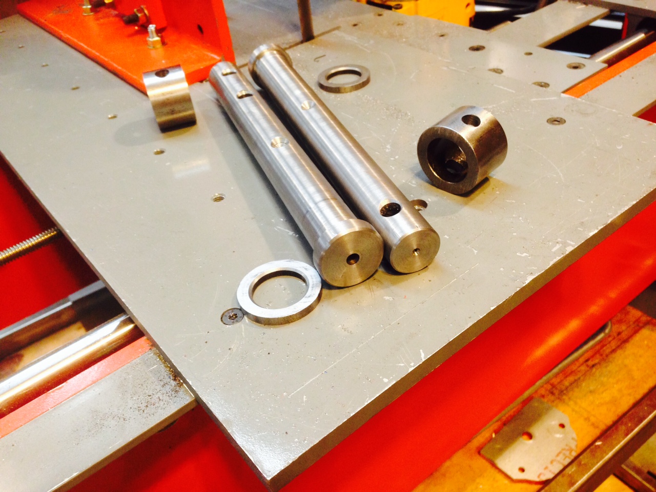

These are pins that I made for the linkage on my hydraulic thumb. Does not take long on the lathe.

Downsizing: Thanks for the pics of your pins. Looks like you turned them down and left a boss on one end. Is that the end you put the zerk in? I've seen some pins with end zerks where the counter bore and set the zerk inside for a bit of protection. That would be important, especially for a pin that's getting into the dirt.
   / Building a thumb for a model 48 Backhoe #80
Yes the zerk goes in the boss end. The other end is a collar and through bolt. Rather than counterbore, I used flat face zerks. They have been fine. They shed dirt rather than have it get packed into the counterbore.
