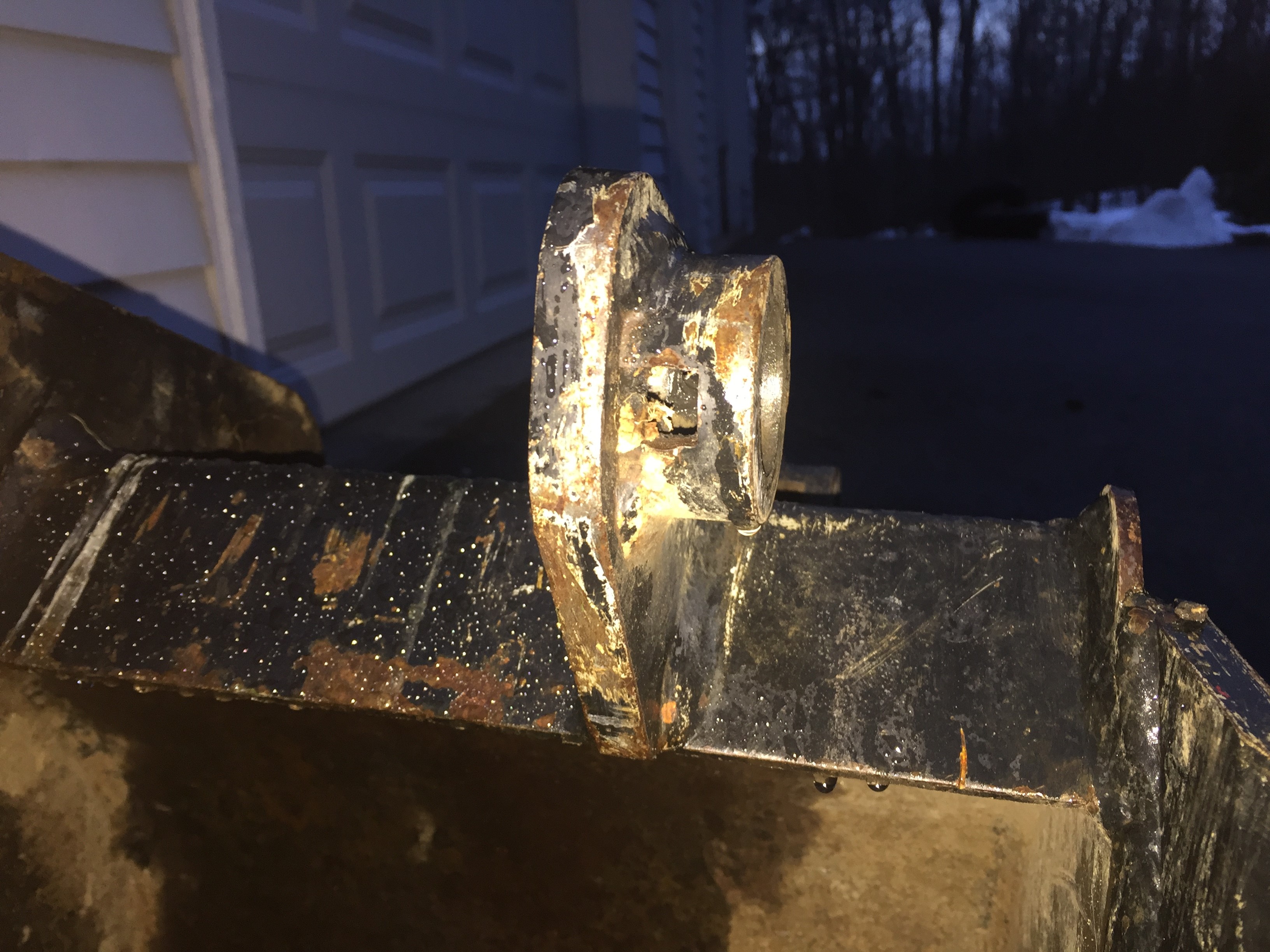

But the bosses in the bucket have square holes milled in for the retaining pins that I am not planning to use. If those little channels happen to be over those holes, the grease will go no further.

I just realized that I have a defect in my greasing strategy. I was depending on that little channel to get grease out to the thumb pivot. But the bosses in the bucket have square holes milled in for the retaining pins that I am not planning to use. If those little channels happen to be over those holes, the grease will go no further. I could bore out the bosses in the bucket and slip a sleeve in there, or just stick zerks in the thumb bosses. But I wanted a single-point to squirt grease in there and get everything. Need to think on this one.
As dfkrug said, without constraining your bucket to the pin somehow, it is likely your bucket will rotate on the pin rather than the pin rotate inside the dipper bore. So that bushing idea may become necessary down the line anyway if you use your backhoe a lot.

I don't have a picture in my mind of the square holes milled in for retaining pins, but....

Yeah, I also came to realize that grease passing through a little groove won't make it past the gap between the dipper and the bucket. So last night I bored another hole on the other end of the pin and added another grease fitting there to grease just the thumb pivot on that side. Then I drilled a 1/16" hole on the other end to feed the other side of the thumb pivot. So when I grease the other side, some grease will feed the thumb pivot and then the rest of the grease will pass through the much-larger hole to the center and will feed the dipper. This weekend I'll put the bucket and thumb onto the dipper and grease it up to see whether this works. A tiny 1/16" grease passage concerns me that it will plug up in short order. Can always make it larger.
I'll still have to add a mechanical means of keeping the bucket boss tied to the pin. The boss on the bucket only has 3/8" of material to work with (2" boss with 1 1/4" pin), so there's not enough bonding surface there for any nutty JB Weld-kind of solution. Now I'm thinking of machining a larger collar that slips over the bucket boss with threaded holes that will enable putting in a bolt that passes through the milled slot in the bucket boss and grabs onto the pin. I like this strategy as it keeps the bucket as-is and it maintains the "form-factor" making it possible to use any other bucket with no modifications. I don't see that I'll ever change the bucket, but its always good to maintain the option.
When JD fabricates the bucket, I think they use a mill to cut a slot in the boss BEFORE it's welded onto the bucket. That creates a square hole. Much easier than trying to drill a hole after the boss is welded on. You can see it here if you look closely.
Edit: added pic. Square hole.jpg
