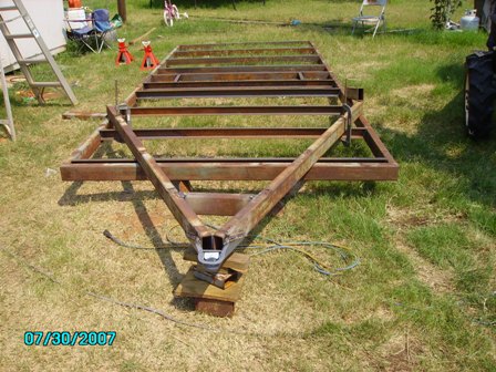

I keep peaking on it a little at a time.
/ building a trailer
#22
Worked on my trailer some more. I hope to have it done in about two week or so.

/ building a trailer #24
Good looking trailer!!
Are you going to put a rail down the sides to match the front? It would give your trailer allot more strength!!!
I can't tell from your pics, but for me, I like lots of anchor points. Two in fron to the axle and at least one behind it on either side would be ideal. I only have one in front and one behind and keep thinking of adding more.
Eddie
#25
sandman I am painting it because it had a lot of rust . had to clean it an paint it. Eddie I have to anchor in the front and two on the side in front of the axle and one behind the axle.

/ building a trailer #29
I kinda think Eddie is right about the need for side rails to strenghten up the bed. You only have those outside two, full lenght rails for support. I would suggest you watch the rear third of the frame when you load it for the first time with something heavy and decide if the "flex" looks acceptable to you. Remember, if there is weight on the rear and you are bouncing down the road or over railroad tracks, it might really stress that rear section. The front section has some advantage, because of the tongue support. I build a 20 foot long trailer similiar to yours and it was flatbed,also. I used five full lenght tubular sections the full lenght with two 6000 lbs. axles. I felt I even got some flex during big bumps on our highways.
#30
MrJimi it is oil based enamel .
Catman I may put side rails down about 2 or 3 feet later .
/ building a trailer #31

/ building a trailer #36
:rolleyes: Did you look at it or just jump on the Eddie band wagon? That trailer is built stronger than most euipment on the market! Great job Gizmo!
/ building a trailer #37
Mudcat; I did look at it before replying. My first thought was how similiar it was to the one I built in 1992. The outside perimeter rails look like to be 2"x4" tubular steel. My guess is that it is 1/4" thick. That's is what I used on mine also, but I had three additional 1.5" x 2.5" tubular steel(3/16" thick) running the entire 20' lenght also. The bed was covered with 1 1/8" marine grade plywood countersunk even with outside rails. This allowed for pallets to be loaded from the side. I felt I could share my experiences with Gizmo36. My loads may have been heavier than what this poster plans on hauling. I did read the entire post and viewed photos in each reply, Eddie just happened to have the same thought as I did during my reading/viewing.
I think we can all agree that Gizmo36 is doing a great job.​
I also feel that most would agree that when one "boxes" in a trailer, it adds a lot strenght. Around here, the lower cost car trailers, use 3/8" angle iron for there outside rails and they also "box" in the trailer with side rails because that is how it gets the necessary strenght. My Snap-on dealers' son, purchased one of these $1295 car trailer specials years ago, he told me that they had problems with it until they welded trianglar gussets at all the corners and some of the joints then it was fine after that repair.[These last two sentences are in no way a reflection of the trailer in this post.]
/ building a trailer #38
:confused: I thought it looked like 4" C-channel. I guess I need a smiley with a foot in its mouth.:p No denying it would be just short of a tank, if it was boxed in like the front rail.
/ building a trailer #39
Hey mudcat, Maybe Gizmo36 will enlighten us both with the actually tube size. If it is 2"x6", then I am probably "all wet" and there is more strength than I first thought.
Gizmo: I had a different thought about support instead of permanent metal side rails, what about a cable with a turnbuckle up in the lower front corner and triangular support stands over the axles(maybe low and only has high as the fenders with one stand at the front curve of the fender and the other at the rear curve). It would look like a very low pitched roof rafter on each side, but with the "peak" cut off. The advantage is that it could be removeable for side loading. Or forget the cable and use hollow rods with spherical rod ends attached. Use one left-handed thread and one right-hand threaded rod end, then when you rotate the center hollow shaft it loosen or tightens.(just like a big turnbuckle)​
You can take this idea or leave it.
