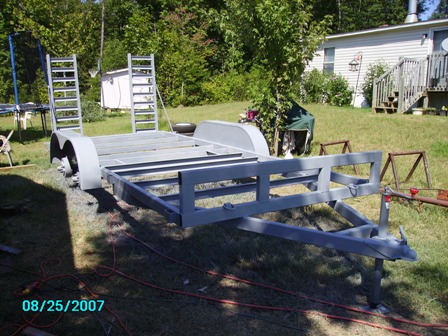

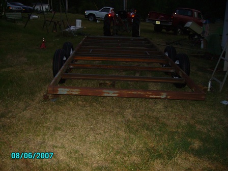

It is 2x4 tubular steel 1/4 thick for the frame . The cross rails are 3" C-channel 1/4 thick. I still like a lot to have it done.

Skyco I wish I had bolted my fenders on . But I did not if I ever have any thing to go wrong with them I will next time.

I am not done yet but real close.But it is far enough that I can use it.

perhaps i missed it but....
were did you get your steel?
how much would you say you have invested in it?
pros/cons vs breaking axle being front vs rear axle?
/ building a trailer
#46
Thank you excelagator
schmism a lot of the steel came out of a old cotton mill. I have about 1100$ in it so for.
