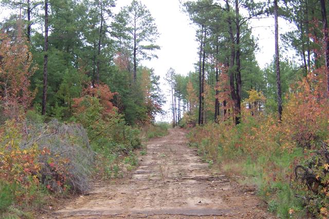

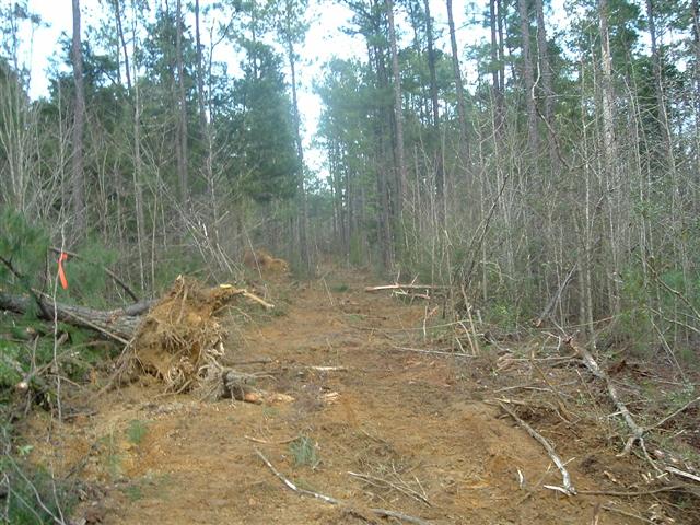

I make my trails with my dozer. I drive through the brush and trees, knocking over what's in front of me without taking out the bigger trees. I like to wonder through the woods if I can.
The dozer dosn't do a very good job on the smaller stuff, and is pretty rough on the ground too. A few months after the dozer has done the majority of the damage, I'll bring in the backhoe and take out the larger of the small saplings out. Then I clean up all the debri that's had time to dry out and take it to the burn pile.
Next I drag the trails to smooth them out. This might take several passes, or most of a day of going back and forth over the ground to get in nice and smooth. Sometimes I have to bring in loads of dirt to get it real nice.
Then I let nature do her thing with plants and grass. I'll start mowing when it's tall enough and keep it mowed.
My trails are ten to 12 feet wide because I like to be able to drive down them if I have to, or just want to play on them. I also like them that wide for hunting and running away from snakes. At 12 feet, that's still way too little room for a snake encounter!!!! Steph and I came across a cotton mouth on a trail last spring that was laying across the trail. We saw it just before it took off into the woods. We don't know where it went because we were both running in the oposite direction!!!!!
Make your trails wide enough to be safe and comfortable to use for a multipile of reasons.
