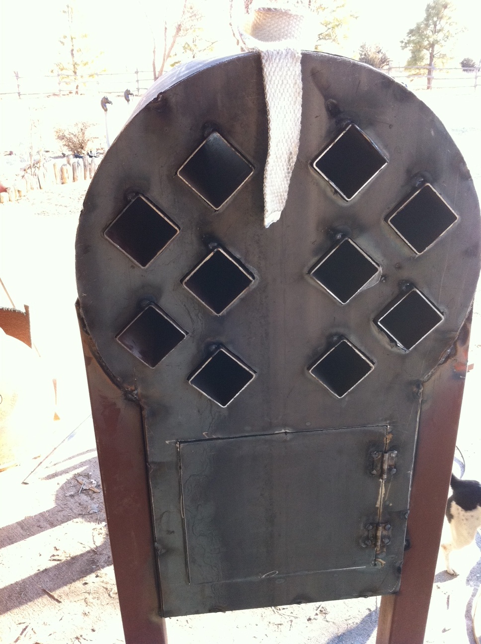

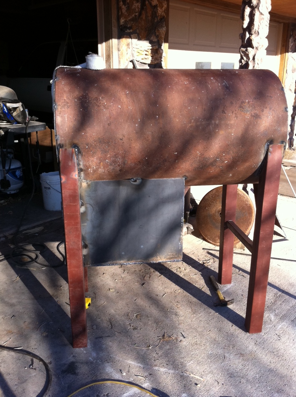

LetsRoll,
First off would like to thank you :thumbsup: for all your post and feedback to this website... you have inspired me to build.. I have read all 19 pages of this blog about 19 times... Great Stuff !!!! I will attach pictures of all your ideas put with mine. The stove is near completion. It just likes the 2" blower and oil line in the top of the stove and the flu pipe. There will also be an 6-1/2 X 8-1/2 X 3/16 glass in the door to see inside the stove. I have a 24" fan out of a 5 ton Heater for the blower through the tubes and a 1hp blower for the stove to control air. I will post more pics after the unit is installed if anyone is interested in seeing them.... I like about a week of gettting it in the shop... Then will start playing with the oil. wish me luck!!!! :confused2:
