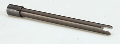

Hello Ken...Yes, I used a SB Chevy oil pump. The electric motor that I used was 3/4 HP and the RPM's was 1750. At 100 psi, the oil pump would move about 6 gpm. On a extreme cold day, the flow would slow down some. But, I generally filled my waste oil holding tank right after I turned my stove off for the day. I keep my waste oil barrels in my stop and after turning the stove off, my collection of oil is heated up and it flows very well. The fitting I used was from a oil pump rod. If you've worked on a sb chevy motor before. The rod that comes from the oil pump to the distributor. On the end on that rod is a fitting. Most factory fittings were plastic. But on a high performance motor, you could buy a rod with a metal fitting. I just pressed out the pin and the fitting slid off the rod. I drilled out the fitting to 5/8 inch cause my shaft on my electric motor is 5/8 inch OD. Took the fitting and slide it on the electric motor shaft about half way and tack welded it. The shaft of the oil pump would slide inside of the fitting that is tack welded to the shaft on the electric motor. Pretty easy job to do. I took the oil pump apart and took the plunger and spring out and welded up the holes. Doing this allowed the pump to put out 100 psi. Then I drilled holes into the oil pump and welded fittings to it. The oil line hose on the sucking side of the oil pump needs to be heavy duty. If not, the oil pump will clasp the oil line when it sucks up the heavy waste oil. I did use clear hose, but had to change it just for this reason. If you need me to get you some pictures of my setup, I can do that this coming weekend. Just let me know. I have very little money in this setup and it works pretty good.
