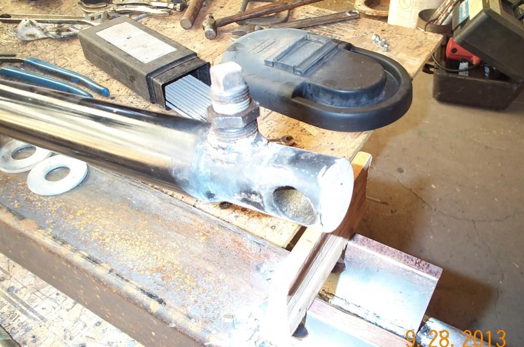

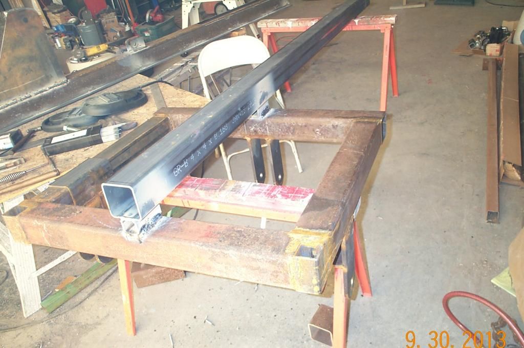

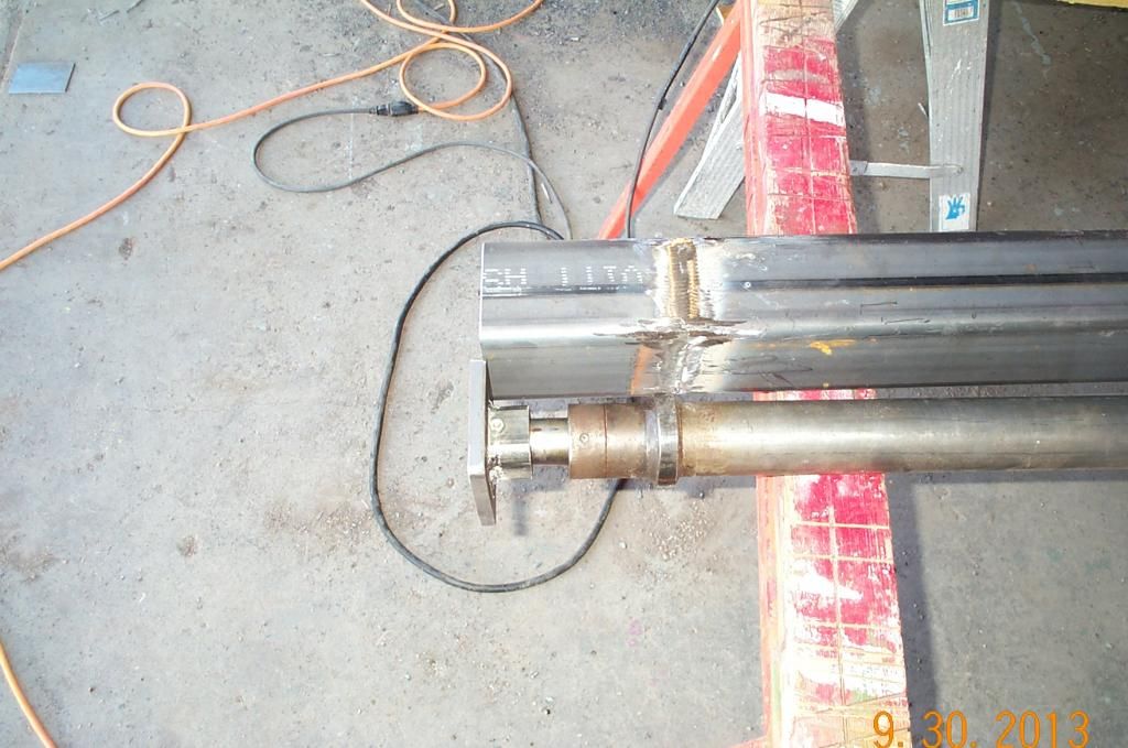

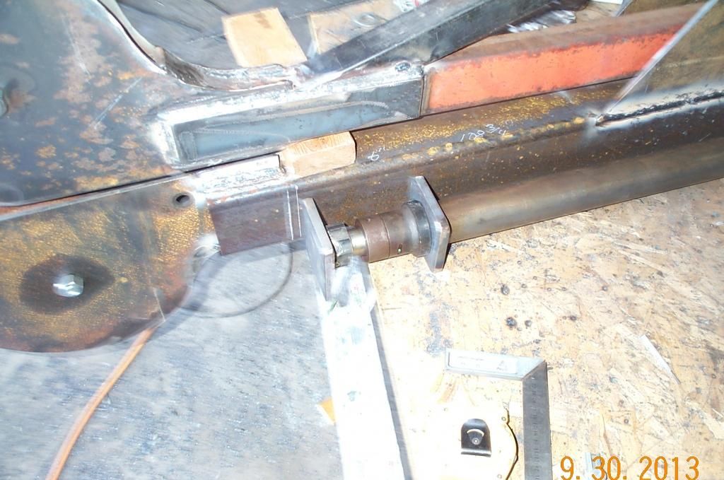

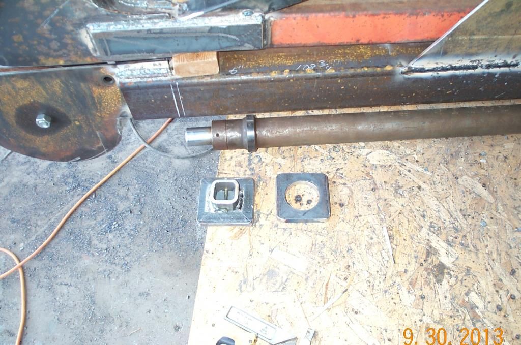

cylinder extension with mounts

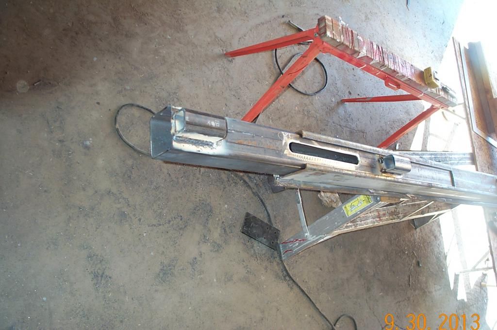

checking out the measurements on the extension cylinder and figuring out the placement of the mast tube.
checking out the cylinder and mast tube with the stop welded on,

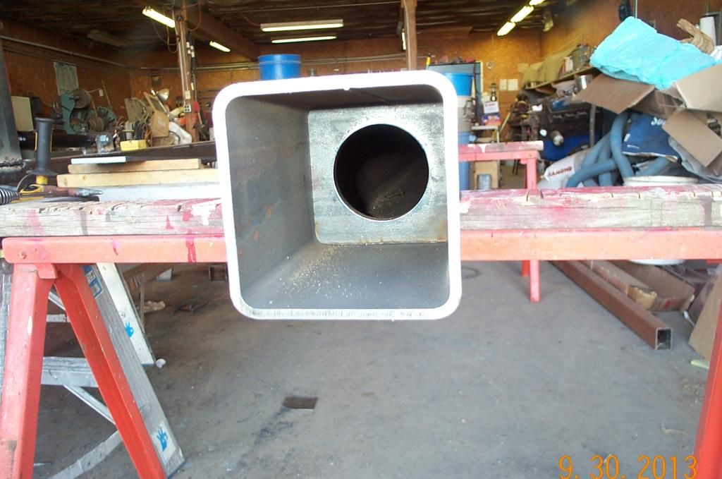

picture of the mount in the tube
test of mast in the extension tube, note the slot in the mast for the cylinders Hydraulic cylinder
mast welded to base,
the weight cylinder welded a larger fitting to it to help reduce restriction for dropping of the weight,

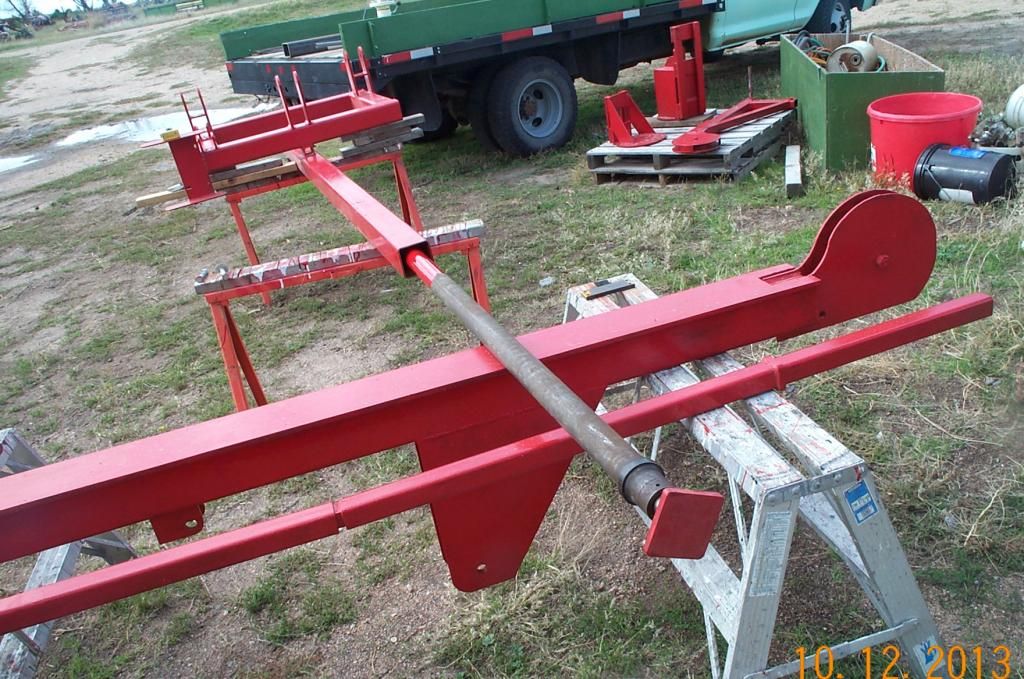

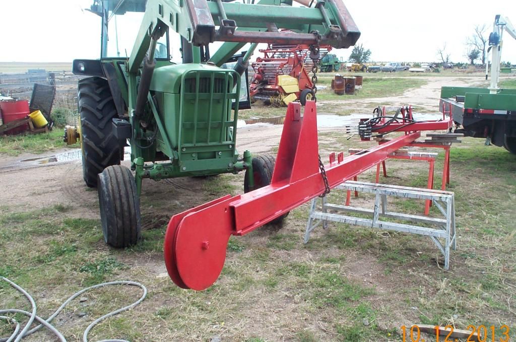

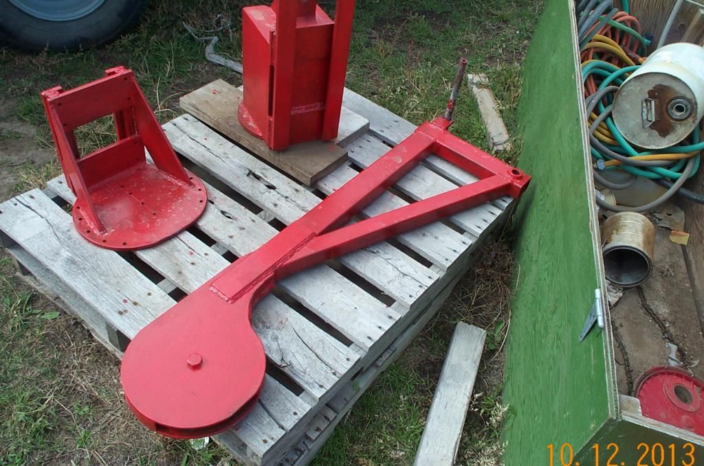

a few more pictures

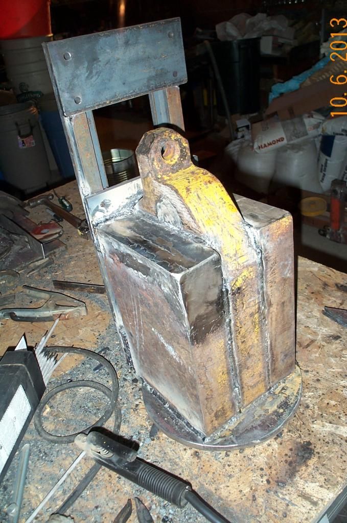

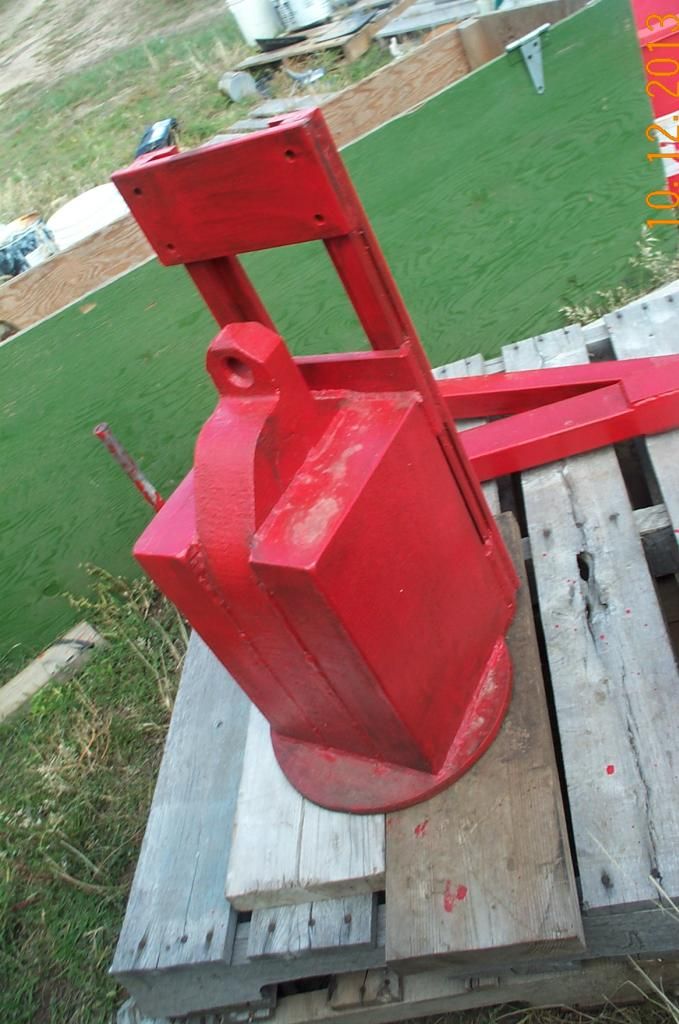

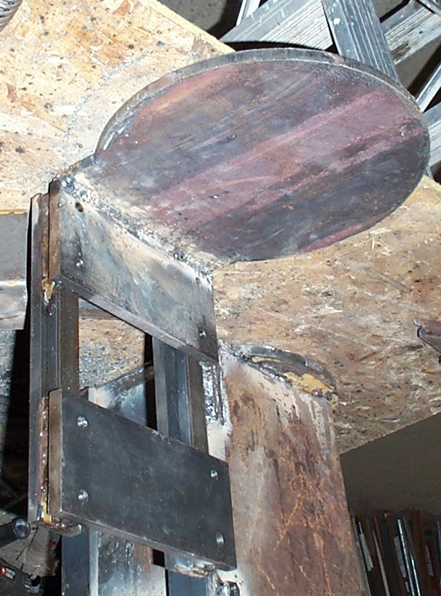

the follower under construction. (yes the picture is up side down but the follower is in the position that it will be on the machine.
the weight, about 350 pounds.
the follower, weight, and arm
installing the extension cylinder and paint it as installing it,
putting extension on the mast.

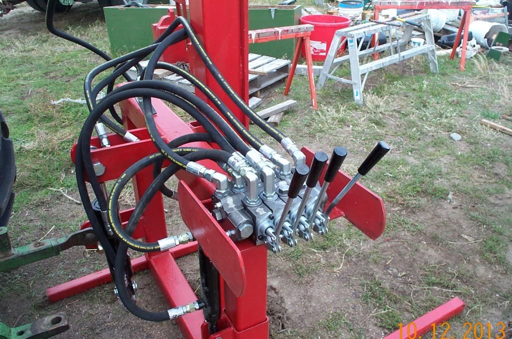

valves and bracket with protection ears,

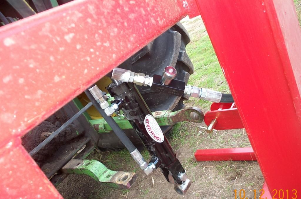

I added a control valve for limiting the speed retraction of extension, on the extension cylinder, on the tractor there is a similar valve on the input side.
the tractor has a power beyond block on it so I can access the hydraulics with out having to go through the valve, the system is a closed center hydraulic system on the tractor,
Nearly complete still needs the weight, follower, and rope. and a few small things (bolts need to be drilled and taped for grease zerks on the pulleys, and think I want to add two small guides on the arm. and need a pin and chain for the follower, so the follower can be pulled up by the weight,

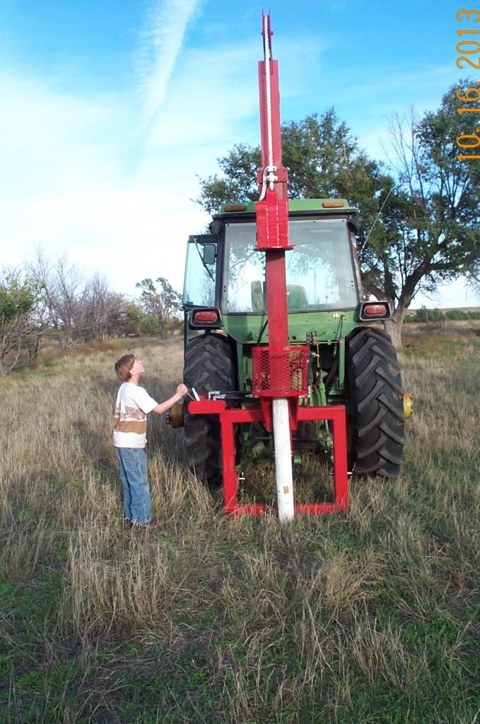

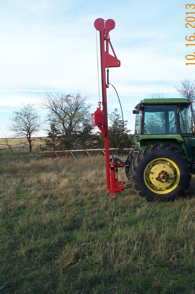

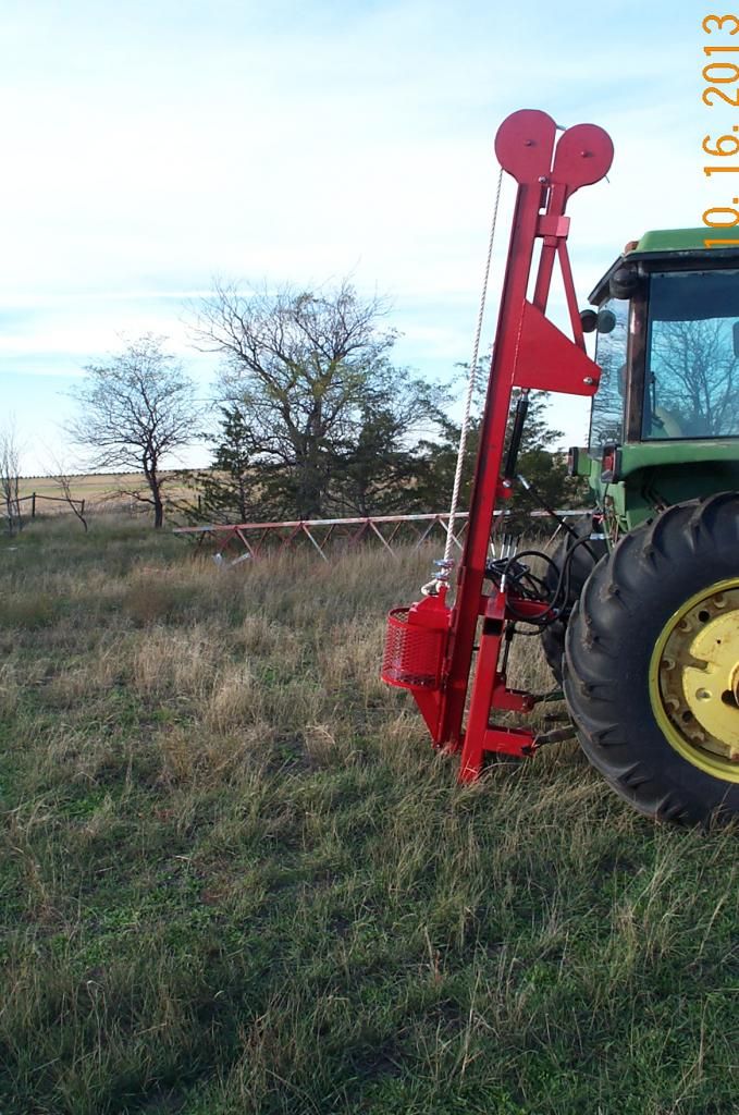

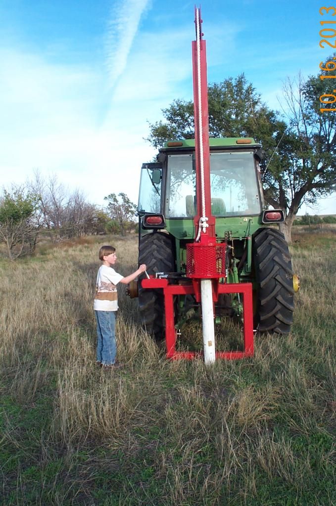

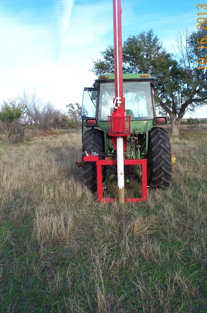

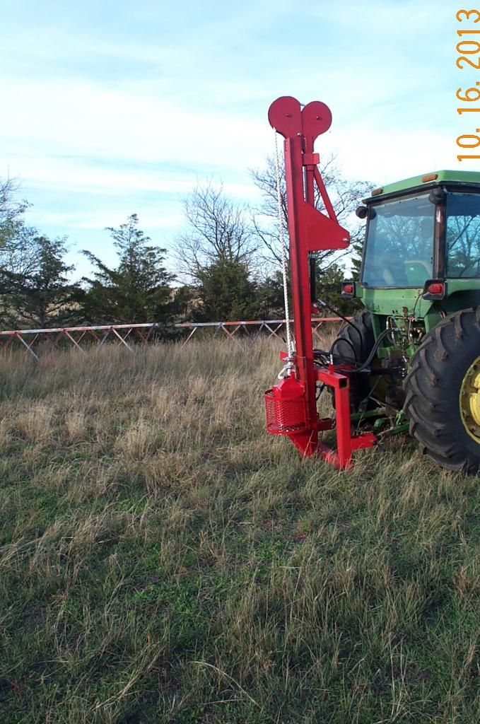

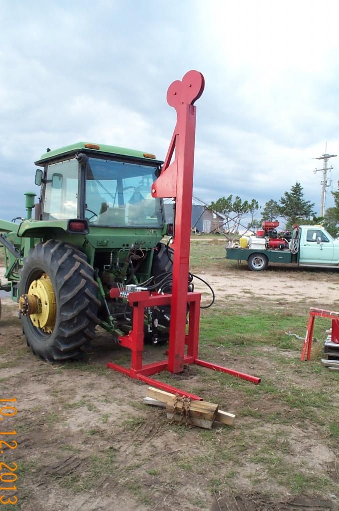

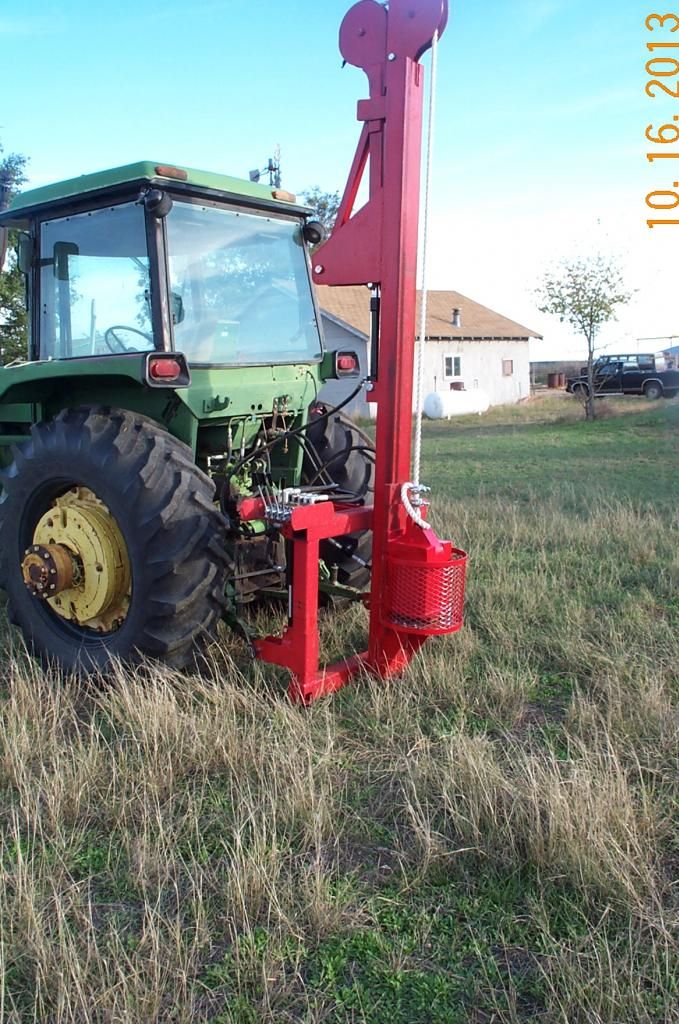

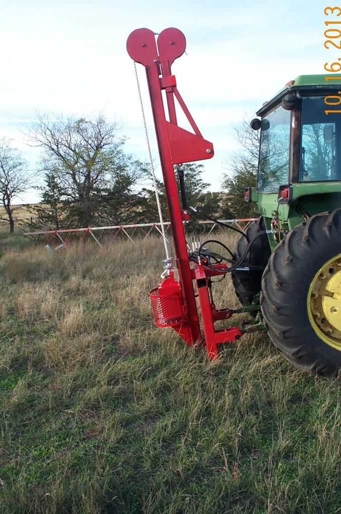

Completed driver
extended boom
tilt away from tractor,
tilt towards tractor
ready to drive
weight up
weight dropped,

I used through bolt stacked valves, (so if I need to add to it I could, and I did, only losing a bolt kit, in the change,

the weight is about 350 pounds, at one time it was a ripper shank for a old Cat dozer,
I made the cage around the post follower, to help keep ones hand off the impact area, I could see a absent minded moment or if two persons were working, how an accident, cold happen, thus the guard, on the follower.

and third was, the extension cylinder, I bought from surplus center, Diameter and length, (the size of tube it would fit into, and how much extension I could get and then how to make it work, from the height of the weight. and post follower gave me the length of weigh drop I cold get, then the arm to raise the weight was designed, then how much room did I have to make the arm work, the length of cylinder was chosen,
I was happy to find the cylinder I did for the extension, as it had a bottom poet and was mounted near the top, so the mast I made a plate that would let the cylinder go through and a top push plate, and welded the cylinder mount to the mast and then a extension, so if it bottomed out it would not leave the weight on the cylinder, and since that was all enclosed, it should be well protected,
on the extension it self it rides on the mast,
and the weight system is operated by a cylinder, single action, it dumps the oil out to drop, not really much more to tell, if you have any questions I will try to answer,
   / building a wood post driver tractor mounted page 2
one more addition I made what some call a "rock spike" I took a 2.5" steel square tube and took a 2" shaft and made a solid point on the end and then slipped another short tube over the top and doubled up the impact area,
do to the drouth we have been having the soil is very tight and hard, and in some area I do have lime rock under the surface,
I have driven close to 100 posts with it, so far, in soft and hard ground, I like the pointed driving posts, but many of the bundle I got were not very centered and it can walk a post off of center, and leave a post leaning a bit even tho it was all plumbed up to start with,
The only real problem was with the guard, and the jolting of the hammer bent up the brackets and it had to be removed, I have another plan for a guard, or at least a deterrent to place body parts in harms way, basically some bolt on fingers on the follower.
one thing I think would be nice, would be a side to side adjustment even just a few inches, to each side,
when putting in a fence and your trying to keep the post line straight, even a inch or two off does not look very good, and when you have 4.5" tube even if you have a mark it is hidden and it just works better in my opinion, to have it centered.
Highly recommended is some hearing protection,
even when neededing to drive the Rock spike, (the equivalent of driving two posts), I was averaging 10 post in two hours, completely set, and including travel time about 3/4 a mile at about 4 mph, rough ground and had the posts on the loader forks, (both out and in).

I think I am telling you correctly, the main beam/tube is ten feet, the drop is about eight foot, max, and one need to watch and lower the top tube unless one wants to shear the bottom stop off,
but there is second tube inside, with a hydraulic cylinder, that can raise it about 60 inches, my idea and it works was to increases the drop distance and or if you had some taller than posts or some thing special,
the only thing to help is grease, and not a lot of it, and I used a plate on the tube and just made guide on the sane line on a log splitter, ram work on,
what I recall is the arm is about 4 foot, and the L shaped arm is I think 1 foot, and the cylinder. about 12 " stroke, single acting, the rope doubles the lift, welded on a larger fitting on the cylinder it was 1/4" and use a 1/2 so I would not neck it down any more, and it dumps fine and the weigh is near free fall,
the weight is about 350 pounds, the cylinder is a snow plow cylinder, but it is all most to small in lift, another 25 pounds and it would not have lifted it. it does fine tho,
