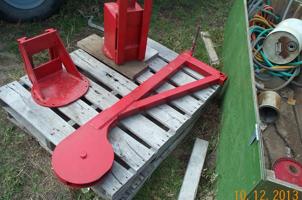

No what I could not understand was the cable puller, But after looking and looking at your picture a light came on :) and correct me if I am wrong on your beam you have 2 "Pulleys" at the very top of the mass and from what I gather now, one of these pulleys is on a scissor, so this is how the weigh is brought up,
so you bring the mast to the correct height, with one cylinder. the one inside the mast, that's easy "telescopic" then you open the scissor, with another cylinder, and this pulls the cable and weight, and this is the cylinder that you release to drop the weight.
this triangular pivot is the way the cable is pulled, right? OK how do you stop the scissor from hitting - banging on the mast, did you simply adjust it so just before it its the mast it's at the end of the cylinder travel. cylinder bottoms out. and my next question How did you figure out how long to make the scissor so the cable would be pulled all the way up.
and it's just a nylon cable not a steel cable? thank you I to is the same as you" my normal design process, is to see what is out there, look at pictures and videos, see what features I think I need and what makes it work " I was not very good in school but If I see it I can build it, That's why I became an auto body technician.

Yes that is how he system works, the hydraulic cylinder, about 12" travel, the "A" arm is about 42" long and when extended it will double the pull on the nylon rope pulling up weight, the rope I used is a 1" diameter rope, I think a 3/4" rope would work fine as well.
actually I did not let the cylinders bottom out, I let the "A frame" hit a steel pad, first, and the cylinder is about 1/4" from bottoming out, normally the weight hits the post follower and the energy is dissipated and there is not a hard hit, as the pull is no longer the oil in the cylinder acts as some like a shock absorber, (yes there is some resistance in the cylinder) but the dropping of the weight will fall and drop very fast, it is hitting hard enough one wants ear protection and keep all body parts away,
