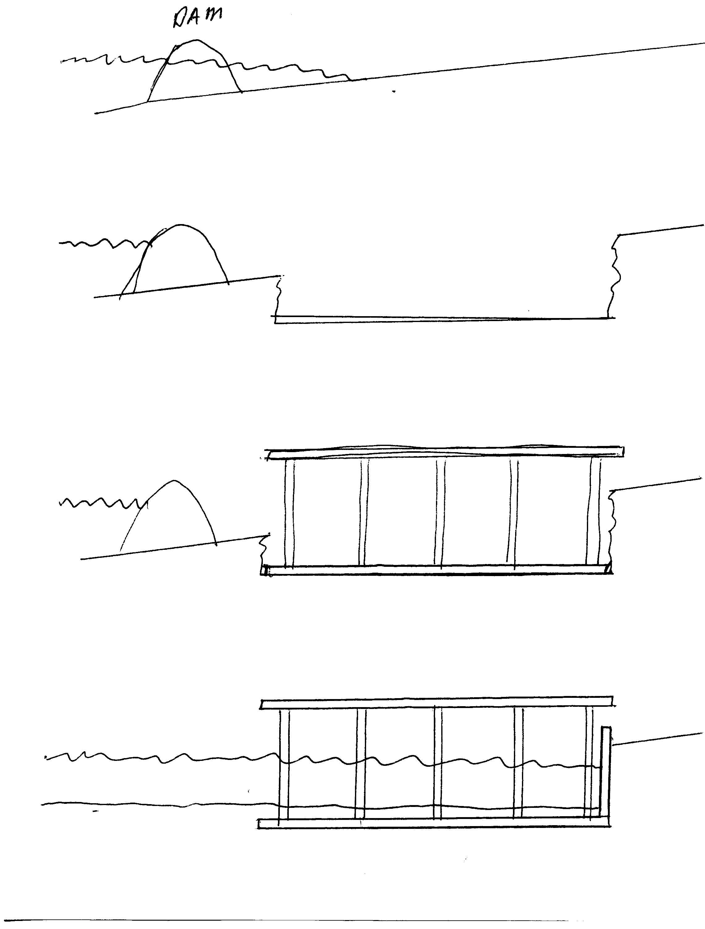

I have an out of the box solution that I think satisfies all your customers needs and wants and makes it a project that takes advantage of all your experience and skills.
You have experience in building dams, pumping water, and excavating, pouring cement just not under water.
What I propose is to build a temporary dam out into the water to expose the building site and allow it to dry out then to excavate down (you’ll need engineering calculations for per sqft req.) as needed and pour a large solid slab which is essentially one large cookie to support all your concrete columns. I would want a few walls for sheer. Then on top of the columns and walls the rest is standard construction.
After your support structure is built you excavate to remove the dam and to dredge the area to the depth desired.
See sketch

   / Building advice for the Ultimate Boat House. #39
hitekcountry said:
IWhat I propose is to build a temporary dam out into the water to expose the building site and allow it to dry out then to excavate down (you’ll need engineering calculations for per sqft req.) as needed and pour a large solid slab which is essentially one large cookie to support all your concrete columns. I would want a few walls for sheer. Then on top of the columns and walls the rest is standard construction.
See sketch
Yeah, as soon as I read that Eddie's client would not have cost limitations, I thought a cofferdam might be a great solution and allow building anyway you'd want. The problem is building a cofferdam in place or hauling it in. Of course, I'm just brainstorming...
