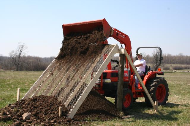

Here is my version of a soil screen. I am using 1-1/2" heavy duty chain link fence. I have screened at least 200 yrds of soil this year.
